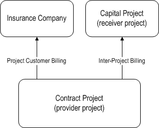

Business Needs Example 1
During an auto accident, a telephone pole owned by the local telephone company is knocked down. A contract project is set up to track the cost of the repair. These costs will be billed to an insurance company. While the repair is under way, the telephone company decides to replace the old transformer at the top of the downed pole. These costs will need to be capitalized and will be billed internally to a capital project. The contract project will bill the insurance company for repair work performed on the pole, and, using inter-project billing, will bill a receiver project for work performed on the transformer. The receiver project can exist at any organization level in the enterprise, regardless of operating unit or ledger.

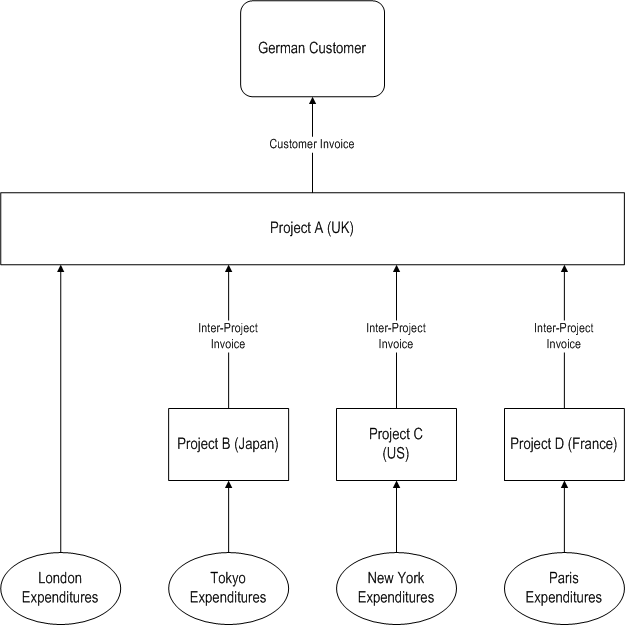

Company ABC is an advertising company with a multiple organization structure. The London operating unit, ABC's headquarters, received a contract from a German customer. The customer wants ABC to produce and air live shows in Paris, New York, and Tokyo to launch its new line of high-end women's apparel. ABC will plan and design the show using resources from the London operating unit. The Paris, New York, and Tokyo operating units are each responsible for the successful execution of these live shows with their local resources.
Using the structure shown above, the customer project is divided into several related contract projects. The London operating unit owns the primary customer project, or receiver project, and bills the external customer. The related projects, or provider projects, are subcontracted to their respective internal organizations and internally bill the London organization to recover their project costs.

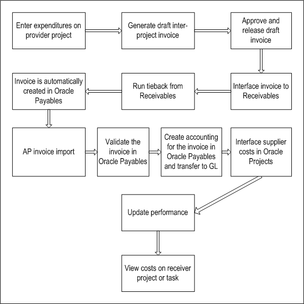

The inter-project billing processing flow consists of the following steps:
Enter transactions and distribute costs on your provider project.
Generate a draft inter-project invoice by running the Generate Draft Invoice process. See: Generate Draft Invoices, Oracle Projects Fundamentals.
Approve and release the draft inter-project invoice.
Review, approve, and release the draft inter-project invoice using the standard functionality of Oracle Project Billing.
Interface the draft inter-project invoice to Oracle Receivables.
Interface the draft inter-project invoice to Oracle Payables.
Interface the draft inter-project invoice to Oracle Projects.
