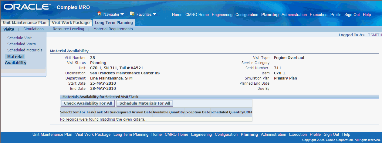

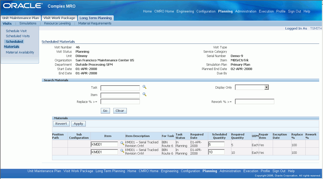

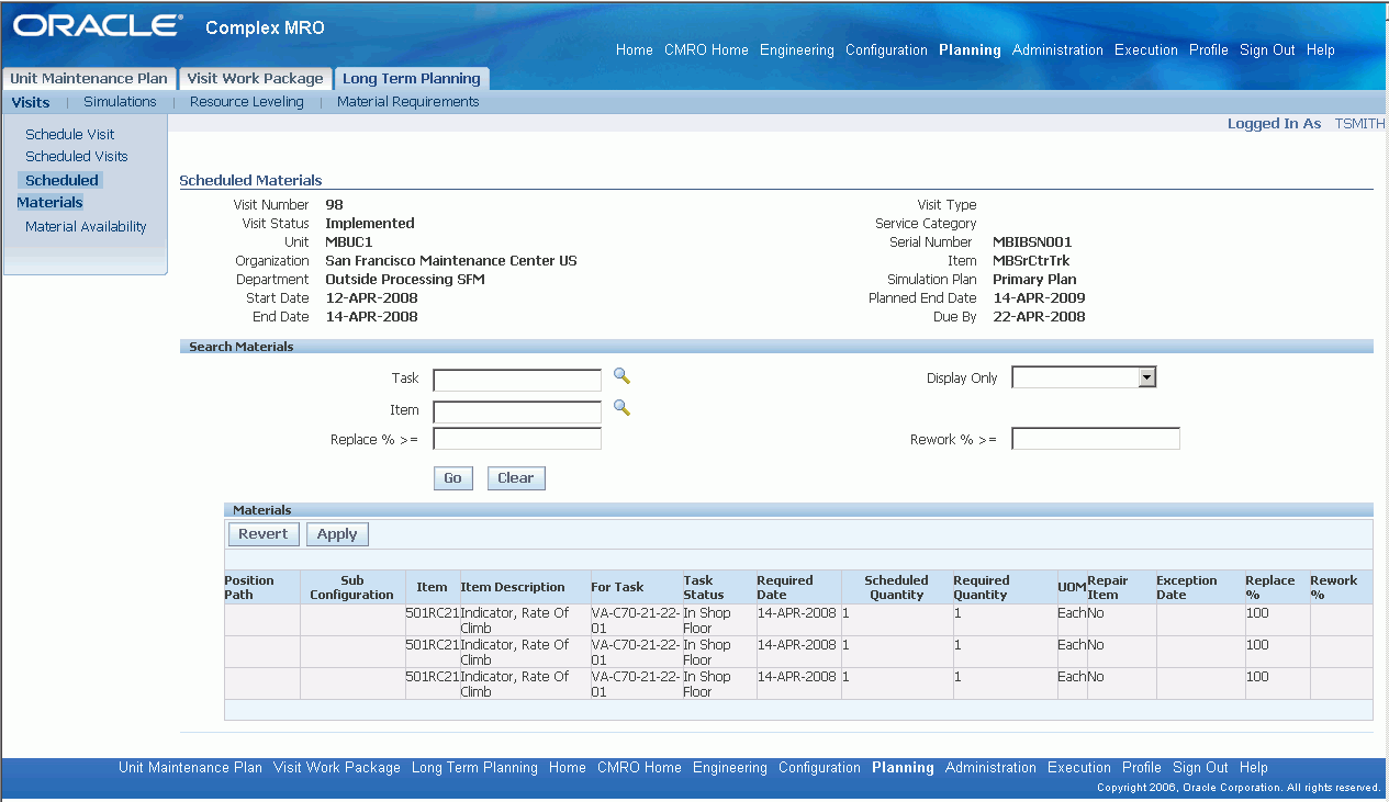

Schedule Required Materials
After a visit has been created and scheduled to a capable maintenance facility, the associated material requirements are factored into the supply chain plan through Oracle's Advanced Supply Chain Planning application. The visit's required materials, defined through the routes associated to each task, are scheduled based on the start date and time of each task for the applicable organization. LTP provides the planner, functionality to identify any schedule conflicts, when the required materials will not be available by the start date of the applicable visit task. Alternate items for these requirements may be selected and scheduled, or the planner may make scheduling changes to ensure that the materials will be available by the start of the associated work order.

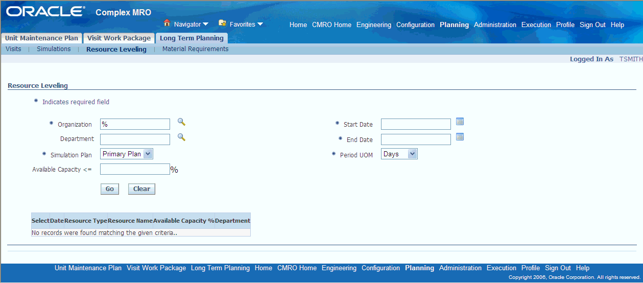

Capacity Versus Work Load Requirements
You can compare resource capacity versus resources required for the projected workload, which is an essential tool for accurate scheduling and planning and ensures that available resources are used as efficiently as possible. This is accomplished through the Resource Leveling feature of Long Term Plan. To derive the optimal schedule, you must have the ability to adjust visit schedules, change maintenance locations, and remove and add visit requirements.

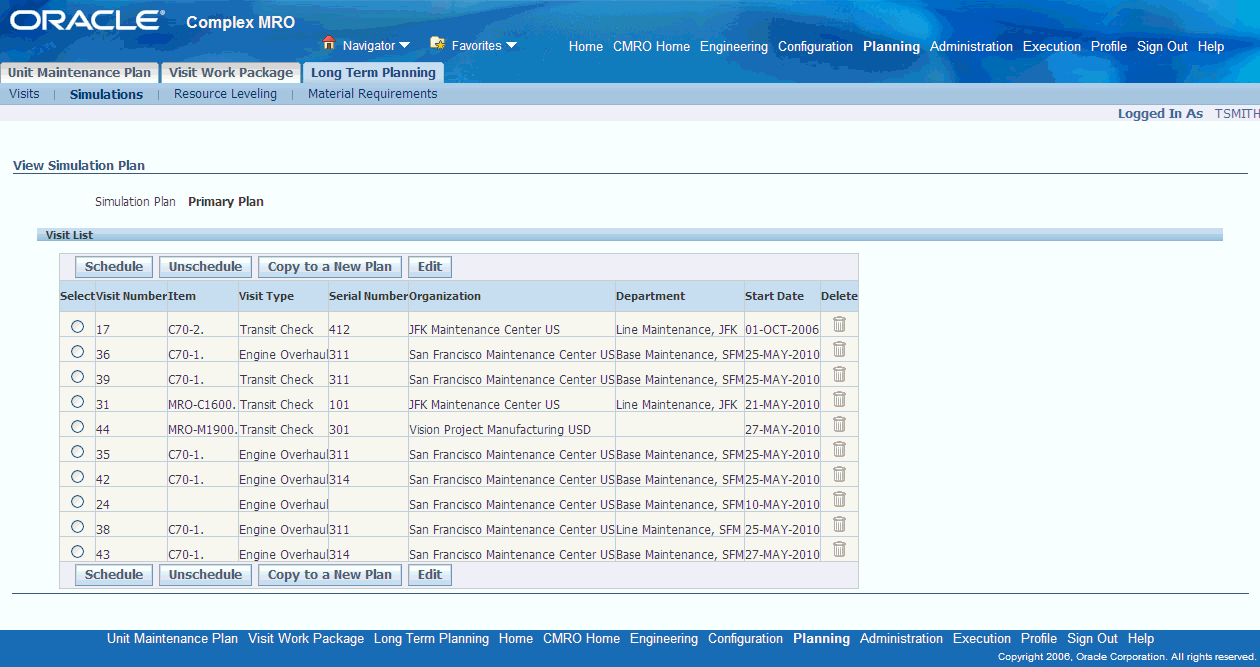

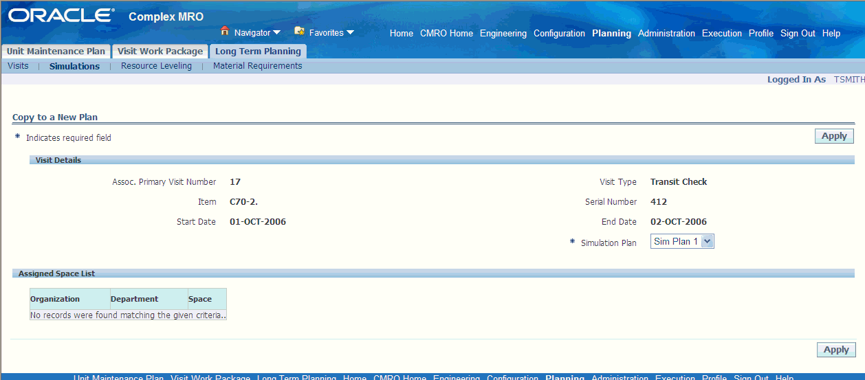

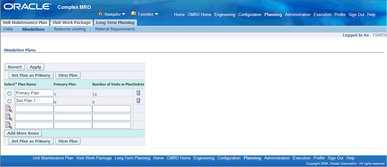

Simulations
The simulation function works in conjunction with both the scheduling and resource leveling functions of Long Term Plan. This allows the user to test different scheduling scenarios without changing the original visits. Visits can be copied into a simulation plan and their schedule or structure changed. After evaluating these visits, and taking into account schedule and resource consumption, the changes can be implemented for the entire simulation plan, or for individual visits within the plan.

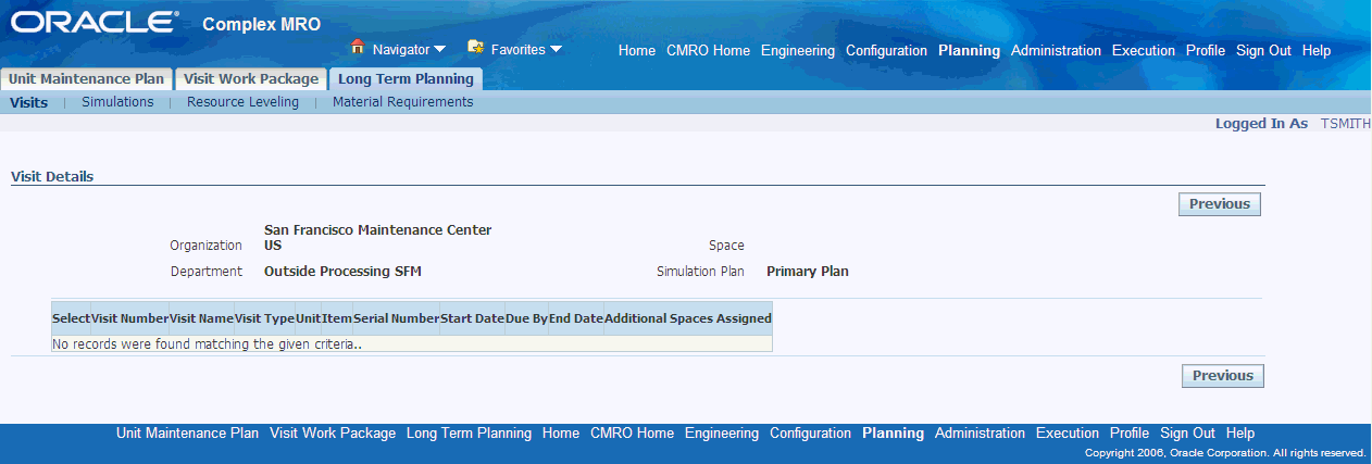

The Search Visit page provides the ability to search and display all maintenance visits regardless of their status.
To find a visit
Navigate to the Long Term Planning page from Oracle Complex Maintenance, Repair, and Overhaul's home page. Click the Visits link to display the Search Visits page.
You can view all primary visits, scheduled and unscheduled. All visits that need to be associated to an item (model) or serial number, all visits of a certain visit type, all visits due during a defined period, or all visits associated to an organization and department.
Select values in the applicable fields and select Go to display the results of your search.

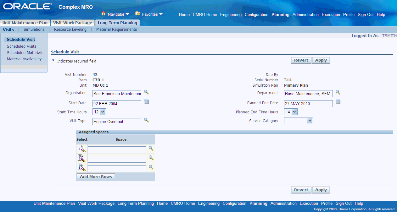

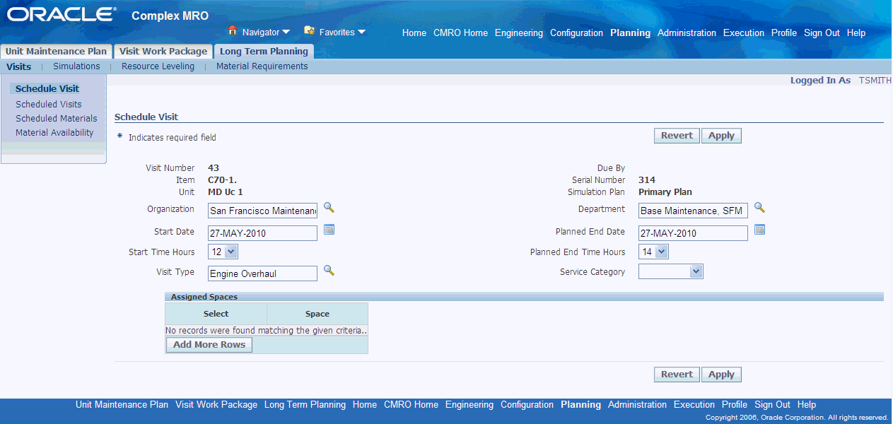

To schedule a visit
Click Schedule Visit to navigate to the Schedule Visit page.
Select the visit you want to schedule, then select Plan Visit button.
Select information in the following fields.
This page enables you to assign a visit to an organization and department. You also must define its start date. All three of these attributes must be assigned and define a visit as scheduled. After a visit has been scheduled, spaces can be assigned and Long Term Planning’s resource leveling functionality can be used. You can also reschedule a visit from this page if it is in planning status.
Visit Number: All maintenance visits are assigned a unique visit number. All visit numbers for all visits that have been created are available for selection.
Duration: the total length of the visit in days. It is the sum total of the durations of the associated visit tasks. Maintenance visits can be any length, from an hour to an unlimited number of days.
Visit Type: this enables maintenance to be classified into categories. Some of the larger visits, like a D-Check, will often include many different maintenance requirements, but can still be grouped together under once visit type.
Due By: The due date of a visit is defined by the associated maintenance requirements from Unit Maintenance Plan. The maintenance requirements are associated to the visit's tasks.
Item: All visits must be associated with an item.
Unit: serial number of a specific item.
Simulation Plan: Identifies the visit by simulation plan the visit or if it is a visit in the primary plan. When coming from the Search Visits screen, the visit will always be part of the Primary Plan. When coming from the View Simulation Plan screen, the value is defined by the plan in context.
Organization
Department
Start Date
Planned End Date
Planned End Time
Service Category
You can also adjust the planned end date for a visit with conflicting planned and derived end dates.

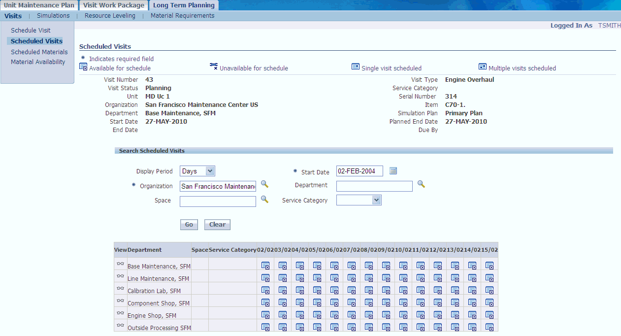

You can schedule and reschedule a visit while viewing current visit details in the Scheduled Visits page. You can search for availability periods using the following search criteria:
Select Apply to save your work.
To schedule and reschedule visits
Navigate to the Scheduled Visits page to view details for a currently scheduled visit number.
In the Search Scheduled Visits region, enter information in the applicable fields and select Go. The schedule details appear in the Scheduled Visits results table.
Select the intersecting icon, between the start date and corresponding department or space, to schedule the visit to the applicable organization, department and space. The Schedule Visit page appears.
Enter the schedule details, and select Apply to save your work.
To reschedule a visit, select the icon for the visit in the results table. Make the necessary changes, and click Apply.
Optionally, assign Spaces. See: Assigning Spaces to a Visit. The Space information is carried over to the Schedule Visit page for assignment.
To view the visit details assigned to a department or space, select the View icon for the applicable row in the results table. The View Details page displays the department and all scheduled visits starting during the previously defined period.
The Additional Spaces Assigned column indicates whether or not additional spaces are assigned to the visits.
To return to the Scheduled Visits page, select the visit and Schedule.

Long Term Plan uses spaces to assign locations to the maintenance work required during a visit. One or more spaces may be assigned to a visit.
Prerequisites
To assign spaces to a visit
Retrieve the visit you want to assign a space in the Schedule Visit page, and select Plan Visit.
The Schedule Visit page appears. The Assigned Spaces information is displayed in the lower half of the page.
Select Add More Rows, and add information in the provided fields. Select a value in the Space field.

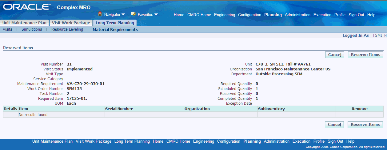

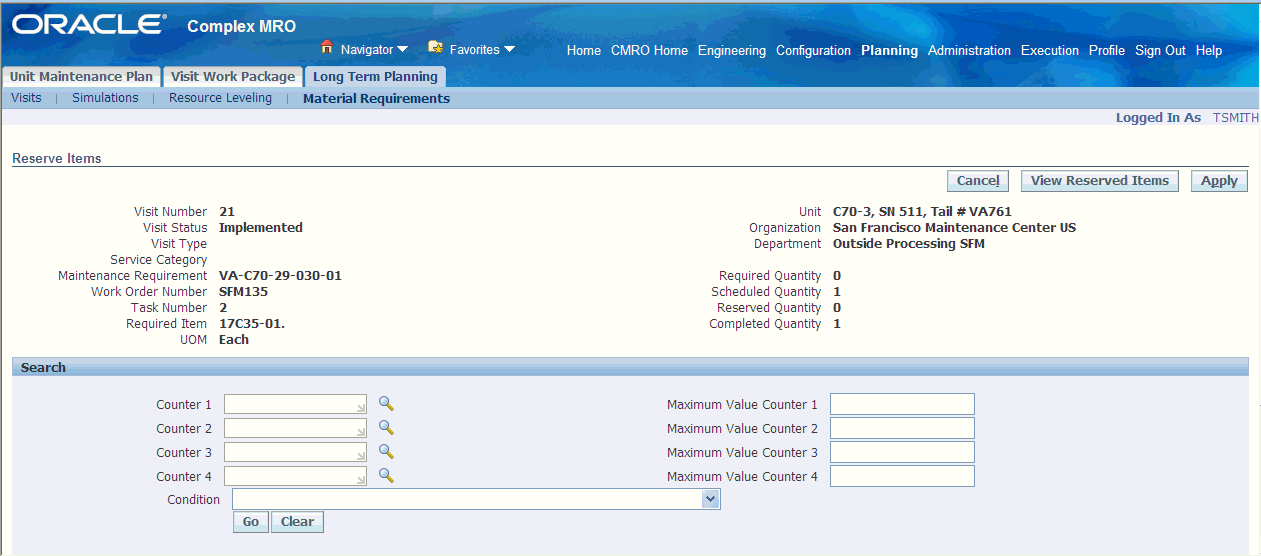

Oracle CMRO's integration with Oracle Advanced Planning and Scheduling (APS) provides comprehensive material planning, scheduling and rescheduling capabilities. Planners have complete visibility into forecasted, planned, and unplanned material requirements. You can plan materials well in advance to accommodate fluctuations in demand and supply for both planned and unplanned material requirements. You can also maintain optimum stock to meet specific service levels under the defined inventory budget constraints. The APS integration includes the following:

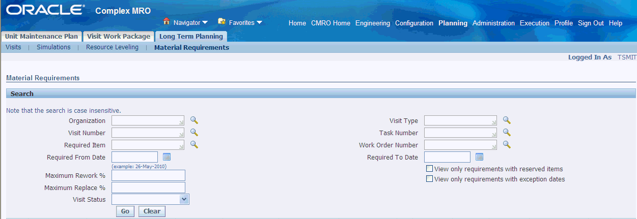

Material Demand Planning - Material demand arises out of the planned maintenance requirements forecasted by Unit Maintenance Plan (UMP), defining when they must be accomplished. This forecast is based on the utilization of the applicable units. The material demand for all planned maintenance requirements in UMP is automatically stored every time the utilization forecast is updated or the “build unit effectivities” process is run. The replace and rework percentages defined in the disposition lists and the material requirements defined for the routes are factors influencing material demand. Material demand associated to unplanned, non-routine maintenance requirements is discovered during the production phase. Additionally, unplanned demand can be predicted based on the historical demand for each organization. This unplanned demand can be refined based on the historical relationship between the planned maintenance requirements, associated units and the unplanned material requirements.
Demand Planning collects these material requirements, factors them into the global demand, and feeds the global demand to Inventory planning and supply chain planning. The forecast/demand variability along with the supply variability (like supplier capacity and lead-times) is then used to specify time phased safety stock recommendations for the supply chain.
Supply Chain Planning - After the planned maintenance requirements have been associated with a visit work package and scheduled to capable maintenance facilities, the required materials are scheduled through Oracle Advanced Supply Chain Planning. The Planning engine will first net existing supplies, and then generate planned orders to procure the required materials.
The three primary material streams into the APS engine are global material demand from forecasted maintenance requirements, scheduled maintenance requirements and historical non-routine material requirements. Demand Planning factors the required materials into global material demand; and pushes it into Inventory Planning where the supply and demand variability is considered to compute safety stocks at all locations. Demand plans created in the process, provide visibility into the upcoming material requirements long before the applicable maintenance is scheduled to a facility.

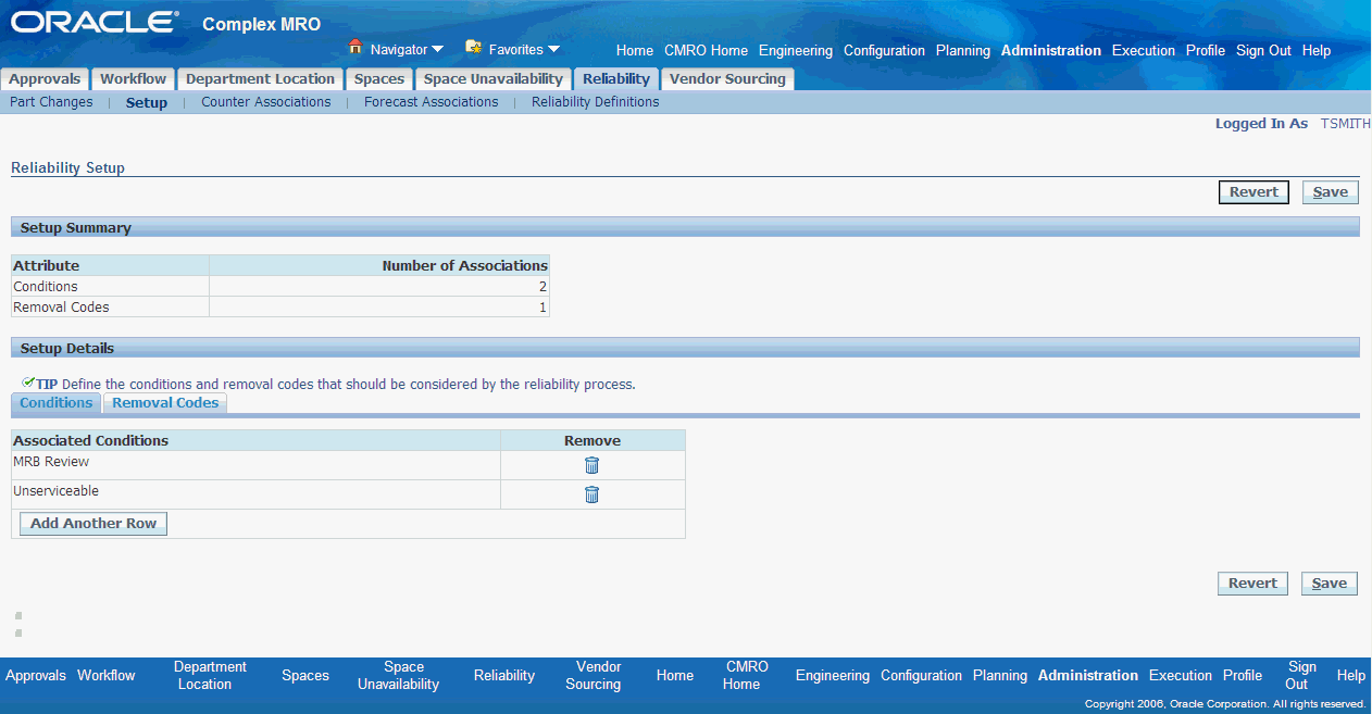

To view and define conditions and removal codes for reliability planning
Navigate to the Reliability Setup page.
The Setup Summary region displays Conditions and Removal Codes, and the number of records associated with each attribute.
The Setup Details region is used to add or delete Condition and Removal Code records.
In the Setup Details region, select the Conditions tab to view the conditions set for reliability analysis.
To add a record, select Add Another Row and choose the List of Value icon to display the Search and Select page.
Select a value and choose Select to refresh the Reliability Setup page with the new record.
Select the Removal Codes tab to view the codes enabling removal of the condition in the reliability analysis.
Save your work.

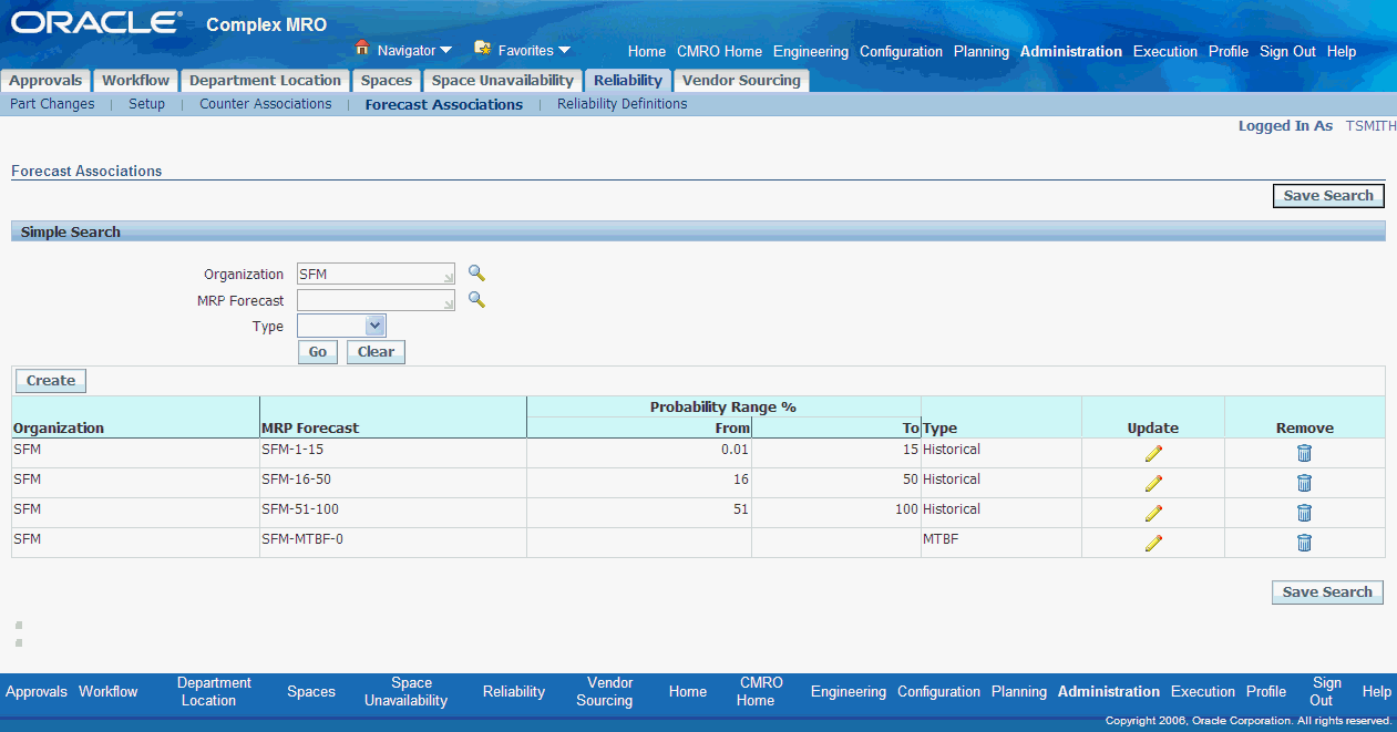

To view planning forecasts associated with probability rates
Navigate to the Forecast Associations page.
In the Search Region, you can search for forecasts associated with predicted failure rates using filter criteria in the following fields:
Organization
MRP Forecast
Type:
Historical—uses historical data for calculation
MTBF—Mean Time Between Failure, uses a manual figure for calculation
Select Go to display the results of your search.

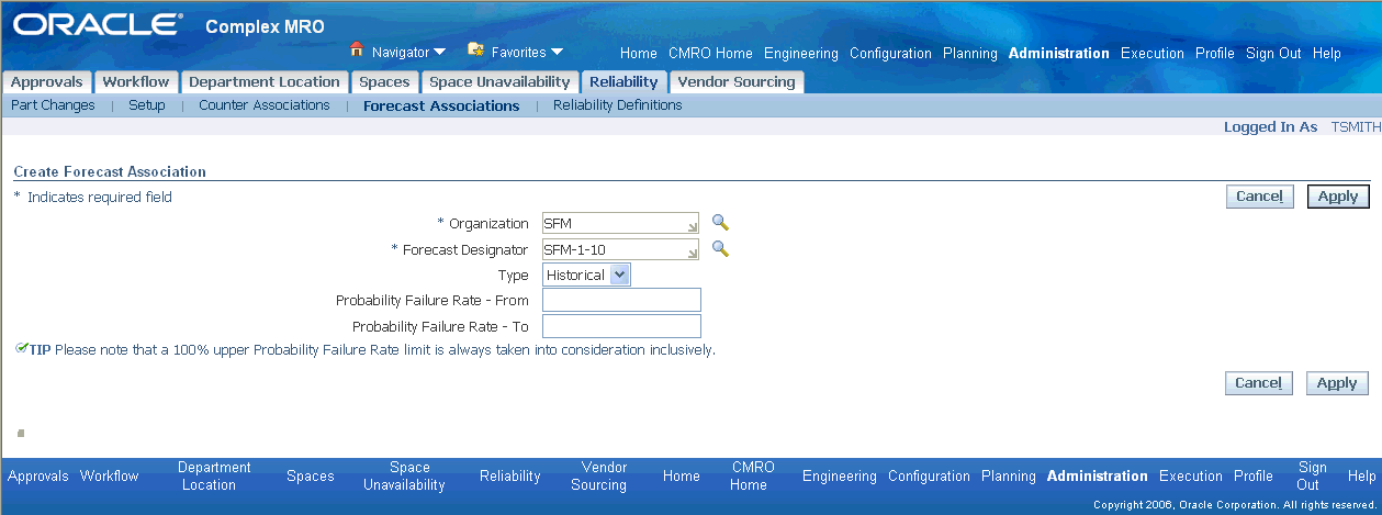

To associate forecasts with reliability data
Navigate to the Forecast Associations page, and choose Create to display the Create Forecast Associations page.
Select values in the Organization and Forecast Designator fields.
The forecast designator is the planning forecast name.
Select a reliability planning type to be used for the calculation. Choices are:
Historical—calculation of anticipated failure of components using historical information.
MTBF—Mean Time Between Failure, this is a manual calculation of predicted failure of components.
Enter a percentage value in the Probability Failure Rate From and To fields.
These fields are used to determine which forecast is used to populate a material requirement. Reliability planning calculates the average life of an item, and predicts the probability of failure as the larger unit arrives at each service station. The requirements are added to the applicable forecast, identified by these two fields.

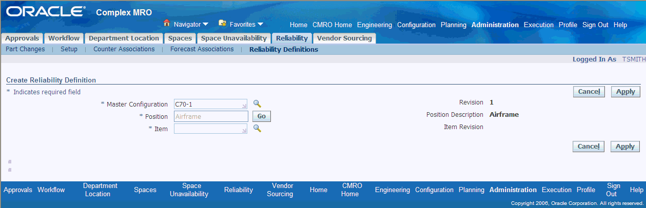

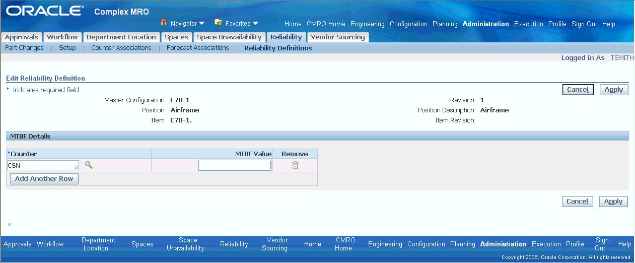

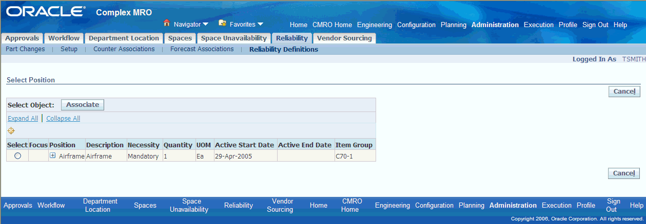

Some failure rates are manually defined when an item is new and has no historical data attached it. Once you have historical data, you can delete this information. For the MTBF flow, you define known average failure rates for items in a specific position within a configuration.
To view or define manual reliability definitions
Navigate to the Reliability Definitions page.
You can search for Master Configuration details in the Search region by selecting search criteria, and selecting Go.
You can searching using the following values:
Position
Revision
Item Number
The results of your search display in the Master Configuration Details region.
For records that have accumulated historical data, and no longer need to be manually defined, select Remove to delete this record.
Choose Create to display the Create Reliability Definition page for specifying new definitions.
Select a value in the Master Configuration field.
In the Position field, select Go to display the Select Position page. This page lists available positions. See: Select Position Page
Select a Position and choose Associate to add this record to the reliability definition.
The Edit Reliability Definition page appears.
In the MTBF Details region, choose Add Another Row to enter counter and MTBF definitions.
Select the List of Values icon to display the Search and Select Counter page, and select a counter value.
Enter a value in the MTBF field.
This is the average failure rate for the item in this specific position, within a configuration.

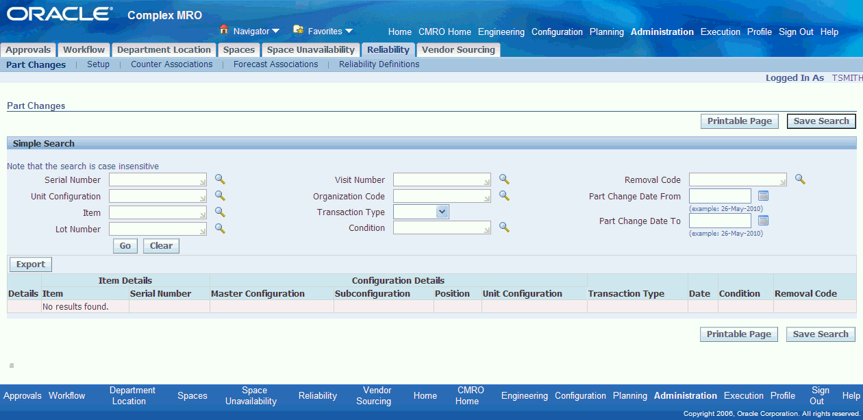

Part change transactions can be viewed and used in planning calculations. A summary of the part change transactions is displayed in the summary region of the Part Changes page. This information can be exported to other reporting programs.
To view historic part changes
Navigate to the Part Changes page.
To find your appropriate records, select search criteria In the Search region. You can select information in the following fields:
Serial Number
Unit Configuration
Item
Lot Number
Visit Number
Organization Code
Transaction Type
The page displays information for each item in several regions: Item Details, Configuration Details, and Visit Details.
You can review the information for the following values: serial number, lot number, master configuration, subconfiguration, position, unit configuration, transaction type, date, visit number and name, workorder, organization, condition, and removal code.
Select Export to move these results to another document program.

Oracle Complex Maintenance, Repair, and Overhaul Long Term Plan provides the ability to check the material schedule in order to assess available material resources. When a visit is planned, materials are automatically scheduled. The scheduled materials show up in the Scheduled Materials page. ASCP collections run on a regular basis to collect the requirements and provides exception dates if the material will not be available by the required date. When a conflict exists between a maintenance visit and the associated material schedule, the planner can select alternate items or reschedule the applicable visit, tasks within a visit, or maintenance requirement.
Prerequisites
To check the material schedule
Navigate to the Schedule Visit page, and select Scheduled Materials.
The Scheduled Materials page appears displaying information about the materials scheduled for the visit. The scheduled date and quantity is displayed for each scheduled material requirement. The Item Description column enables the planner to identify the correct material requirement when item number is not enough. ASCP collection, that is set up to run on a regular basis, collects the requirements and provides any exception dates when the material will not be available by the required date.
Items defined with a 100% replacement percentage in the associated disposition list are automatically planned and scheduled by ASCP. Items defined as material requirements in Route Management are assumed to be 100 % replacement items. Planners must manually specify the quantity to be scheduled for non 100 % replacement items. Only items that are scheduled will flow into work orders as material requirements.
To manually check for exception dates when collections have not run, select Schedule Conflicts from the Display Only drop-down menu. Select Go.
The exception dates are displayed in the Materials table.
Optionally, you can search for and plan materials using the following search criteria:
To search for material requirements for a specific task or item, select Task and Item.
To search for materials by disposition percentage, enter a value in the Replace % or Rework % fields.
These percentages indicate the likelihood of the materials being required when executing the task.
Select Go to display results matching the search criteria.
Select the Item icon to select an alternative item to replace the item that appears by default in the Materials list.
For a sub-configuration or position, the item that is installed is automatically selected to be planned. When no item is installed, the planning engine picks up the alternates defined based on priority.
Set the quantity to be scheduled.
Select Apply to save your work. Select Cancel to return to the previous page.

To check material availability
Navigate to the Schedule Visit page, and select Material Availability.
The Material Availability page appears.
If needed, you can use the filter to search material requirements by the department that is associated to the route/operation's associated task.
To schedule materials, based on current material supply against given organization, select the relevant material requirement, and click Schedule Materials.
The applicable requirements are passed through ATP and scheduled into the correct ASCP plan. Optionally, you can select Schedule Materials for All to schedule all the materials in the visit.
Note: This feature enables the maintenance planner to manually initiate the scheduling process, and determine conflicts if any, between the available quantities and the required quantities. This may be required for visits that have been recently scheduled or rescheduled, or when additional maintenance requirements have been associated with a visit.
To check availability for all the materials, click Check Availability For All.
Optionally, to check material availability for one material at a time, select an item, and click Check Availability. If the material will not be available by the required date, a warning is displayed.

To search for material requirement information
Navigate to the Material Requirements page.
You can search for records using the following fields:
Organization
Visit Number
Required Item
Required From and To Dates
Maximum Rework %
Maximum Replace %
Visit Status
Visit Type
Task Number
Work Order Number
You can also specify if you want filter your search for reservations and exception dates by flagging the following check boxes:
View only requirements with reservations
View only requirements with exception dates
Select Go to display the results of your search in the Select Material Requirement region.
The Material Requirement region provides a global view of all requirements. The Exception Date field enables you to easily identify material requirement shortages.
To view reserved items
Navigate to the Material Requirements page and select a record.
Select View Reserved Items to display the Reserved Items page.
The list of reserved items is displayed for each visit number. The visit number quantities are shown for required, scheduled, reserved, and completed. Reserved items are displayed in table rows by item, serial number, organization, and subinventory.
Select Reserve Items—either in the Material Requirements or Reserve Items page— to display the Reserve Items page.
In the Search region, you can query items to reserve by counter values and condition. Results of your query display in the details table rows.
Select the items you want to reserve, and choose Apply to save your work.

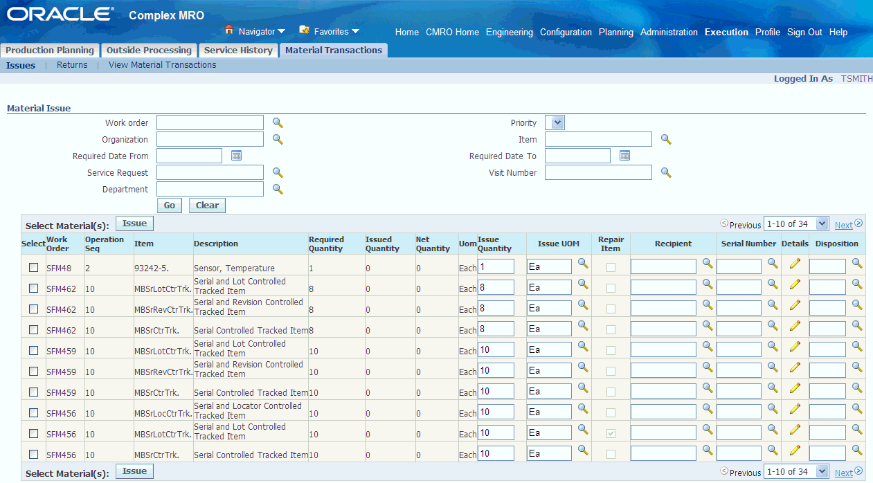

To issue reserved serialized items to applicable work orders
Navigate to the Material Issue page, and search for the work order to issue serialized items.
In the Select Material region select your work order record, and the details for the issue transaction including Issue Quantity, Recipient, Serial Number, and Disposition.
Select Issue to save your work.

To create a new simulation plan
Navigate to the Simulations Plan page.
Use the information in the following table to define a simulation plan.
| Field | Description |
| Plan Name | All visits are associated with a simulation plan. |
| Primary Plan | Indicates whether or not the plan is set as the primary plan. When visits are created in Visit Work Package, they are automatically included in the primary plan. Copies of these visits can then be added to other simulation plans. See: Setting a Simulation Plan as Primary |
| Number of Visits in Plan | Visits included in the specified plan. |
Select Add More Rows to enter information in the provided fields.
Select Delete to delete a simulation plan.
If the Simulation Plan is not the Primary Plan, it is deleted.

To add a visit to a simulation plan
Select the simulation plan you want to add a visit. Select View Plan to display the View Simulation Plan page . .
Select Add More Rows to add several rows to the table
Select values in the Visit Number and Item fields.
The item refers to a model name—such as Boeing 747-200B— that the visit is associated to. All visits must be associated to an item.
Select the type of maintenance visit is required. This enables maintenance to be classified into categories.
Select an applicable unit, this refers to the serial number of a specific item.
Select the applicable organization and department.
Select the Start Date, the date of the first day of effectivity of this operation.
To delete a record, select the record and choose the Delete icon.
To view simulation plans
All simulation plans are displayed, showing for each the number of visits in the plan, and if the plan is set to primary. Plan names may be changed, but must remain unique.
Select the plan and select View Plan. The View Simulation Plan page appears, displaying the visit list.

To copy a visit to a new simulation plan
Select a simulation plan to display the View Simulation Plan page.
Select button next to the visit you want to copy, and choose Copy to a New Plan button. The Copy to a New Plan page appears.
When a primary visit is copied to a simulation plan, the new visit inherits all the unit effectivity associated with the parent visit. You can view the applicable visit's due by date, derived from the associated unit effectivity.
Long Term Plan allows you to assess resources associated with the maintenance requirements of scheduled visits against the capacity of maintenance locations. Ideally, a certain percentage of maintenance capacity is kept free to allow for non routine maintenance needs. The resource leveling feature of Long Term Plan identifies shortcomings in your plan so that you can reschedule a visit or adjust it in Visit Work Package in order to better utilize available resources. Running resource leveling on different simulation plans allows you to identify the best plan with regards to resource capacity.
Resource leveling takes task level department assignments into consideration. Resource leveling procedure allows you to filter and display only those required resources that exceed a defined level of capacity.
Note: Resource leveling can display only those required resources that exceed a defined level of capacity. This means that the full set of procedures must now be run at the beginning of the process, as opposed to the previous function that drilled into each resource requirement before making these calculations. Enter a value in the Required Capacity field to set the reserve level.
The resource leveling procedure allows you to easily identify where a potential problem exists with regards to conflicts or shortages in available resources. When planning visits, a scheduler needs to be able to leave a certain percentage or resources available in anticipation of non-routine maintenance. If the planned requirements consume too much of these resources, the over plan must be changed by either rescheduling entire visits, tasks within a visit or maintenance requirements associated with a visit. Setting a reserve with the Required Capacity field resolves this need in Long Term Plan. A resource's unused capacity is defined by summing the required units, subtracting these from the total number of applicable people or machines defined for the applicable department, and dividing that by the number of available units. Available units are the total number of persons or machines minus those that are not available due to existing work order assignments.
Results in Resource Leveling can be filtered to display only those required resources that exceed a defined level of capacity.
Note: Resource leveling can only be done for one organization and simulation plan at a time and if all of the applicable resources and resource requirements have been setup correctly.
To run resource leveling
Navigate to the Resource Leveling page.
To search for resources, you can select values in the following fields:
Organization
Department
Start and End Dates
Simulation Plan
Required Capacity %
This field sets the percentage of capacity that you want to hold in reserve. All resources required for each period for all visits in the selected simulation plan are balanced against the total available resources.
Select your record and choose View Resources to display the Resource Availability page.
Select View Details to display the Resource Consumption Details page. Select the Visit or task column to edit the respective visit or task in Visit Work Package.
