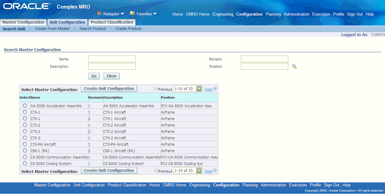

When searching for a master configuration record that will serve as the unit configuration template, you can search using the master configuration template name, or the hierarchical position reference where a master configuration is connected.
To find a master configuration record
  1. Navigate to the Search Master Configuration page.
  2. Select search criteria in the following fields: Name Description, Revision, or Position. Select Go to display the results of your search.
    the picture is described in the document text
    Configuration records matching the search criteria display.

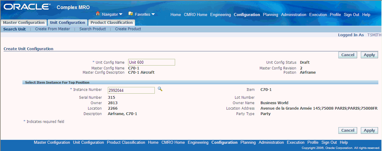

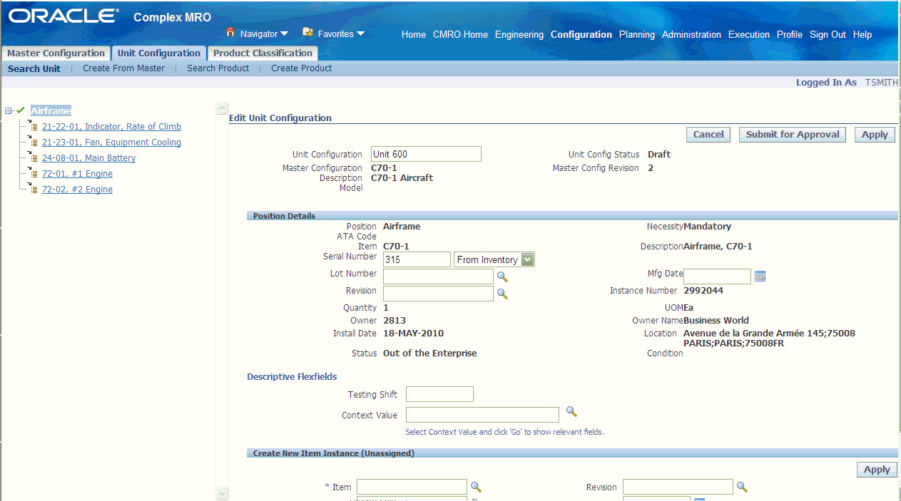

To create unit configuration
  1. Navigate to the Create Unit Configuration page.
    The details for the master configuration populate this page including name, description, status, revision, and position.
  2. Enter a value in the unit Config Name field.
  3. Select an Instance Number, this is the Install Base Instance Number of the tracked item.
  4. Select Apply to save your work.
    The page is populated with information for Description, Serial Number, Owner, Owner Name, Location, and Location Address of the fleet unit.
    The Edit Configuration page appears, displaying the position details and the item association for the top node of the unit configuration tree. You can now assign item instances to position references.

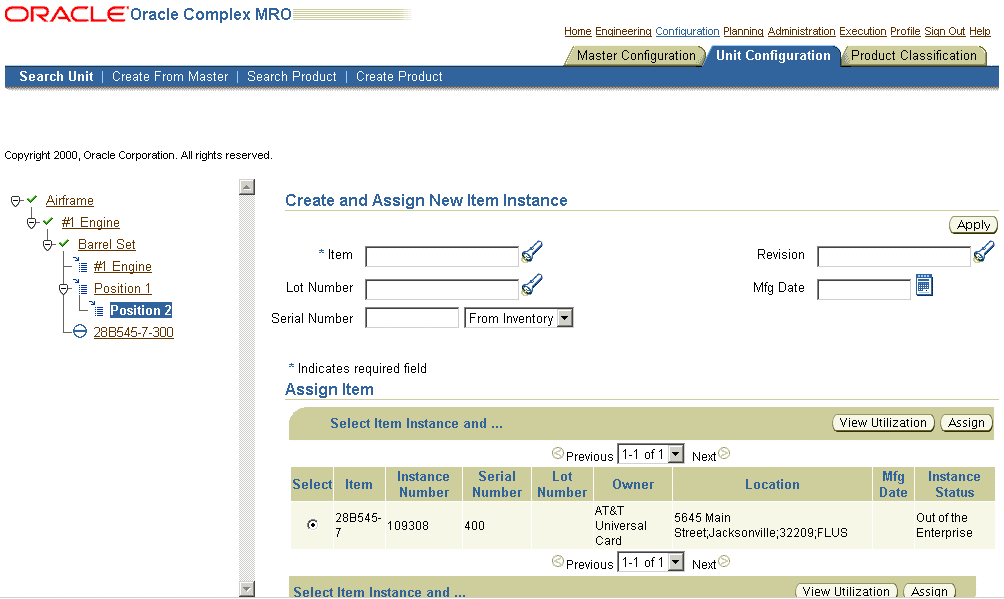

To assign items to a unit configuration position
  1. In the Edit Configuration page, select the position reference that you want to associate with the item.
    The Create and Assign New Item Instances page appears. This page has two regions:
  2. To create a new record, select the item in the Create and Assign New Item Instance region.
  3. Optionally, you can enter the following additional information for the item instance:
    A master configuration, on which the unit configuration is based, may have subconfigurations assigned to its position reference. In the unit configuration, you need to assign subunits based on that subconfiguration, to the position reference. The status of available subunits must be consistent with the status of the parent unit
  4. Select the subassembly, and choose Assign.
  5. You can also create subunits for the master configuration. Select Create from Master tab. See Creating Unit Configuration.
    Note: The sub-units must be in draft status to be assigned to the unit configuration.
  6. Save your work.
  7. To associate an existing item instance, select the item and choose Assign.

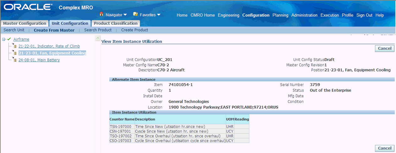

  8. To view utilization for an item instance, select View Utilization. The View item Instance Utilization page appears.
    Unit Configuration records the utilization of each component within an assembled hierarchy by monitoring current utilization of units and component hierarchies. Unit Configuration uses appropriate units of measurement including Time Since New, Time Since Overhaul, Time Since Repair, utilization cycles, Hobbs meter time, and many others. Unit Configuration also records utilization history of a revenue fleet unit, serialized part, or component hierarchy.
    Note: You can assign alternate items to unit configuration positions after viewing the utilization gained by each allowable part listed for a position.

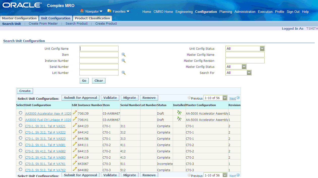

To find unit configuration records
  1. Navigate to the Search Unit Configuration page.
  2. You can search for records by selecting the applicable search criteria including:
  3. Select Go to display the results of your search.

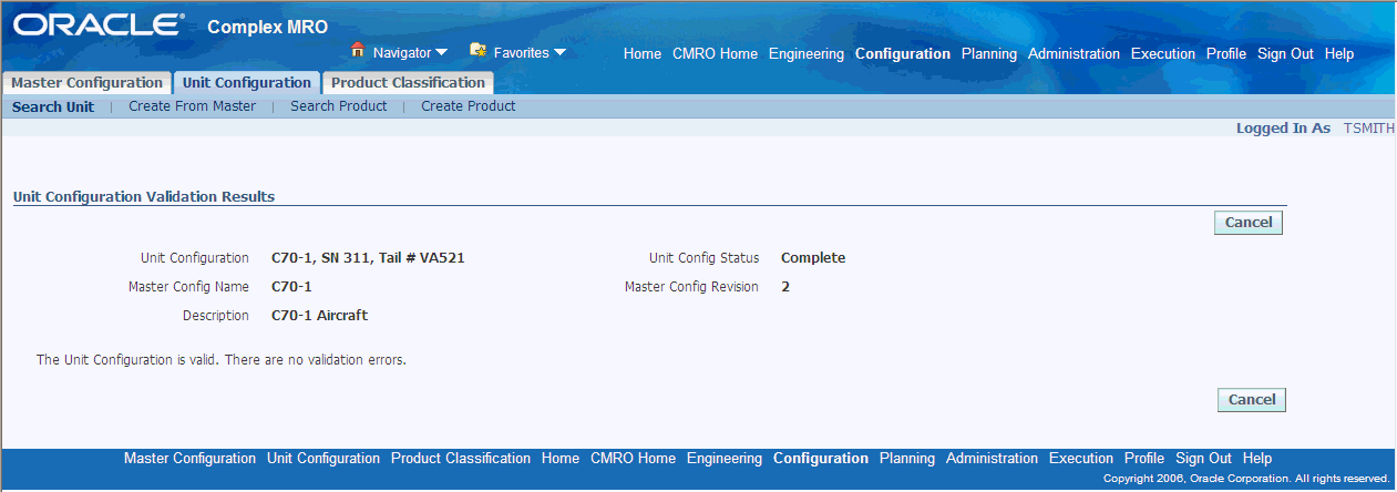

You can validate a unit against the master configuration structure, allowed items and sub-configurations, and the rule applicable to a configuration. You can independently validate the completeness of a unit. You can also validate a unit after migrating it to a new master configuration, or to a revision of an existing master configuration.
To validate a unit
  1. Navigate to the Search Unit Configuration page, and select your record.
  2. Select Validate.
    The Unit Configuration Validation Results page appears displaying the any errors for structure and rule violations.

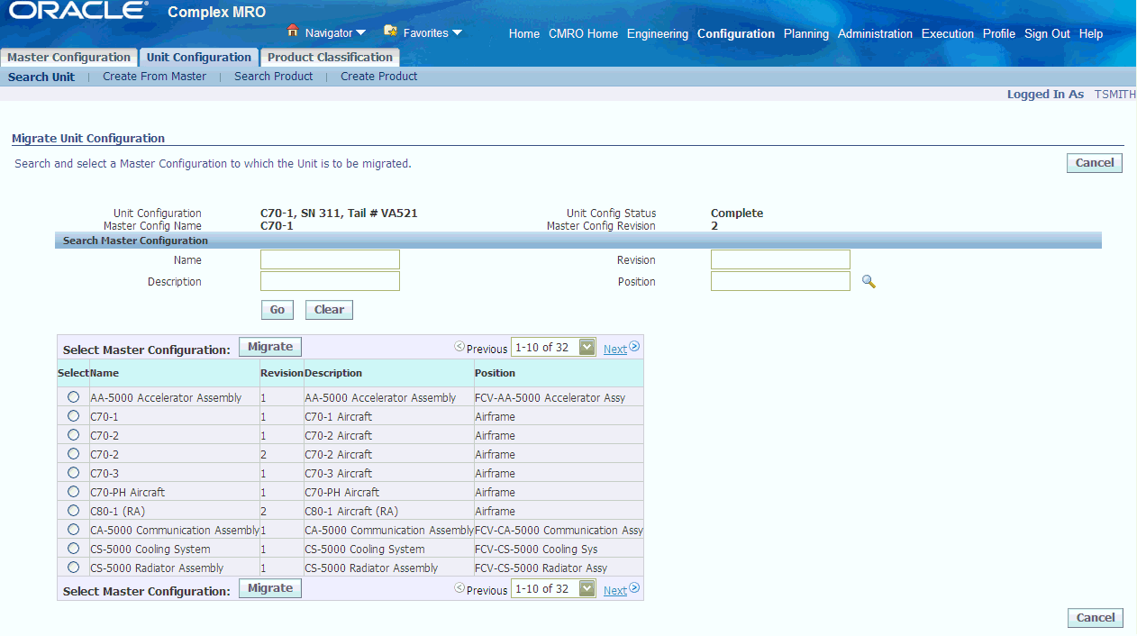

To migrate a unit configuration
  1. Select the unit configuration and navigate to the Migrate Unit Configuration page.
  2. In the Search Master Configuration region, search for you master configuration record by selecting criteria. Select Go to display the results of your search.
  3. You can search using Name, Description, Revision, and Position. The records matching your search criteria are displayed in the Master Configuration list.
  4. Select the relevant master configuration, and choose Migrate.
    The Edit Unit Configuration page appears, displaying the unit hierarchy and the position details for the top node.

Editing Unit Configuration Records
Maintenance organizations alter fleet unit configurations to suit different modes of operation, or to comply with changes in business rules. These alterations may also result from component replacements with allowable items at certain hierarchical positions.

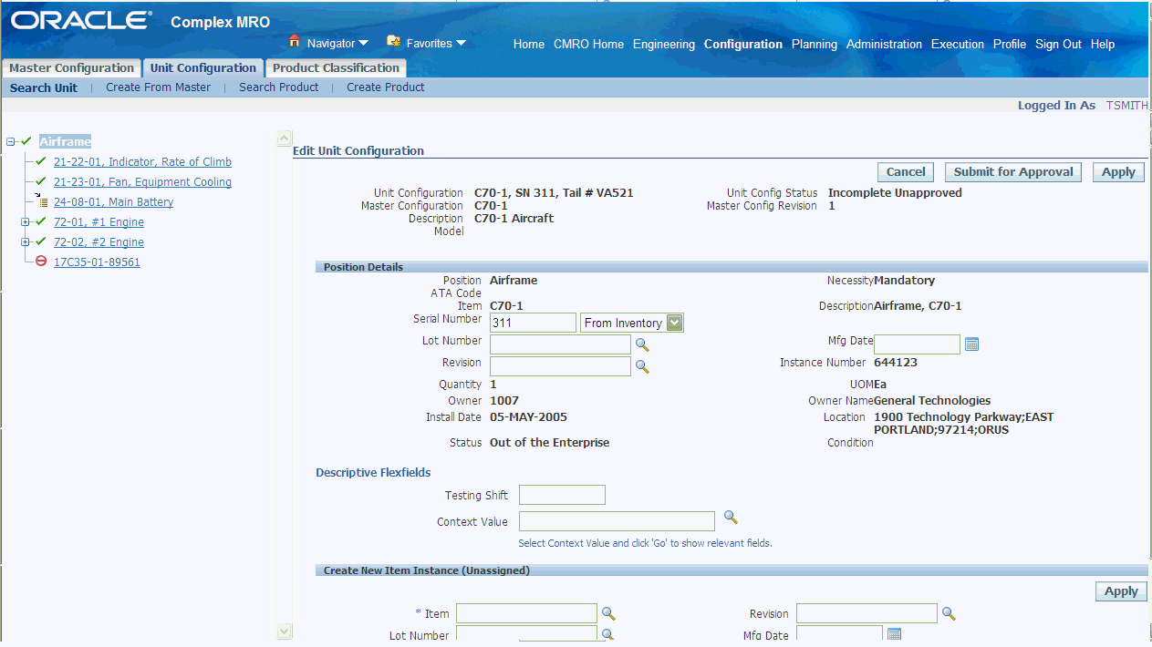

To edit unit configuration records
  1. Navigate to the Edit Unit Configuration page.
    Note: You cannot add or update position references in the unit configuration after changing the status to Complete.
    To edit a position in the unit configuration hierarchy, use the tree structure to display the position references.
  2. In the Position Details region, change applicable values.
  3. To remove a position reference from the unit configuration record, click on the position reference. Select Remove in the Position details region. You can reuse the item represented by the position reference that you remove from the unit configuration.
    Note: You cannot remove a position reference that is defined as Mandatory in the master configuration. The Edit Unit Configuration page presents this information in the Necessity field under Unit Configuration Structure.
  4. To unassociate an items position, without removing the nodes from the unit configuration tree, select the position reference and click Unassociate. This allows you to map the positions manually, when the correct installation cannot be automatically determined.
  5. To assign a part to a position in the unit configuration, select the pertinent position reference. If item instances for that position exist in the database, they will appear in the Assign Item table. Optionally, you can create and assign a new item instance. See Assigning Items to Unit Configuration Positions.
  6. Enigma Integration allows you to look up configuration information in Enigma’s 3C application and associate it to Oracle’s Master Configuration. With that association you can view the associated document content in Unit Configuration.
    The Enigma Documents region enables you to view the associated documents on the position and part based on the association in master configuration. The Enigma Documents region is displayed if the profile option, CMRO Enigma Integration URL, is set to Yes.
    The region displays buttons for viewing Wiring Diagram Manual (WDM) and Illustrated Parts Catalog (IPC) as applicable.
    Click the Illustrated Parts Catalog and Wiring Diagram Manual buttons to view the associated documents.
  7. Select Apply to save your work.

Viewing Alternate Items Utilization
You can assign alternate items to unit configuration positions after viewing the utilization gained by each allowable item listed for a position.
Prerequisites
To view alternate item utilization
  1. Retrieve the unit configuration record that you want to edit (see Finding Unit Configuration Records). Search results appear in the lower half of the page.
  2. To view the use of alternate items, select the pertinent record from the Unit Configuration List, and click the Edit icon corresponding to it. The Edit Unit Configuration page appears. Using the tree structure on the left, navigate to the node you want to edit.
  3. Select the position to which you want to assign alternate items. The alternate items will be displayed in the Assign Item table. To view item utilization, select the item and click View Utilization.

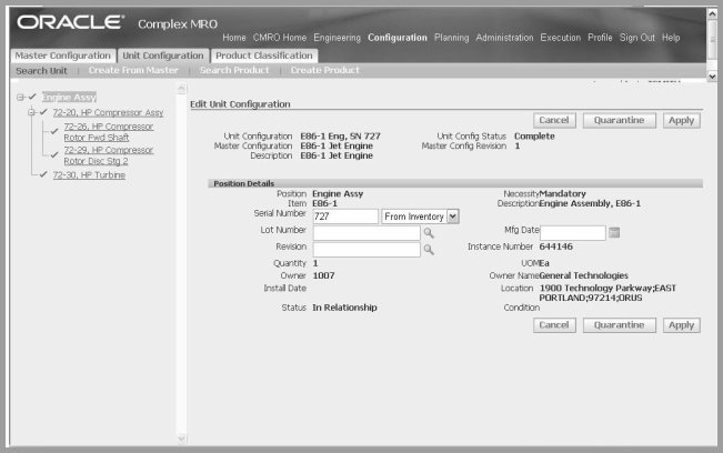

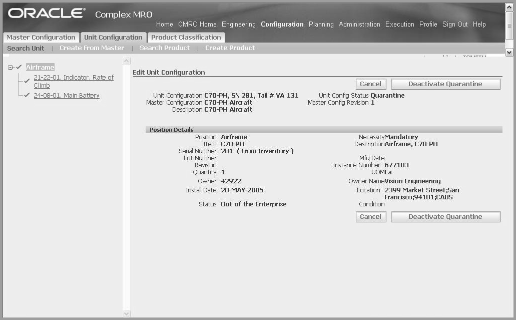

To quarantine a unit configuration
  1. Navigate to the Edit Unit Configuration region of the Unit Configuration page.
  2. Select Quarantine.
    When the unit configuration is quarantined, all transactions are stopped including:
    Deactivation of a quarantined unit returns the unit configuration to the status prior to quarantine: Complete or Incomplete.
  3. To deactivate a quarantined unit configuration, navigate to the Edit Unit Configuration region of the Unit Configuration page.
  4. Choose Deactivate Quarantine.
