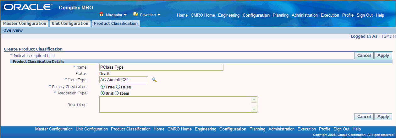

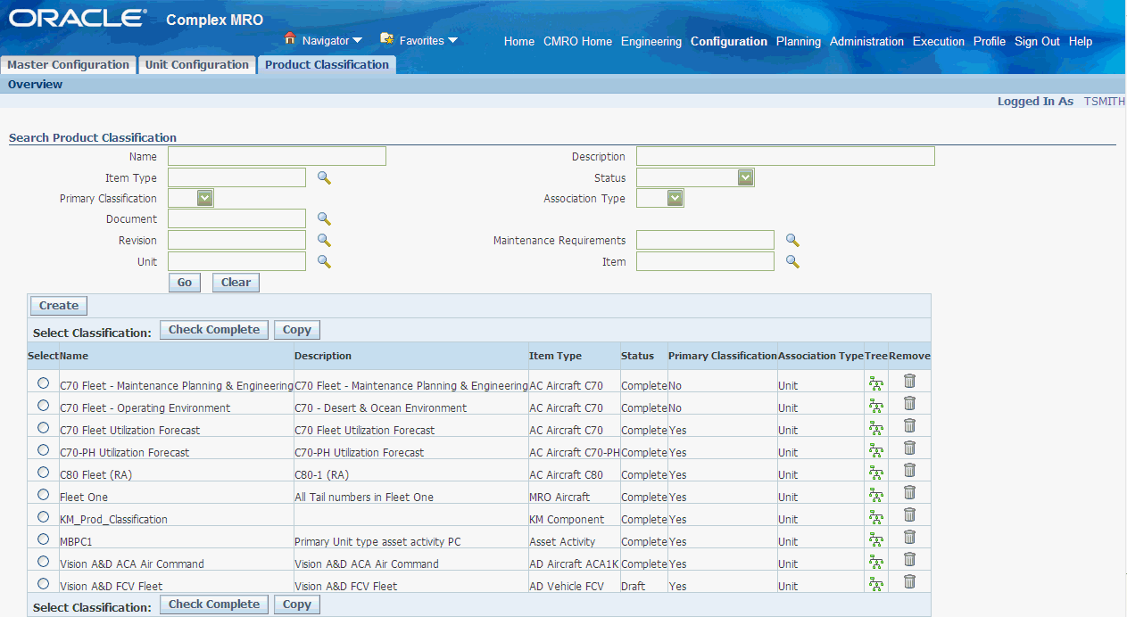

To create a product classification
Navigate to the Create Product Classification page.
Enter a unique name for this product classification, and select a value in the Item Type field.
In the Primary Classification field, indicate if this record is classification record is the primary one. Your choices are True or False.
In the Association Type field, indicate if this classification is associated to a Unit or Item.
Optionally, you can enter descriptive text.
Select Apply to save your work, and display the Edit Product Classification page.
To find a product classification record
Enter the information in the applicable:
Name
Product Type
Status
Association Type
Document
Revision
Maintenance Requirements
Unit
Part
Select Go to display the results of your search.

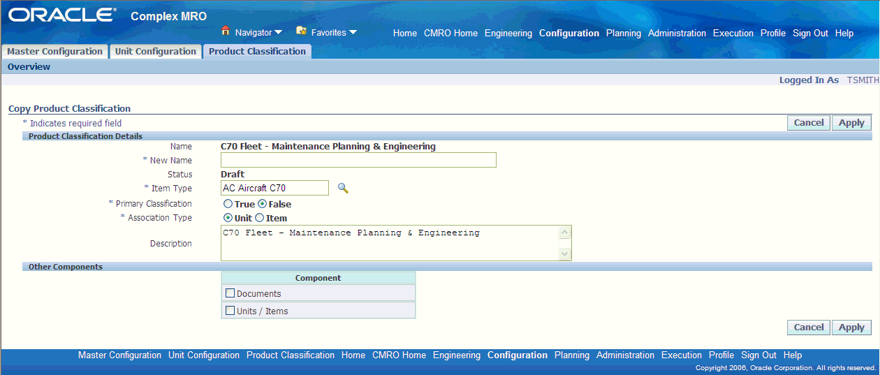

To copy a product classification
Navigate to the Copy Product Classification page
Enter a value in the New Name field—each product classification must have a unique name.
Change any other information about regarding the new record in the fields provided.
Note: Only one primary product classification is permitted for any product type. If you also want to copy other components, such as any associated unit, parts or documents, click the check boxes next to the relevant component.

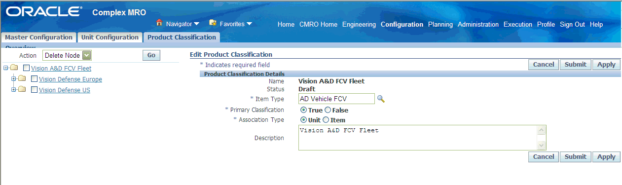

To edit product classification
Select the Tree icon navigate to the Edit Product Classification page.
Make the necessary changes in the fields provided. Note that only one primary product classification is permitted for any product type.
Select Apply to save your work.

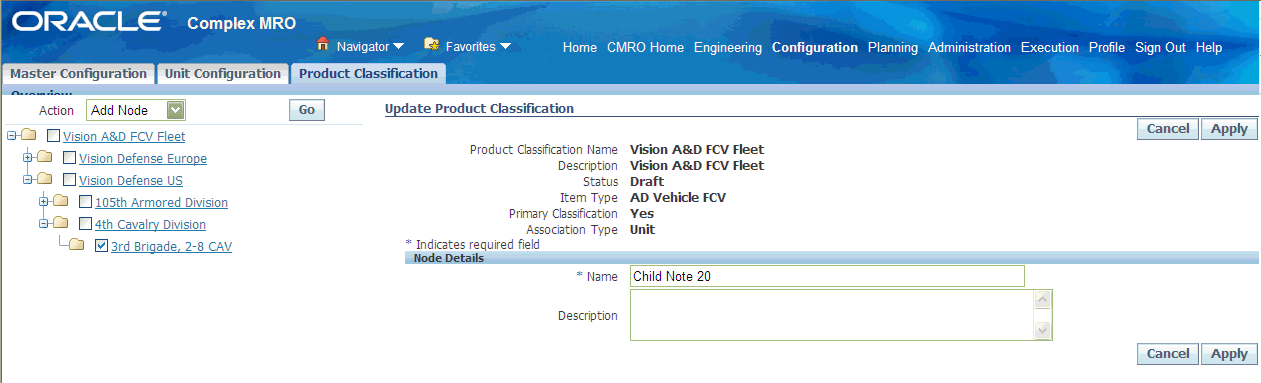

Assigning a part, instead of the unit to a node is an easier way to classify the products if a differentiation is not needed on the instance level. A hierarchy tree is used to graphically display the structure of product classifications and the elements related to them. You can add, edit, and remove nodes in addition to attaching documents, associate units/parts, and view the maintenance requirements for any selected product classification.
Select a product classification and navigate to the Edit Product Classification page.
Select a node, and choose Add Node from the Action menu.
Select Go to display information in the Node Details region.
Enter a name and descriptive text for this node.

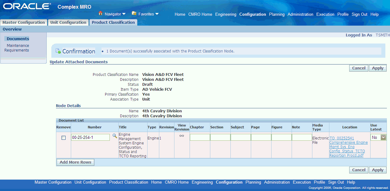

To associate a document to a node
Select the product classification record and navigate to the Edit Product Classification page.
Use the tree to find the node you want to associate a document, and select the node.
Click More Details button to navigate to the Update Attached Documents page. The page displays the currently attached documents.
To add a document, in the Document List region select the applicable document record.

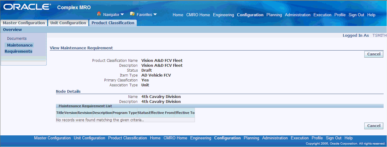

To view an associated maintenance requirement
Select a product classification record, and navigate to the Edit Product Classification page.
Select the node and choose More Details. The Update Attached Documents page appears.
Select Maintenance Requirements The View Maintenance Requirement page appears, displaying any currently relevant maintenance requirements.

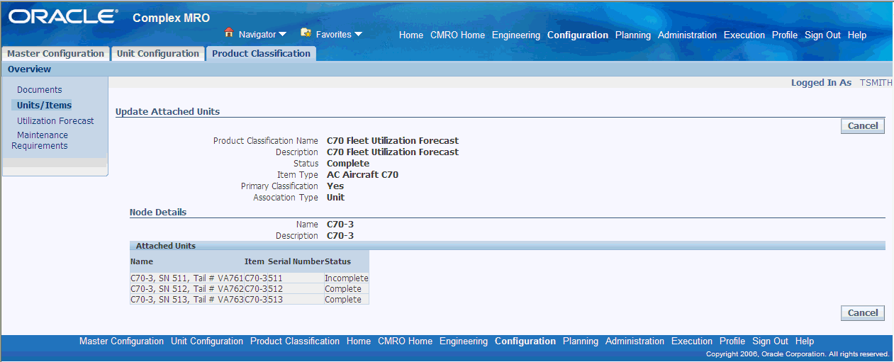

Product classification uses a tree structure to graphically display the structure of product classifications and the elements related to them. Units and items can be associated with product classifications by attaching them to the appropriate node of this tree structure.
To attach a part or unit
Navigate to the Edit Product Classification page.
Use the tree to find the node want to attach the part or unit, and select the node.
Choose More Details to display the Update Attached Documents page. Select Units/Items.
The Update Attached Units page appears, displaying any currently attached units.
To add a unit/item, choose Add More Rows, and select a unit or item value.

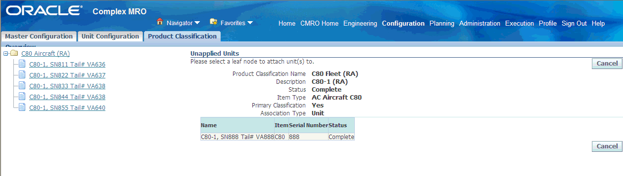

In the Search Product Classification page, select the product classification, and choose Check Complete.
Oracle Complex Maintenance, Repair, and Overhaul performs the check, then displays a confirmation message. If there are errors, the Unapplied Units page appears.
