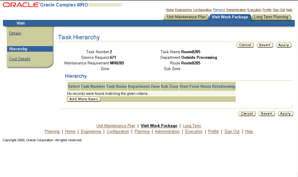

Visit Task Hierarchy Definition
Visit Work Package permits the maintenance planner to precisely define the order of completion of all tasks that comprise a maintenance facility visit. The precedence order is established by parent-child relationships such that a child task has as many parents as it is technically dependent on. This feature ensures that complex routes are correctly planned and accomplished. Technical dependencies defined between routes for a maintenance requirement in Fleet Maintenance Program are automatically used to create a hierarchical relationship between a visit's tasks. This sequence of tasks within a visit is used to calculate the derived completion date of a visit, allowing the planner to make sure that it does not exceed the visit's defined end date.

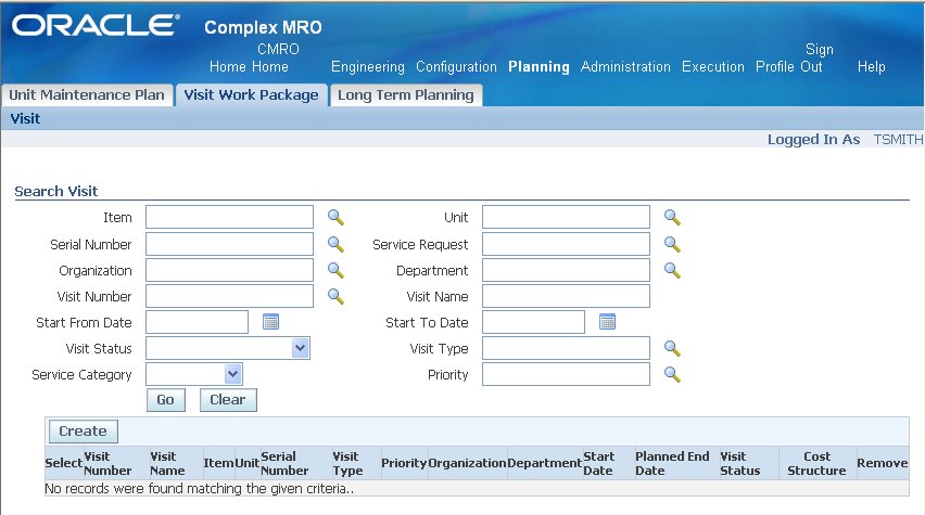

Search Visit
Select your search criteria and choose Create to launch the Create Visit page.

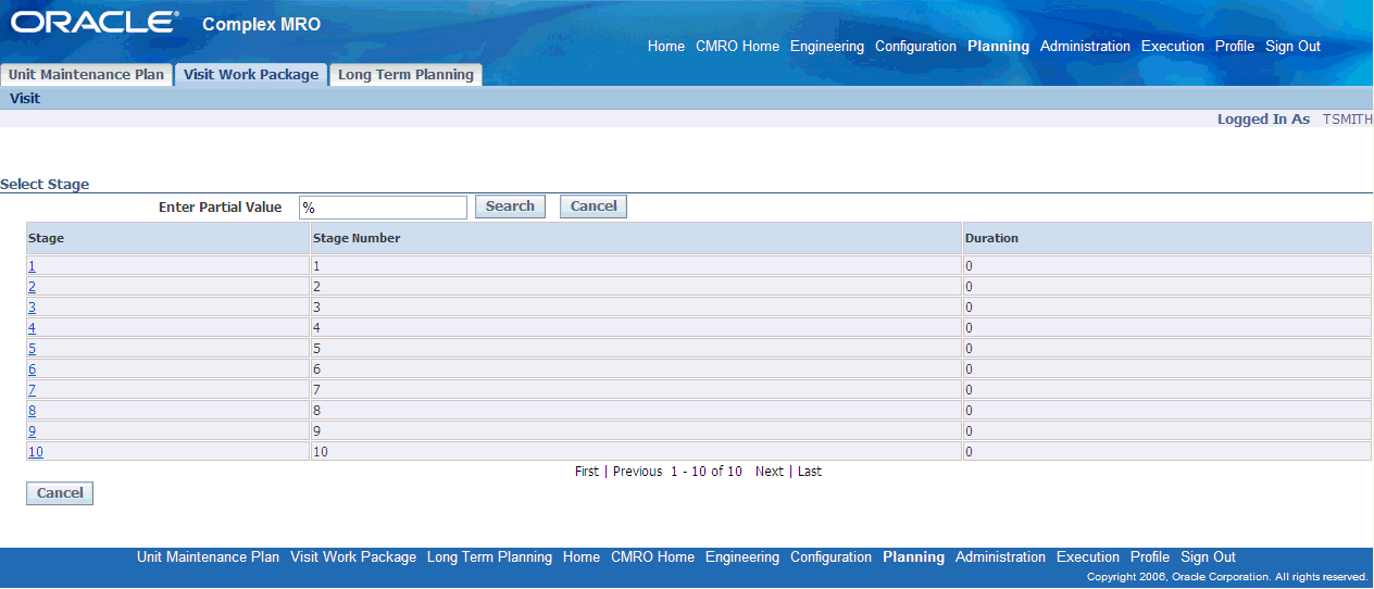

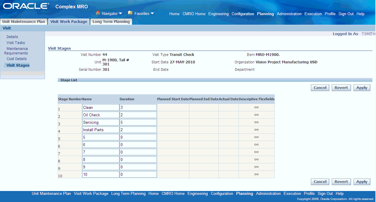

You can define the stages for a visit, Stages can also be specified when associating a route to a maintenance requirement. When this maintenance requirement is assigned to a visit, the visit tasks automatically inherit the stages specified during the MR-Route association. The stage numbers are predefined for all visits.
To set up stages for a visit
Navigate to the Update Visit page.
Select Stages to display the Visit Stages pages.
In the Stage List table, enter a name and duration for the stage. The Stage Start/End Time is derived from based on the Visit Start Time, Visit Department, Department Shift, and Stage Duration. The Duration must be an integer greater than or equal to 0 and the stage name must be unique within one visit.
Note: If you do not want all of the stages defined in setup for a particular visit, you can leave the name blank and the duration left at 0.
Select Apply to save your work. The Planned Start and End time changes based on the duration specified.

Maintenance planners need to retrieve existing maintenance visit records for reference or new visits based on an existing visit. The Search Visit page provides the ability to search and display all maintenance visits regardless of their status.
To retrieve existing maintenance visit records
Navigate to the Search Visit page and search for records.

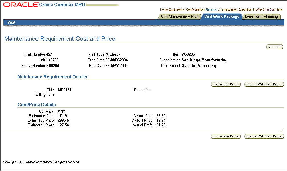

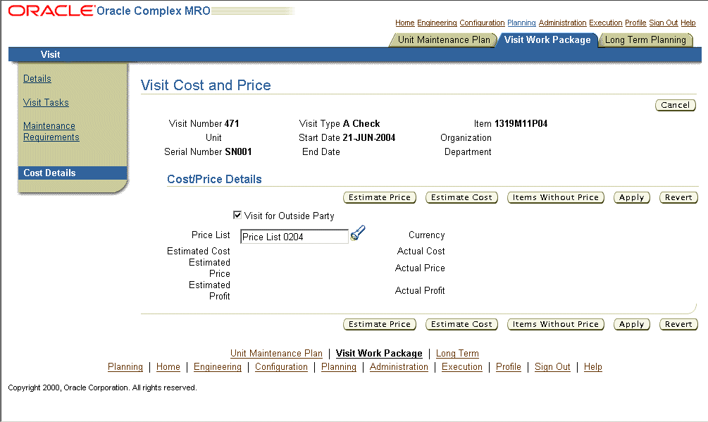

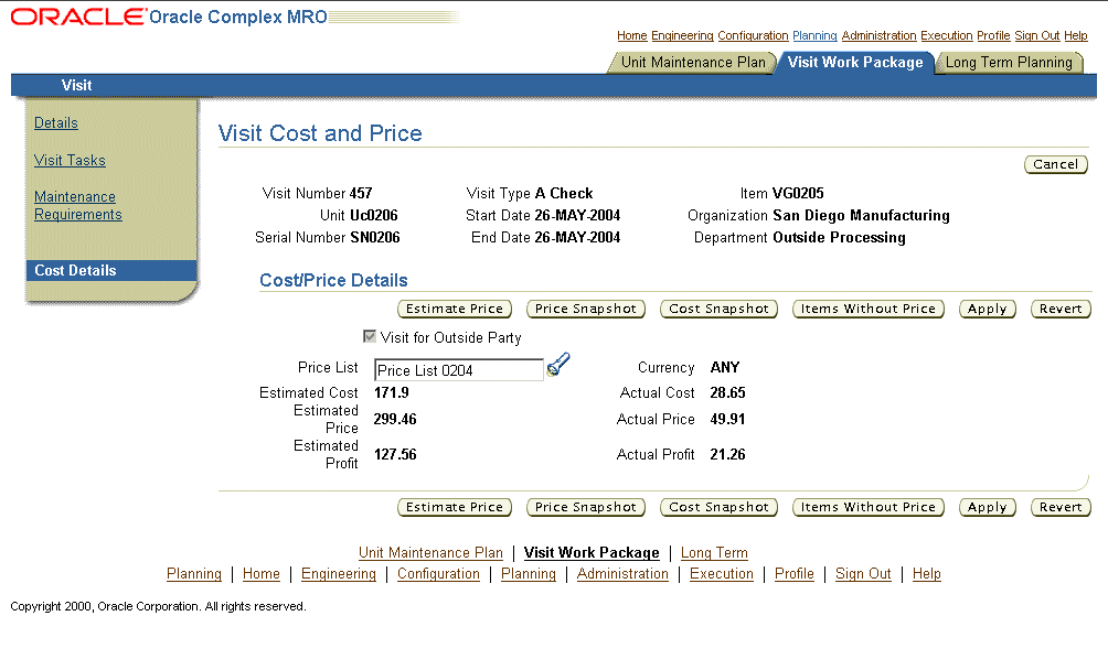

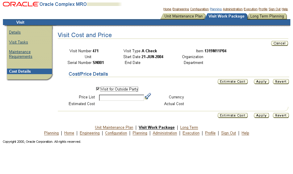

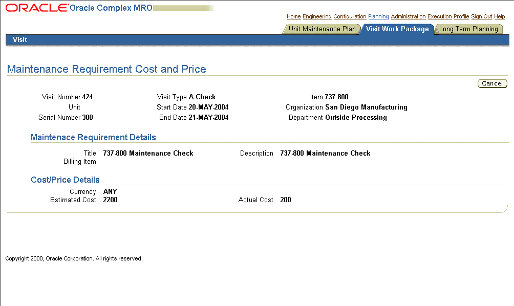

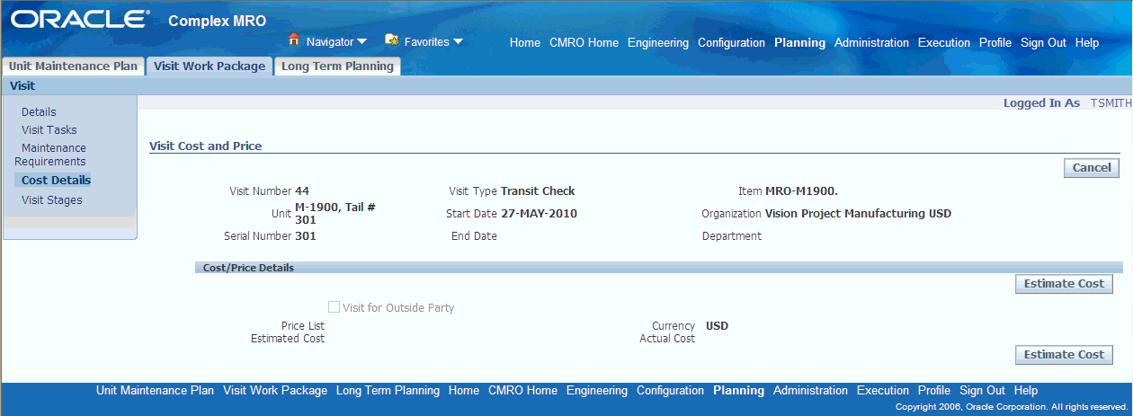

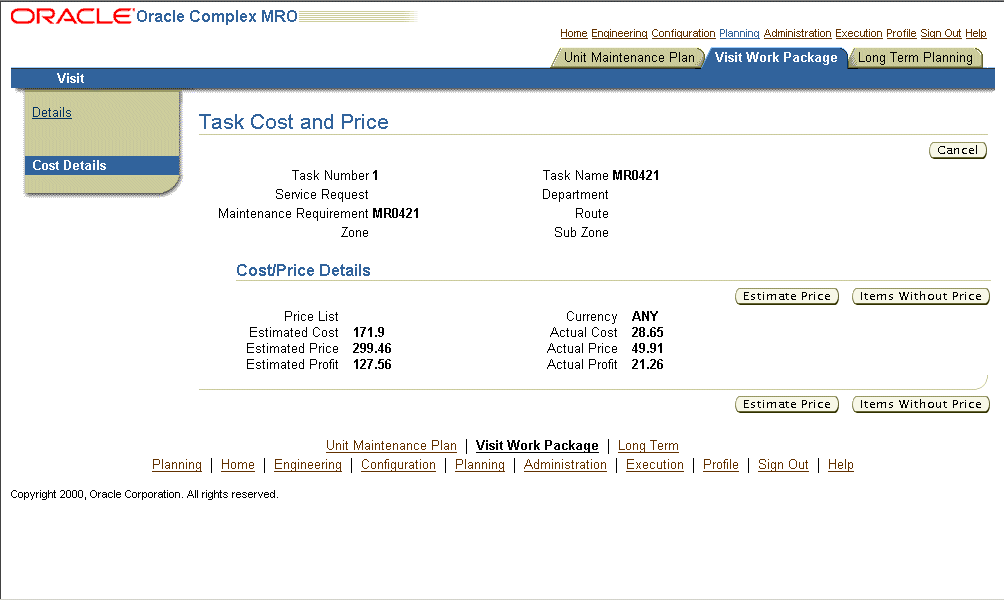

To view the cost and/or price information for the visit, choose Cost and Price to display the Visit Cost and Price page

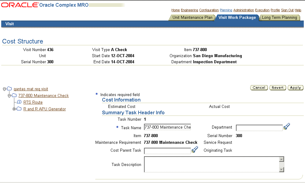

To view the task cost structure for a visit, choose Cost Structure.

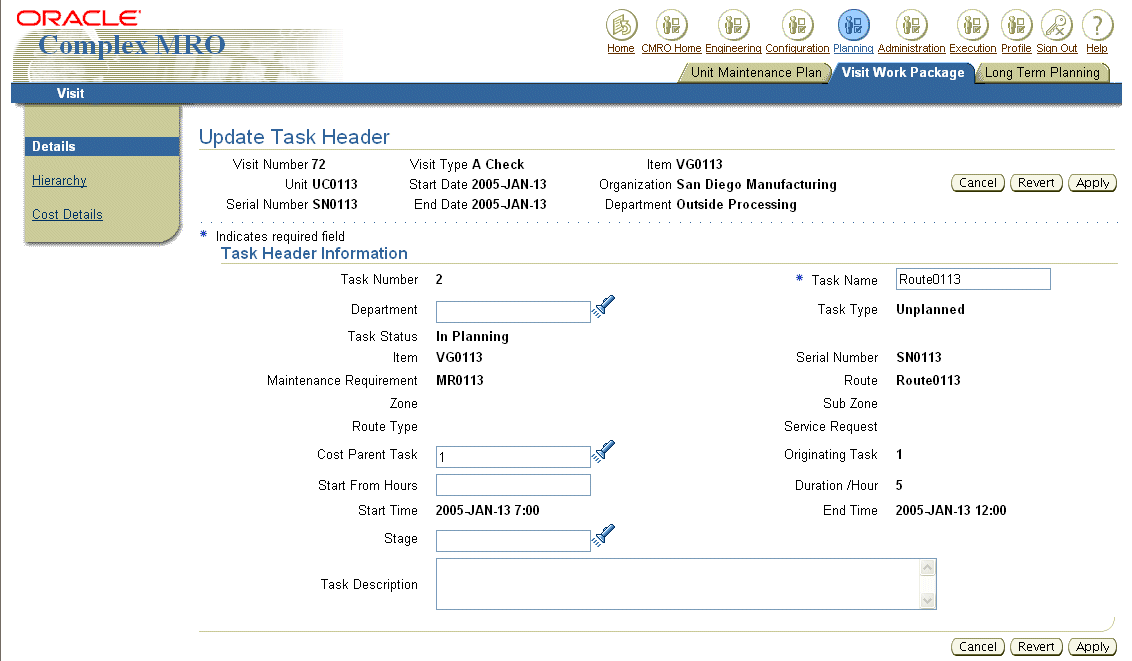

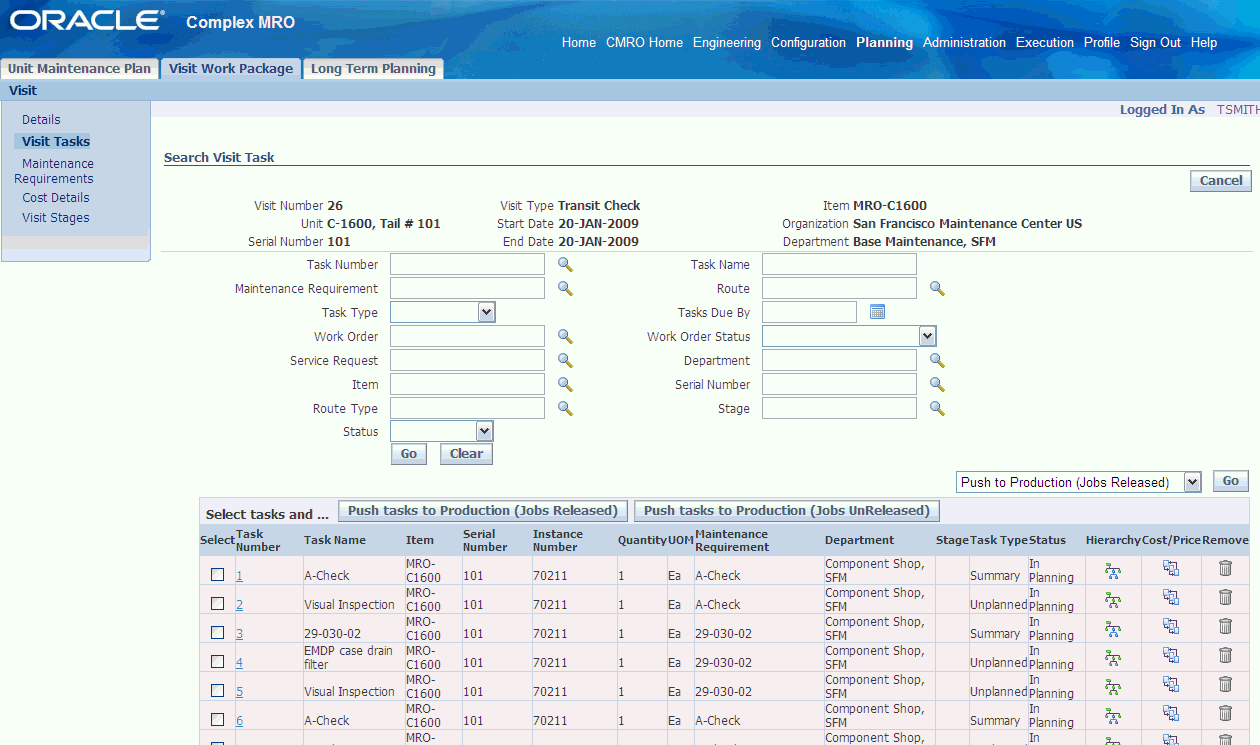

Select Visit Tasks. This launches the Search Visit Task page with the visit context information, and the list of tasks, if any, already associated with the visit.
To update a task associated with the visit, select the pertinent task. This launches the Update Visit Task page, see Updating Visit Task Headers.

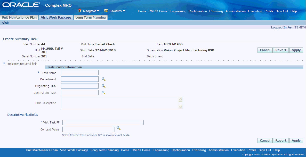

To create a summary task, select Create Summary Task and choose Go. The Create Summary Task page appears.
Enter task details and select Apply to save your work.
Summary tasks are created automatically for each maintenance requirement in the process of creating Planned and Unplanned tasks. You can create summary tasks until the visit is closed. If new summary tasks are created in a released visit, then the status of the visit will not become Partially Released.

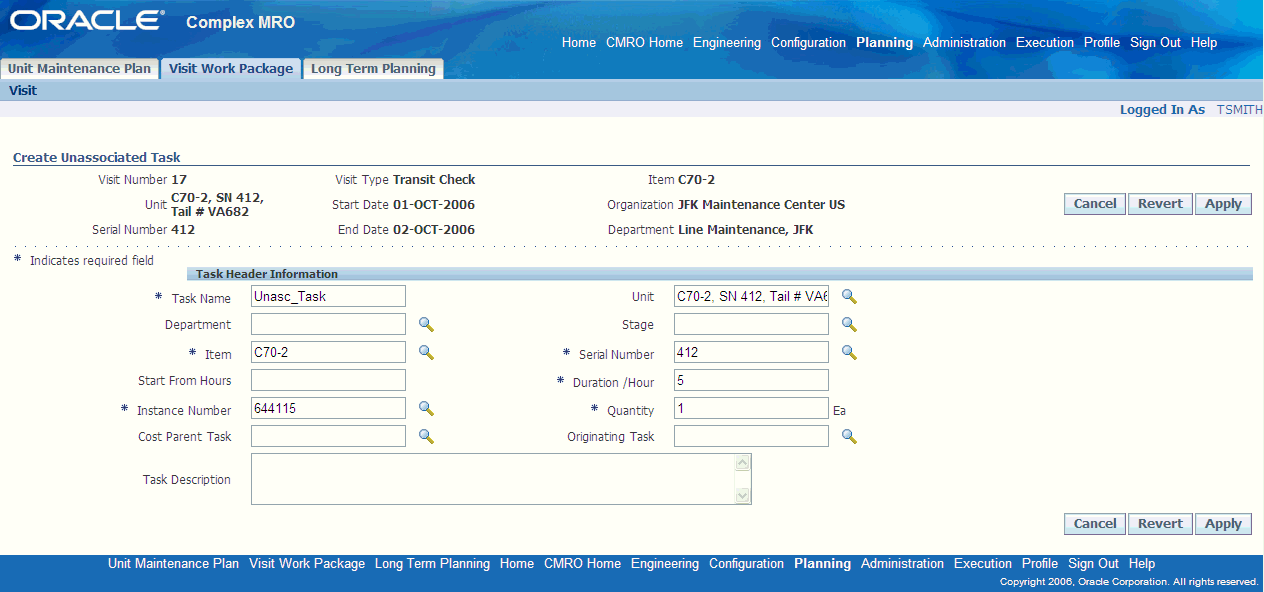

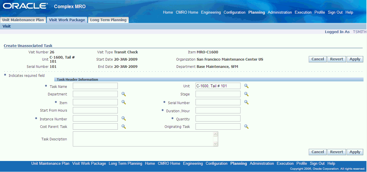

To create a new task, unassociated to any maintenance route, select Create Unassociated Task. This launches the Create Unassociated Task page, see: Creating Visit Tasks Unassociated with Routes.
Select the applicable fields in the Task Header Information region. Select Apply to save your work.

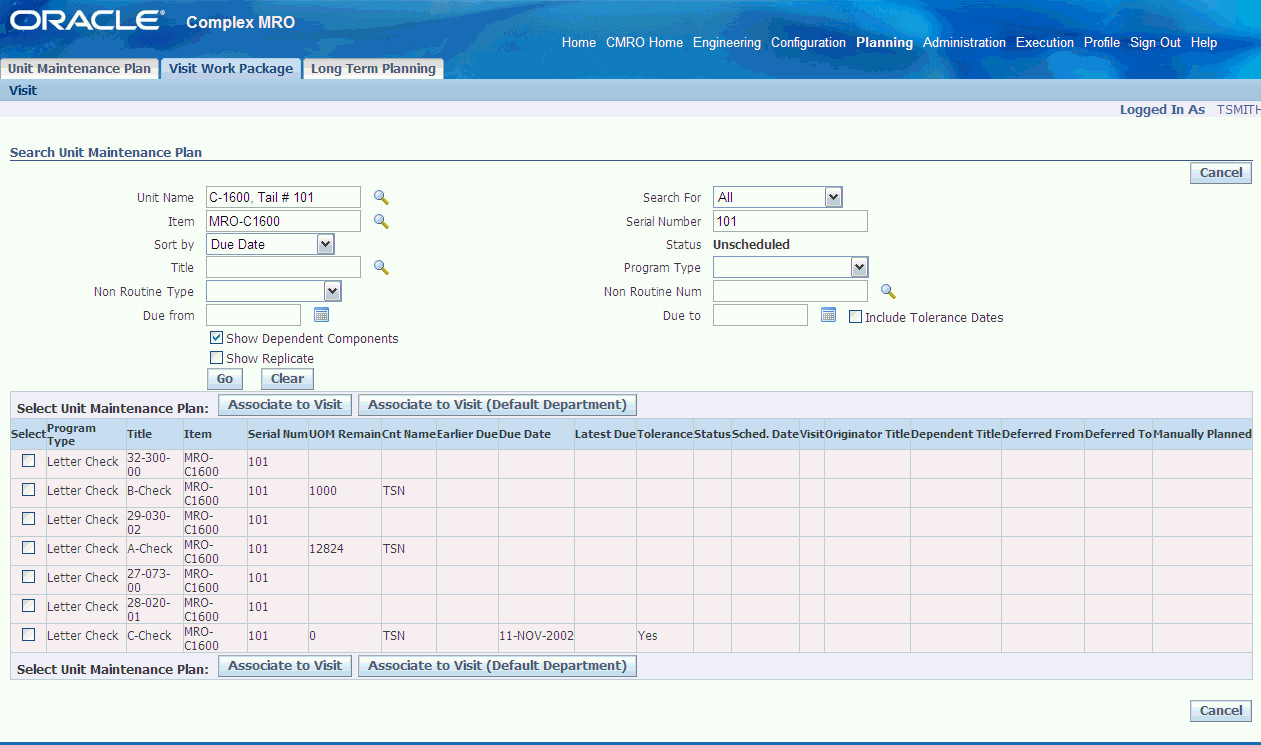

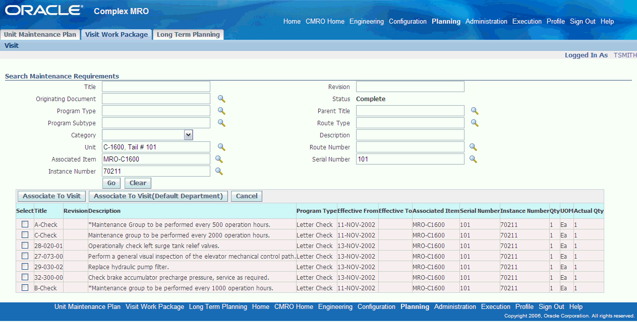

To associate planned maintenance requirements to a visit
Navigate to the Update Visit page for this visit.

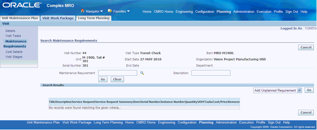

Select Maintenance Requirements. In the Search Maintenance Requirements page, select Add Planned Requirements from the drop-down menu.
The Search Unit Maintenance plan page appears. Query for the unit maintenance requirements. The results appear in the Unit Maintenance Requirements table.

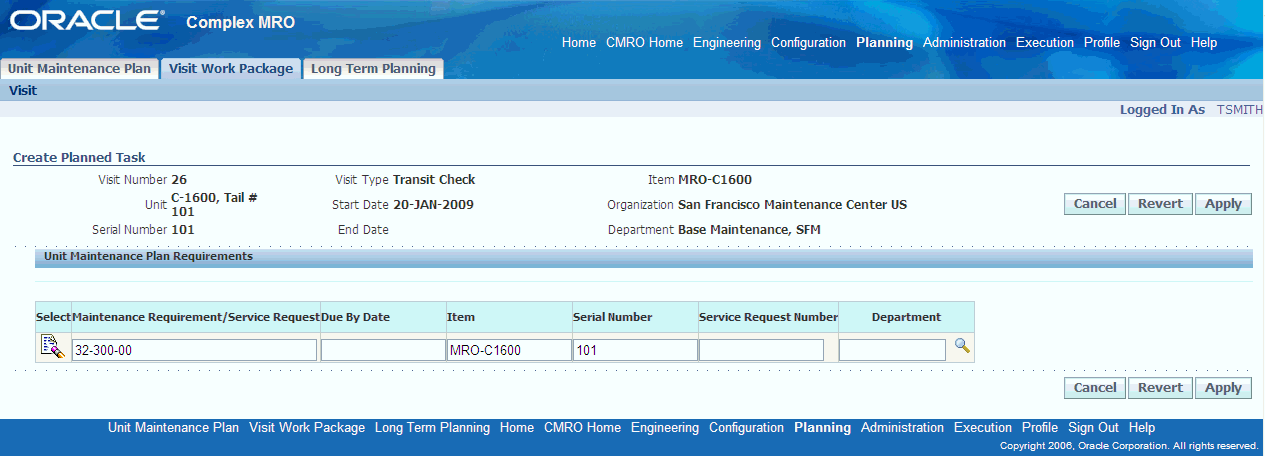

Select one or more maintenance requirements and select Associate to Visit. The Create Planned Task page appears. Click Apply to add the task to the visit.
A summary task is automatically created for each maintenance requirement and service request in the process of creating Planned tasks. Summary tasks will be are used as the originating task and cost parent of planned tasks. If you select Associate to Visit (Default Department), the task is automatically added to the visit without requiring association through the Create Planned Task page.
If a unit is specified in the visit header, then tasks can only be created for units on the configuration tree of the visit header unit.
You can associate a department to the tasks. Alternatively, the department associated to the visit header is associated to all the tasks created. You can create unplanned tasks until the visit is closed. If new unplanned tasks are created in a released visit, then the status of the visit becomes Partially Released. You can delete a maintenance requirement from the visit when the visit is in planning stage. When a task is deleted all the tasks of that requirement are deleted.
To associate unplanned maintenance requirements to a visit
When you add a Maintenance Requirement for non serialized instances, you can select the instance quantity that the applicable maintenance needs to be accomplished on. This quantity is associated to the applicable tasks and the corresponding work orders.
Select your maintenance requirement record on the Search Maintenance Requirements page, and choose Associate to Visit.

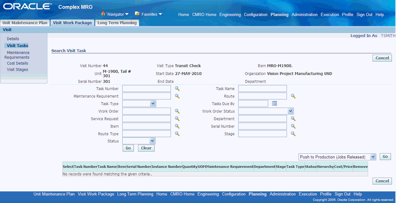

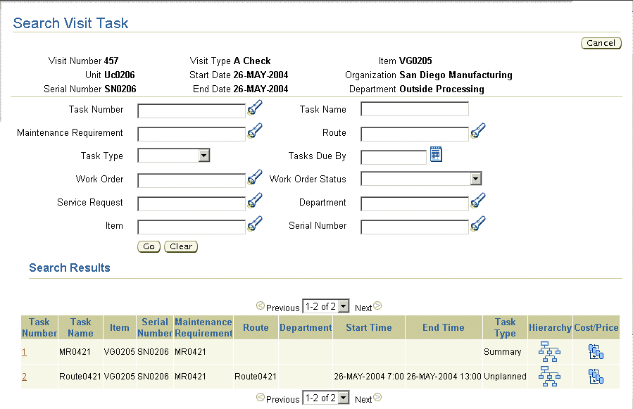

After a maintenance planner creates a visit structure, the Search Visit Tasks page permits the planner to retrieve tasks associated with a particular visit, or to add new tasks to the visit structure.
After retrieving visit tasks based on desired search criteria, the planner can select a task for subsequent editing. The Search Visit Tasks page also allows maintenance personnel to link to pages that permit creation of tasks associated with serialized inventory items, for both imminent and undated maintenance requirements, and tasks associated only with non-serialized assemblies.
To retrieve existing visit tasks
Navigate to the Search Visit page. .
You can use the following search criteria to find your visit. Select Go to display the results of your search.
Task Number
Task Name
Route
Task Type
Task Due By.
Work Order
Work Order Status
Service Request
Department
Item
Serial Number
Route Type
Stage
Status
On the Search Visit Task page, select information in any of the search fields to query for tasks related specifically to your search criteria.

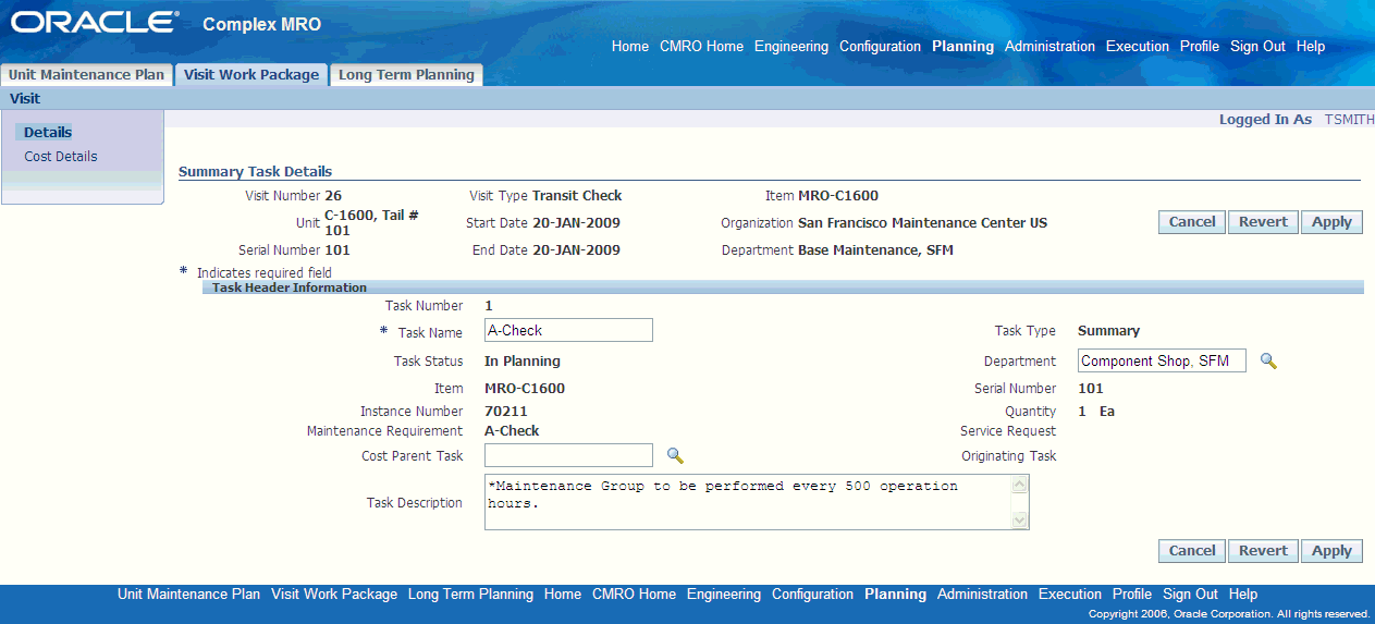

To update visit task details, select the Task Number to display the Summary Task Details page.
You can update the visit task details and associated information only if the visit record is in the Planning state. If the visit record is in the Released or Closed status, the system generates the visit task details page in view only mode.

To associate serial numbers and service requests with a task
Navigate to the Create Unplanned Visit Task page. The page displays the Visit Number, Visit Type, Item, Unit, Start Date and End Date as context information. The Item subcomponent in the visit package to which the service request or serial number is to be associated is also displayed.
In the Task Header Information region, select values in the item, Serial Number, Department, and Service Request fields.
Select Apply to associate the Item Serial Number to the selected task.
You can create ad hoc tasks, usually to repair or replace a component, to be included in a shop or field maintenance visit. Tasks can be added to a visit on an ad hoc basis, even if no corresponding route exists. The description of the work to be accomplished, and the required tools and materials is stored as a task remark. The Create Unassociated Task page is used to create a task that is not associated with any maintenance route.
Note: Unassociated tasks are added to a visit for any available instance, irrespective of the unit associated to the visit's header.
To create visit tasks unassociated with routes
Select a visit number record and navigate to the Create Unassociated Task page.
Enter a value for Task name, and select a Department and Stage for this visit.
Note: If unit is specified in the visit header, you can create unassociated tasks only for one of the components of the unit.
When you create tasks for non serialized instances, you can select the instance quantity that the applicable maintenance needs to be accomplished on. This quantity is associated to the task and the corresponding work order.
Select values in the Item and Serial Number fields.
Enter a Start From Hours value pertaining to this unassociated task.
This is the time offset in decimal hours, of this task, from the beginning of the visit being planned. Use this field to specify precisely when this task should start relative to the beginning of the visit.
Enter a value in the Duration/Hour field, this is the duration in hours of this task.
Select a value for Cost Parent Task.
This is the identifier of the summary task in the task hierarchy at which a subtotal of cost transactions, including the costs attached to the task being created, will be calculated. A top task must be a summary task.
Select a value for Originating Task.
This is another task that requires the inclusion of the current task in the visit task package. A task may not originate itself. The originating task usually is part of a scheduled maintenance requirement.
In the Task Description box, enter any descriptive text.

You can associate tasks with the stages defined for a visit. Stages can be determined when associating routes to a maintenance requirement. When this requirement is assigned to a visit, the task automatically inherits the stage definition specified during route association. Stages cannot be assigned to summary tasks.
You can add and modify stage information until the task is pushed to production. A task with no stage defined for it is planned at the end of the visit and is not considered for long term planning. A stage with no duration and tasks in a visit implies that the stage is not applicable for that visit.
Task hierarchy honors stage sequence. If there are two tasks and one is dependent on the other, the second task will be in the later stage or in the same stage as the first task.
To associate stages with tasks:
Navigate to the Create Unassociated Task page.
In the Stage field, query the stages defined.
Select the stage that you want to associate the task with. Select Apply to save your work.
You can retrieve existing maintenance visit task records, and edit the header and task hierarchy information.
The planner can modify the task attributes that are unique to the current visit association. Attributes inherited from the route definition cannot be updated.
Use the Update Task Header page to update visit task header details, and to navigate to pages that allow you to update task dependency and task hierarchy.
From the Search Task page
Select a record and navigate to the Update Task Header page.
Use the information in the following table to enter or update values in the Update Task Header page.
You cannot update a task if a maintenance requirement or maintenance requirement route is associated with the task.
You can update the following fields: Task Number, Task Name, Maintenance Requirement, Service Request, Cost Parent Task, Description, Duration/Hour, Route, Start From Hours, Originating Task, and Stage.

To define visit task hierarchy
Retrieve the desired visit task records and navigate to the Update Task Header page.
Select Hierarchy to launch the Task Hierarchy page. The task header context information is displayed on the page. Optionally, you can use the Hierarchy icon in the Search Visit Task page, to navigate to the Task Hierarchy page for a particular task.
To edit the workflow hierarchy information of an associated task, select the task and choose Edit Hierarchy.
Enter a Task Name and select a Relationship value. Your choices are Parent or Child.

To define visit cost structure
Select a visit and navigate to the Visit Cost Structure page.
Enter a unique value in the Task Name field.
Select appropriate values in the Serial Number, Maintenance Requirement, and Service Request fields.
Select a value in the Cost Parent Task field.
The Cost Parent Task field determines which other task is the current task's immediate predecessor in the cost accounting structure. The tree-structured task graphic shows the relationships between the tasks. This is the mid-level task connected to the current task as a low-level task. Only low-level tasks can have associated cost transactions.
Select a value in the Originating Task field.
This is a task that requires the inclusion of the current task in the visit task package. A task may not originate itself. The originating task usually is part of a scheduled maintenance requirement.
In the Description field enter any appropriate descriptive text.
Select Apply to

To estimate the cost of a visit
Navigate to the Visit Cost and Price page.
Select information in the following fields
Price List: A list containing the base selling price per unit for a group of items, item categories, or service offered.
Estimated Cost: This value is calculated based on the material and resource requirements for a job.
Actual Cost
Estimated Price: It is the price quoted by a maintenance organization for performing a third- party service, and is based on the price of the required material and resources for the service.
Actual Price: It is the price for performing a service at a third party location, calculated based on the actual price of the used material and resources.
Estimated Profit: It is calculated by subtracting the estimated cost from the estimated price.
Actual Profit: It is calculated by subtracting the actual cost from the actual price.
Select Estimate Cost to initiate the cost estimation process. The cost will be displayed in the Cost/Price Details region.

Navigate to the Task Cost and Price page showing the estimated and actual task costs.
To view cost of a maintenance requirement, navigate to the Maintenance Requirement Cost and Price page.

To calculate the price for a visit
Create a visit, and associate a service request with it. Save the record.
In the Update Visit page, select Cost Details from the side navigation menu. The Visit Cost and Price page appears. Select the Visit for Outside Party check box.
Mark a Visit for Outside Party - Visit Cost and Price page
Select a Price List using the LOV icon. You can only associate a price list that has been created for the customer specified in the service request, and is valid for the period between the visit start and end date. Click Apply. The Estimate Price button appears in the Cost/Price Details region.
Estimate Price - Visit Cost and Price page

Click Estimate Price in the Visit Cost and Price page, to initiate the price calculation process.
The following can be applied to the price calculation process:
The price of a task, associated with a route, is estimated by adding the price of the materials and resources required to perform that task. The estimated price for a task without a route association is always zero. The actual price is calculated by adding the prices of the materials and resources transacted. If the task price is recalculated, and the amount differs from the former estimate, then the MR and visit prices are adjusted accordingly.
For an MR with a billing item associated, the estimated price is the price of the billing item. For an MR with no Billing Item associated, the estimated price is the sum of the estimated prices of the tasks in that MR. The actual price of the MR is calculated by adding the actual prices of the tasks in that MR. If the MR price is recalculated, and the new price differs from the old one, then visit price will be adjusted accordingly.
The estimated price of the visit is the sum of the estimated prices of the MRs and other tasks that are not through an MR. The actual price of the visit is the sum of the actual prices of the MRs and other tasks that are not through an MR. When an MR or a task is deleted from the visit, the MR/task price is subtracted from the visit price.

To view price at the task level, click Visit Tasks in the side navigation menu. The Search Visit Task page appears, displaying a list all the tasks associated with the visit.
To view the task price, select the corresponding Cost/Price icon, the Task Cost and Price page appears displaying the estimated and actual task prices.
To view price at the MR level, in the Visit Cost and Price page, click Maintenance Requirements in the side navigation menu. The Search Maintenance Requirement page appears, displaying the list of MRs associated with the visit.
To view the MR price, click the corresponding Cost/Price icon. The Maintenance Requirement Cost and Price page appears, displaying the price.
View Maintenance Requirement Price - Maintenance Requirement Cost and Price page

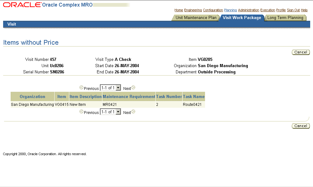

To view a list of the items not defined in the price list, for a task, MR and/or visit, click Items Without Price. The Items without Price page appears, displaying the items, if any.

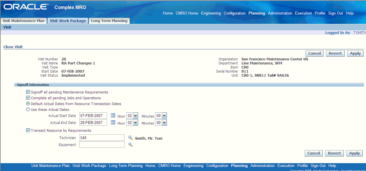

Once you have finished working on the maintenance visit and implementing the same, you can close the maintenance visit record.
To close a visit
Navigate to the Search Visit page and choose the visit that you want to close.
Note: You can only close visits in Implemented status.
Click the Visit Number link to navigate to the Update Visit page.
Choose the Close option from the drop down list and click Go.
The Close Visit page opens.
In the Signoff Information region, verify if the check boxes for signoff are ticked.
Click Apply to close the visit permanently.
