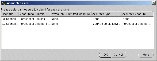

Access Oracle Demand Planning as a Demand Planner.
On the Navigation toolbar, choose the Tools button.
From the submenu, choose Submit Measures.
Result: The Submit Measures dialog box opens, displaying submission information for each scenario in the demand plan. If a measure has not yet been submitted for a scenario, the Measure to Submit column shows the default submissions measure for the scenario if a default measure has been set; otherwise, it shows "None." If a measure has previously been submitted for the scenario, the Previously Submitted column displays the name of this measure; otherwise it displays "None."
To select an alternate measure (or to select a measure if "None" is the current selection), in the Measure to Submit column, choose the measure that you want to submit.
Note: Do not select a measure that has been limited by a qualifying value such as a single geography. If you do so, then the qualifying value will be used to generate uploaded values for all dimension values at this level.
If an accuracy measure is required for the scenario, you can select a measure from the Accuracy Measure column. It will display all measures that are not dimensioned by Time, including those you have created, either by creating a formula, or by calculating a new one based on other accuracy measures.
To select a measure to submit a measure for another scenario, repeat Steps 4 and 5.
Note: It is not necessary to select measures for all scenarios at the same time. However, if you have previously selected a measure for one scenario and you are satisfied with your choice, choose "None" as the measure to submit for that scenario when you select a measure to submit for another scenario.
Choose OK.
For example, the planner can select measures to submit for two scenarios. The planner can also submit accuracy measures for one of the scenarios.

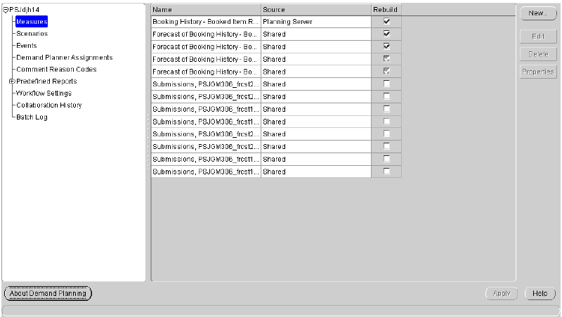

Your System Administrator has the option of reusing submission measures. The Administrator may stipulate that the submission measure created during the first Distribute to Assignments stage will be used with every subsequent redistribution.
Your Demand Planning System Administrator has the options described below.
To allow users to create only one set of Submission measures -- one for each scenario. (Measures are reused automatically.)
To allow users to create new sets of Submission measures with each Distribute to Assignments process. (Measures not reused.)
To allow users to switch from reusable to non-reusable Submission measures and vice versa.
The System Administrator sets the appropriate option for the creation of Submission measures by using a checkbox in the Scenarios page.

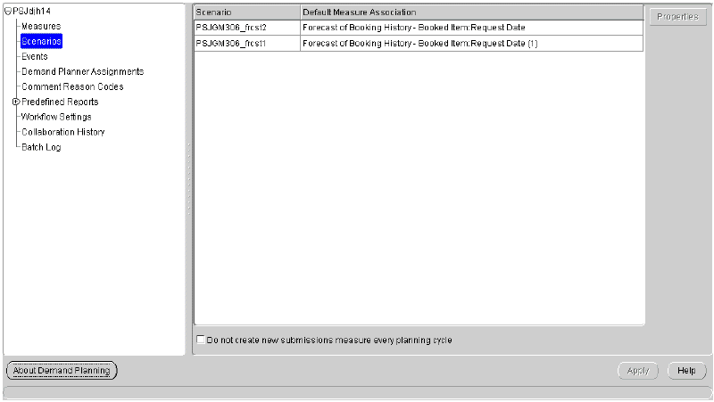

The procedure described below enables the use of a submission measure that is used with every redistribution.
In the System Administrator's interface, select Scenarios from the Navigation List.
Go to the Scenarios page. This page has columns for scenarios and corresponding default measures.
The Do not create new submissions measure every planning cycle box is available and unchecked.
The Apply button is disabled.
Check the box to create a reusable submissions measures.
When the box is checked, the Apply button is enabled.
Choose Apply.
Further consequences of using or not using the Do not create new submissions measure every planning cycle box are discussed below.
If the you leave the checkbox blank, a new set of Submission measures will be created with each Distribute to Assignments process.
If Submission measures have already been created and the System Administrator chooses Do not create new submissions measure every planning cycle, the most-recently created Submission measures are used automatically. The conditions below also apply.
No new Submission measures will be created.
Existing sets of submission measures (previous versions) remain in the system; they are not automatically be deleted.
If Do not create new submissions measure every planning cycle is checked before the first "Distribute to Assignments" process and has never been changed , only one set of Submission measures will exist, with one Submission measure per scenario.
If this checkbox is unchecked after being checked, new sets of Submission measures are added to existing list after each Distribute to Assignments process.
