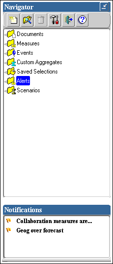

The Alerts folder in the Navigation list displays all alerts that you have defined.
Your Notifications list displays only those alerts that meet all of the following criteria:
You defined the alert.
The alert has run.
The exception condition has been met.
Consider an example, where the user has defined two alerts, both of which are displayed in the Alerts folder in the Navigation list. One of the alerts is also displayed in the Notifications list, indicating that the alert has run and the exception condition has been met. The Notifications list also displays a message that there are collaboration measures ready to be received.

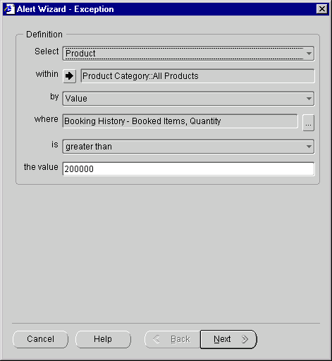

An alert that is based on a value exception compares a measure to a numeric value or range of values. For example, you might use the Value option to alert yourself or other users when a forecast difference measure (a custom measure defined as forecast less actuals) is less than or greater than a specific number.
Access Oracle Demand Planning as a Demand Planner or Demand Plan Manager.
On the Navigation toolbar, choose the New button.
and choose New Alert from the popup menu.
Alternatively, you can click the right mouse button on the Alerts folder in the Navigation list and choose New Alert from the popup menu.
Result: The Alert Wizard - Exception page opens.
In the Alert Wizard - Exception page, define exception criteria as follows:
In the Select box, choose the dimension to which the exception condition applies.
In the within box, click the arrow to display the hierarchies for the dimension. Select a hierarchy and then select a level within the hierarchy.
In the condition box, select Value.
In the measure box, select the measure on which to base the exception condition.
You can accept the default measure or choose the Ellipsis button to access the Dimension Value Selector dialog box, where you can select an alternate measure.
In the operator box, select the operator that identifies how data values will compare to a specified value. You can select one of the following terms:
less than
less than or equal to
equal to
not equal to
greater than or equal to
greater than
between
outside
Complete the value box (or boxes) as follows:
If the operator is other than between or outside, enter a number that is to be compared to the values of the selected measure.
If the operator is between or outside, enter the top and bottom of the value range that is to be compared to the values of the selected measure.
Choose Next to continue.

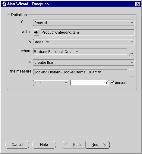

An alert based on a measure exception compares the values for one measure to the values of another measure. For example, you might use the measure exception to alert yourself or other users when a forecast for a specified time period exceeds the customer forecast by a specified percentage.
On the Navigation toolbar, choose the New button,
In the Select box of the Alert Wizard - Exception page, define the exception condition for the alert as follows:
In the Select box, choose the dimension to which the exception applies.
In the condition box, select Measure.
In the first measure box, select the measure on which to base the exception condition.
In the operator box, select the operator that identifies how the measure that you chose earlier will relate to a comparison measure. You can select one of the following terms:
less than
greater than
within
not within
In the measure box, select a comparison measure.
You can accept the default value or choose the Ellipsis button to access the Dimension Value Selector dialog box, where you can choose an alternate measure.
You can specify a numeric or percentage value to consider when comparing the measures. To do this, proceed as follows:
If the operator is less than or greater than, choose plus or minus. If the operator is within or not within, plus or minus is the only selection.
In the value box, enter a numeric value.
If the value is a percentage, choose percent.

Your Notifications list displays messages that have been generated by Oracle Workflow. You might see two types of notifications:
When there is an alert for your attention, a notification concerning the alert is displayed.
If another planner or the Demand Plan Manager has sent data that is within the scope of your assignment, a notification that collaboration measures are ready to receive is displayed.
You can work with notifications as follows:
Open a notification
Delete a notification
View the properties of a notification (alert only)
