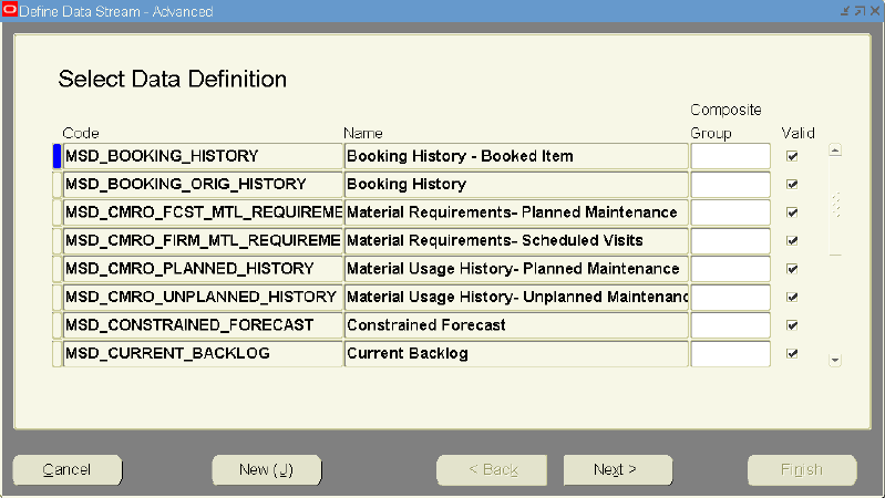

To open the Select Data Definition window, select Setup > Data Streams > Define-Advanced in the Navigator. Or select Define-Basic if you are not familiar with the Oracle Demand Planning data model and architecture.
Note: As described earlier, there are two modes of defining data streams: Define-Basic and Define-Advanced. You should select only one of them. If you are not familiar with Oracle Demand Planning data model and architecture, you should use the Define-Basic, which provides only the basic functionality. The steps in this section explain the functionality of Define-Advanced, and indicates anything that is similar or different for Define-Basic.
There is no difference in this window for the two modes of setup, except that the window name reflects the mode; that is, either Define-Basic or Define-Advanced.
All the data streams on the Select Data Definition window are preseeded data streams (identified by Code and Name). You can add your own flexible data streams to the list of preseeded data streams.

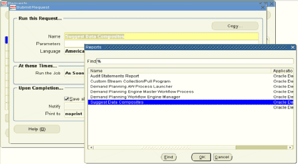

To set up automatic recommendation of composites:
Logon as the Demand Planning System Administrator.
Select Other > Requests > Submit a new request.
Select the concurrent program, 'Suggest Data Composites'.
Select Yes or No for the parameter, 'Do you want to apply the suggested composites'.
Selecting Yes will populate the Composite Group fields in the Select Data Definition. The user will still be able to change the groups.
The default value is No. Selecting No means that the suggested composites will not appear in the Select data Definition screen.
In either case of Yes or No, the program output will be displayed from the concurrent log of the launched request 'Suggest Data Composites'.
Now, the data streams are grouped automatically in the demand planning server.

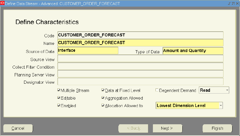

Select New to define a new data stream in the Define Characteristics window.
Complete the required fields in the Define Characteristics window as follows:
| Field | Value | Description |
| Code | Preseeded value. | Name of the data stream. This is a short name with less than or equal to 30 characters that Oracle Demand Planning uses internally to uniquely identify the data stream. |
| Name | User defined. | Description of the data stream. This is a longer description with less than or equal to 240 characters that you will henceforward use to identify the data stream in Oracle Demand Planning. |
| Source of Data | Planning Server, ERP, Interface. | Possible values are: Planning Server: where data comes from the same instance as that of Demand Planning Server. ERP: where data comes from some source database instance other than the Demand Planning Server. Interface: where data comes from a legacy system loaded as flat files into the Oracle Demand Planning staging tables. |
| Type of Data | Amount, Quantity, Amount and Quantity, Amount and Price, and Quantity and Price. | Possible values are amount, quantity, amount and quantity, amount and price, and quantity and price. The selected value indicates what types of data will be stored in the data stream. |
| Source View | Applicability varies. | Applicable when ERP is selected as the source of data. The Source View is a SQL view that defines where to find the quantity, amount, and price data for the flexible data stream. The Source View also defines where to find the dimension level values, such as product, geographic regions, time periods, sales channels, and customers to which those data are associated. |
| Collect Filter Condition | Applicability varies. | Applicable when ERP is selected as the Source of Data. Enter the relevant Where clause that describes the data that should be collected into Oracle Demand Planning. This functionality is only available in Define-Advanced. For details, see: Uploading Flexible Data Streams. |
| Planning Server View | MSD_CS_DATA_V (example) | This is the name of the view that Oracle Demand Planning accesses to populate its flexible data stream repository or fact table (for example, MSD_CS_DATA). If you are using Interface or ERP as the Source of Data, select the preseeded view MSD_CS_DATA_V. This view sits on top of the Oracle Demand Planning staging table MSD_ST_CS_DATA, which is the interface table that initially gets populated when you bring in flexible data streams from flat files or from an Oracle Applications source. Oracle Demand Planning reads specifically named columns from MSD_CS_DATA_V into specific columns in its flexible data stream fact table (for example, MSD_CS_DATA). If you are using the planning server as the Source of Data, then you must define your own view and enter its name here. This view must bring together information from the planning server tables of your choosing, and it must have the same column names as MSD_CS_DATA_V. The column names of MSD_CS_DATA_V are shown in the Define Data Usage window. |
| Designator View | Applicability varies. | This view allows users to restrict the data stream names that show up in various list of values, such as input parameter list of values. It is primarily meant for planning server based data streams, such as supply plan and constrained forecast, because as you run more and more supply plans in Oracle Advanced Supply Chain Planning, over time the list of values for these supply plans gets very large and takes a long time to show up in Oracle Demand Planning. |
| Multiple Stream | Checked or unchecked. | Check this box if many different streams with the same characteristics will be used; for example, if you will be using forecasts from multiple customers. If not checked, the stream identifier row (in Step 5) does not appear. The default status is not checked. This default status is non-editable in the Define-Basic mode. |
| Editable | Checked or unchecked. | Check this box if the data needs to be modified in the Demand Planning Planner or Manager workspace. The default status is checked. This default status is non-editable in the Define-Basic mode. |
| Enabled | Checked or unchecked. | Check this box if the data stream should be visible to the Demand Planning Planner or Manager workspace. If this is not checked, the data stream will not be used. The default status is checked. |
| Data at Fixed Level | Checked or unchecked. | Check this box if the data are not chaotic, that is, all the data will be at one fixed Dimension Level. For example, all the data will enter Oracle Demand Planning at the Item level in the Product Dimension. If not checked, the Dimension Level (in Step 4) and aggregation/allocation functions (in Step 6) cannot be selected. The default status is checked. |
| Allocation Allowed To | Checked or unchecked. Stream Dimension Level | Check this box if the data can be allocated down the Oracle Demand Planning hierarchies by the system. The default status is checked. If checked, you must specify the allocation floor from the drop-down list. This is applicable only when the 'Data at fixed level' box is checked. The allocation floor determines the level to which data is allocated for a measure. The possible values are Stream Dimension level and Lowest Dimension level. Selecting the Lowest Dimension level allocates the data to the lowest levels of each dimension included in the demand plan. Selecting the Stream Dimension level restricts the data allocation for this data stream to the dimension levels at which the data is brought into Oracle Demand Planning. For details, see: Input Parameters. |
| Aggregation Allowed | Checked or unchecked. | Check this box if the data should be aggregated up the DP hierarchies by the system. Applicable only when the Data at Fixed Level checkbox is checked. The default status is checked. |
| Dependent Demand | Checked or unchecked. Drop-down values: read or calculate | Check this box if the custom data stream is dependent demand enabled; that is the data stream contains dependent demand data in addition to independent demand data. Only when this box is checked can this data stream be used to calculate planning percentages. If Dependent Demand checkbox is checked, then Define Dimension and Levels pages automatically presets Product Dimension Level to Item Level.

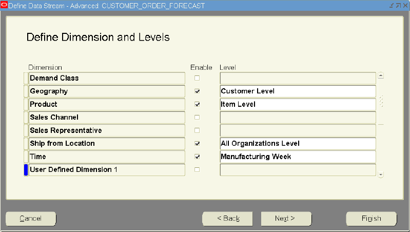

Select Next to open the Define Dimension and Levels window.
In this window, you can select the Level, such as Item or Product Category, for each Dimension at which the information exists in the data stream. The levels can only be selected if the checkbox, Data at Fixed Levels in the Define Characteristics window (in Step 3) is checked. Select the Enable checkbox to activate a dimension for the data stream.
In our example, select the Enable boxes for Geography, Product, Ship From Location, and Time Dimensions. You can then select a level for each of the chosen Dimensions.
This functionality is not applicable for chaotic data and is optional for the data at fixed level. If you do not select a level here, the system assumes the level to be the same as that of the first record that it encounters at the time of data collections.
In our example, select the following level values for the Geography, Product, Ship From Location, and Time dimensions respectively: Customer Level, Item Level, All Organization Level, and Manufacturing Week.

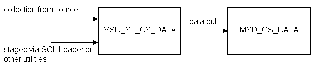

The definition process for the flexible data stream is complete. The flexible forecast data stream appears on the Select Data Definition window, the first window with which the flexible data stream definition process started (in Step 2).
Now the data needs to be staged in the staging table, MSD_ST_CS_DATA in the Demand Planning Server, as the Source of Data was selected as Interface in Define Characteristics window (in Step 3). For details on the format suitable for this staging table, see: Attributes of Staging and Fact tables. Generally, the data may not be available for all columns shown in the format and some columns may be empty. For the customer forecast in this example, assume that the information is available only for the following columns:

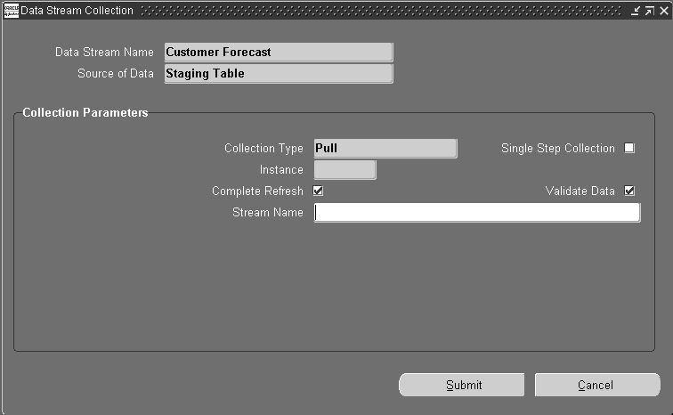

The data that has been loaded in the staging tables need to be pulled in to the Fact Table, MSD_CS_DATA using a preseeded Pull program. To perform this, select Collections > Pull Data > Custom Data Stream. Select a Data Stream from the Find window to open the Data Stream Collection window.
Collection Type: set to Pull. This program moves data from the staging tables to the fact tables.
Single Step Collection checkbox: is for information only. It appears as checked if you have specified Yes for the profile, MSD_ONE_STEP_COLLECTION. The single step collection means that you want to bring the flexible data directly in to the Oracle Demand Planning fact tables rather than bringing the data first in to the staging tables and in the second step, pulling the data in to the fact tables.
Instance: identifies which source instance to collect the data from.
Complete Refresh checkbox: if the Complete Refresh box is checked, the previously collected data are deleted from the staging or fact tables, depending on the tables into which you brought the data.
Validate Data checkbox: is always checked and is not editable for pulling the data in to the fact tables or when the single step collections are performed. The data are always validated at the time of pulling into the fact tables.
Stream Name: it is possible to bring in only one individual data stream by specifying the Data Stream Name, such as FCC1 for Forecast for Customer 1. If this field is left blank, all the data pertaining to the Customer Forecast data stream definitions exist.
Select Submit to run the data pull concurrent program.
The collection process for the flexible data stream is complete. For details, see: Uploading Flexible Data Streams.

The following diagram explains the process of uploading the data into Oracle Demand Planning after the flexible stream has been defined.
Data can be staged into the staging table, MSD_ST_CS_DATA by using SQL*Loader or other utilities. Once data has been staged, you must run the Custom Data Pull program. This pull program pulls valid rows into the fact table, MSD_CS_DATA while invalid rows remain in MSD_ST_CS_DATA. This process was explained earlier in the User Procedure section (in Step 12).
