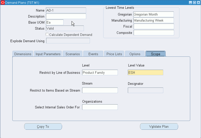

A demand plan is a group of parameters that defines both the inputs and outputs of the demand planning process as well as the dimensional levels along which the demand analysis is to occur.
Though each Demand Plan is defined for an organization, it is global and is not owned by that organization.

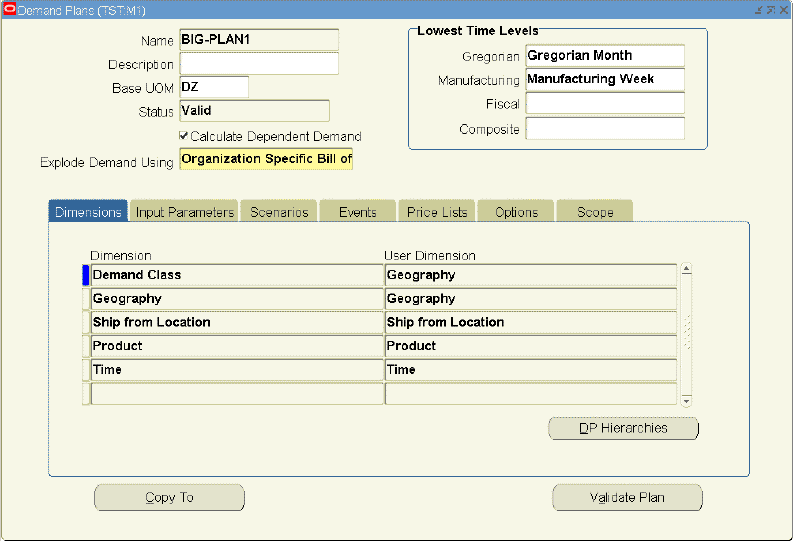

You can associate up to four User Dimensions with a Demand Plan. The remaining Demand Planning Dimensions can be collapsed into other User Dimensions. Although you cannot view more than four User Dimensions at one time, this collapsing allows you to toggle between them. For details about defining user dimensions, see: Flexible Data Stream User Procedures.
There may be situations where different units of measure exist for items within the same product family. This makes it extremely difficult to determine what the forecast should be at an aggregate level when there is no common unit of measure. The Base UOM field provides a method to change the units for all items within a higher level of aggregation to a common unit of measure as determined by the Demand Planning Administrator.
You can prioritize demands at the scenario level. Prioritizing demands at the scenario level allows you to push forecast scenarios with specified demand priorities to any downstream application that takes output of Oracle Demand Planning as input.

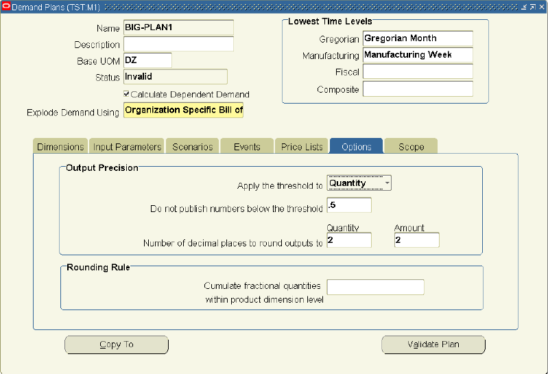

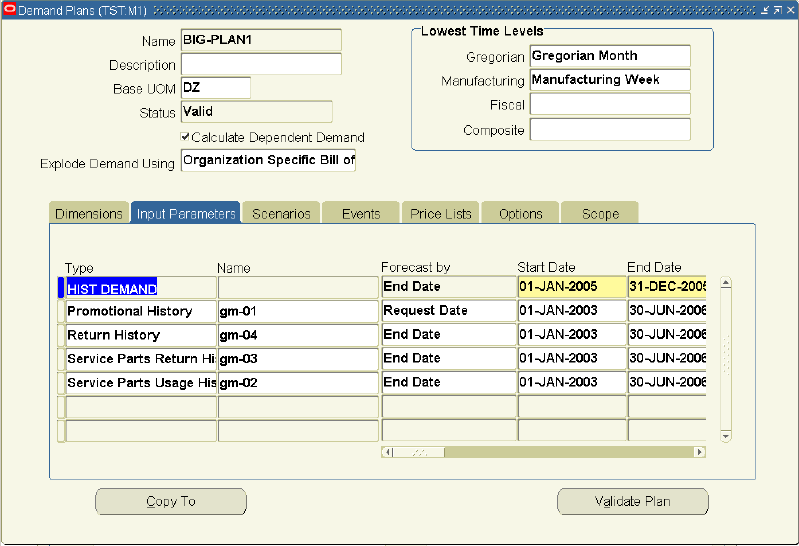

Use this window to define a Demand Plan. The bottom region of this form is used for collapsing the various demand planning dimensions to the user dimensions associated with this Demand Plan.
In this example, the name and description of the Demand Plan is BIG-PLAN1. The base unit of measure is each. The lowest time level is Manufacturing Week for the Manufacturing calendar type and Gregorian Month for the Gregorian calendar type. Five demand planning dimensions are being collapsed into four user dimensions: demand class and geography are being collapsed into the geography user dimension. Ship from location is assigned to the ship from location user dimension. Note that the other user dimensions, product and time, must always be included in a Demand Plan, and should not be collapsed with any other dimension.
Collapsing the Demand Class dimension into the Geography dimension allows you to toggle between the two dimensions. However, this setup will not allow you to analyze the data by the Demand Class and Geography dimensions simultaneously. To do that, you can collapse the Demand Class dimension to the Ship From Location dimension, instead of the Geography dimension. This will enable analysis simultaneously by the Demand Class and Geography dimensions or by the Ship From Location and Geography dimensions.
If you want to calculate dependent demand based on organization specific model bills in a demand plan, it is mandatory to have a Ship From Location dimension in the demand plan, and no other dimension should be collapsed with it.

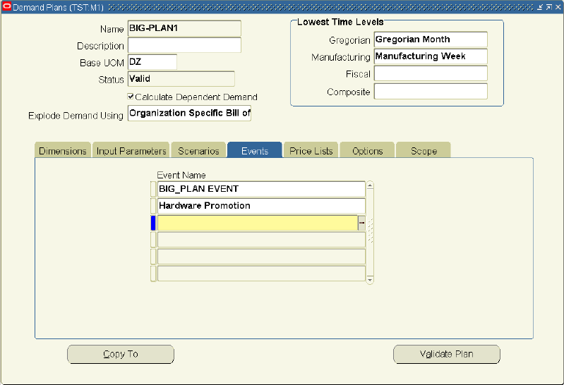

Note: Events are downloaded with four user dimensions: geography, product, time, and organization. Collapsed dimensions like demand class are downloaded as a hierarchy of one of the user dimensions (like geography). Although the event works with the collapsed dimension, the collapsed dimension name is not shown as the event qualification in the shared database.
Complete the fields in the Demand Plans window as follows:
| Field | Function | Legal Values |
| Name | Demand plan name | VARCHAR2(30) |
| Description | Detailed description for the demand plan | VARCHAR2(240) |
| Base UOM | Base UOM is the unit of measure used for aggregating at higher levels above the item level in the product dimension. The Base UOM field provides a method to change the units for all items within a higher level of aggregation to a common unit of measure as determined by the Demand Planning Administrator. This is a required field. The demand plan validation will fail if the Base UOM is not defined. The list of values for this field will be empty if you have not defined any UOM conversion. If the list of values is empty, create a UOM Conversion for your primary UOM in the source instance and recollect the data. For more details on UOM Conversion, see Multiple Step UOM Conversion. | VARCHAR2(3) |
| Status | Shows the Demand Plan status. For details, see: Validate plan. | Invalid or valid |
| Calculate Dependent Demand | If this is checked, it activates dependent demand forecast explosion process for a demand plan. This is a plan level control. Also, this is used to enable global forecasting. If this is not checked, then model bills of material, planning percentages, and dependent sales histories are not used by the Oracle Demand Planning Engine for that demand plan. | Checked or unchecked (default) |
| Explode Demand Using | If you choose Organization Specific Bill of Material, the demand plan is created for an organization specific forecast, and Demand Planning uses the organization specific model bills. If you choose Global Bills of Material, you enable global forecasting. In this case, Oracle Demand Planning uses generic model bills from the item validation organization to calculate dependent demand for all the organizations in the demand plan. Calculating dependent demand based on global model bills is optional. | Organization Specific Bill of Material (Default Value) or Global Bills of Material |
| Lowest Time Levels: Gregorian, Manufacturing, Fiscal, Composite | Shows the lowest level of time you want to track for the four available calendar types. For details, see: Lowest Time Levels for the demand plan. | Lookup Values: Gregorian: Year, Quarter, Month, and Day. Manufacturing: Period, Week, and Day. Fiscal: Year, Quarter, Month, and Day. Composite: Year, Quarter, Month, Week, and Day. |
| Dimension (tabbed region) | The Dimensions associated with this Demand Plan. | Lookup Values |
| User Dimension (tabbed region) | The collapsed Dimensions available for the Demand Plan. | Lookup Values |

Logon to the Demand Planning System Administrator responsibility.
In the Navigator, select Demand Plans.
The Demand Plans window appears.

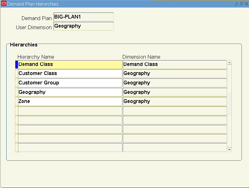

Now, the next step is to associate hierarchies with each dimension in the demand plan. At least one hierarchy needs to be assigned for each of the dimensions. For example, for the Product dimension, you can choose the Product Family hierarchy or the Product Category hierarchy or both.
This section describes demand plan hierarchies.
Choose the Demand Plan System Administrator responsibility.
In the Navigator, choose Demand Plans.
The Demand Plan window appears.
Select DP Hierarchies to open the Demand Plan Hierarchies window.
Select hierarchy names for the dimension. Use this window to associate hierarchies with a Demand Plan. You can select only the hierarchies that belong to the demand planning dimensions that are collapsed into the user dimensions for this Demand Plan.
In this example, hierarchy names are being associated with the geography user dimension for the Demand Plan.
Complete the fields in the Demand Plan Hierarchies window as follows:
| Demand Plan | Demand Plan Name. | VARCHAR2(30). |
| User Dimension | The User Dimension defined from the Demand Planning Dimensions for the Demand Plan. | From selected dimension in the Oracle Demand Planning window. |
| Hierarchy Name | Name of the Hierarchy. | List of Values. |
| Dimension Name | Demand Planning Dimension associated with the Hierarchy Name. | Populated automatically. |

Choose the Demand Planning System Administrator responsibility.
In the Demand Plans window, select the Input Parameters tab to open the Input Parameters window.
In the Input Parameters window you can specify a historical or future date range depending on the type of input parameter that needs to be uploaded into Demand Planning Engine.
Complete the fields in the Input Parameters window as follows:
| Type | Type of Input Parameter. | List of Values show all the preseeded and custom data streams. |
| Name | Name of the input parameter. For example, forecast name for the input manufacturing forecast, or the forecast name for the input scenario. | VARCHAR2(240). |
| Forecast by | If there are multiple dates in the input parameter, select which one should be used. Specifically, the Booking history, Booking history - booked items, Shipment history, Shipment history - shipped items, Constrained forecast, Order forecast, Order backlog, Material usage history - planned maintenance, Material usage history - unplanned maintenance input parameters collect multiple dates. | Different types of dates available for different input parameters. Types include: booked, promised, request, scheduled arrival, scheduled ship, shipped, receipt, ship, and schedule date. Using arrival date gives you the ability to: view, analyze, and forecast data based on the scheduled arrival date. It incorporates delivery performance in the planning process. Also, it allows for the consumption of the forecast and plan supplies by scheduled arrival date in Oracle Advanced Supply Chain Planning. |
| Start Date | Start Date for the Input Parameter. | DATE |
| End Date | End Date for the Input Parameter. | DATE |
| Input Demand Plan Name | Applicable for input scenarios only when a forecast from some other demand plan is fed to this demand plan. | The value that appears is based on what you select for the parameter name. |
| Input Scenario Name | Applicable for input scenarios only when a forecast based on some other scenario is fed to this demand plan. | The value that appears is based on what you select for the parameter name. |
| Quantity Used | If there are multiple quantities in the input parameter, select which one should be used. This is especially relevant for the input manufacturing forecast. | The list of values for the input manufacturing forecast are: 1. Original Quantity and 2. Current Quantity. |
| Amount Used | If there are multiple amounts in the input parameter, select which one should be used. | If an input parameter has several amounts, all the values show up in the list of values. No seeded data stream has multiple amounts. |
| Forecast Used | This is specific only to the Input Scenario Name. This field is not used any more, and all the forecasts are treated as an Overridden forecast. | Lookup Values: 1 = Overridden Forecast and 2 = Baseline Forecast. |
| View Name | This is an optional field for all the Input Parameters you can use to write your own view to filter and group the fact data so that only the relevant information is uploaded into the Demand Planning Engine. However, the View Name that you enter must have view structure similar to MSD_CS_DATA_V column. For details about the list of columns for MSD_CS_DATA_V, see: Control file. | VARCHAR2(30). For custom fact views, the format should be similar to CS_DATA_V. |
| Allocation / Aggregation Stream Type, Name, and Period | These three fields are used to specify some other data stream as a basis of aggregation or allocation of data for the input parameter. Period is applicable for Average Weights allocation function. | If the input parameter has been so specified as to base the allocation and aggregation values on another data stream, all the data streams show up in the list of values. For details, see: About Flexible Data Streams. |
| Exclude from Rolling Cycle | Differentiates static from dynamic input parameters. Dynamic input parameters refer to those data streams, which roll forward every cycle. Static input parameters refer to those data streams, which do not change from one cycle to another in a prespecified manner. If checked, the demand plan dates are not rolled forward for the corresponding input parameter and scenario based on the selected input parameter. If not checked and the "Roll demand plan dates forward to the next cycle" concurrent program is run, the following happens:
The demand plan and scenario names are retained, and only the forecast name (input scenarios is switched) is changed to the latest forecast version. For details, see: Automating the Planning Cycle. | Checked or unchecked |
Save the demand plan.

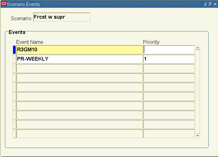

Open the Scenario Events window by selecting Events from the Demand Plan Scenario window.
Complete the fields in the Scenario Events window as follows:
| Scenario | Scenario Name | Lookup Values. This changes depending on what you selected in the Demand Plan Scenarios window. |
| Event Name | Demand Planning Event | Lookup Values. |
| Priority | User assigned. It determines the order in which the events are applied. | Number |

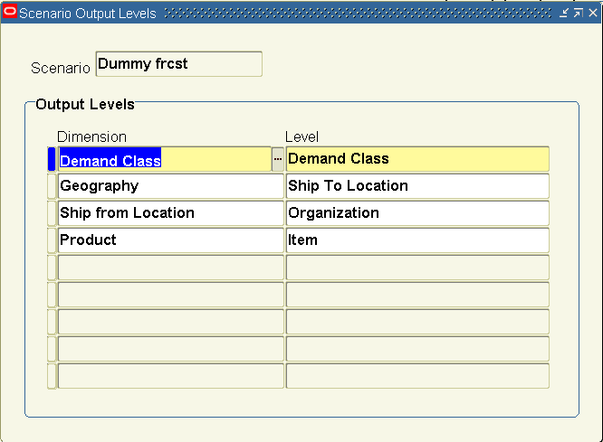

Open the Scenario Output Levels window by selecting Output Levels from the Demand Plan Scenario window.
Use this window to define the various levels in the Demand Planning Dimensions at which the forecast for this scenario is to be published from Demand Planning Engine to the Planning Server, except for the time dimension.
If you want to consume your forecast by demand class in Oracle Advanced Supply Chain Planning, you must select Demand Class as a scenario output level for that scenario.
In this example, Level Demand Class in the Demand Class Dimension, Level Ship To Location in the Geography Dimension, Level Organization in the Ship from Location Dimension, and Level Item in the Product Dimension will be the level of detail published back to the Planning Server for this scenario.
Complete the fields in the Scenario Output Levels window as follows:
| Dimension | Demand Planning Dimension | Lookup Values. |
| Level | The Level associated to the Demand Planning Dimension at which the Scenario will be published back from the Planning Engine to the Server. | Lookup Values. |
A scenario will be available to Oracle Advanced Supply Chain Planning only if Output Levels are as follows:

Events, such as promotions, new product introductions, and product phase outs can be defined in the Demand Planning Server. For details, see: About Events. The events so defined can be associated with a demand plan in two ways:
From Events in the Demand Plan window, Scenarios tab. The events associated in this manner are applied to the forecast of the corresponding scenario. For details, see: Events.
From the Events tab on the Demand Plan Window. The events so associated to a demand plan are not applicable for a specific forecast scenario but appear as independent entities in Demand Planning Engine. A Demand Planning Administrator, Demand Planner, or Demand Plan Manager working in the Demand Planning Engine may later apply one or more of these events to any measure.
In the Demand Plans window, select the Events tab to open the Events window.
Select any number of events.

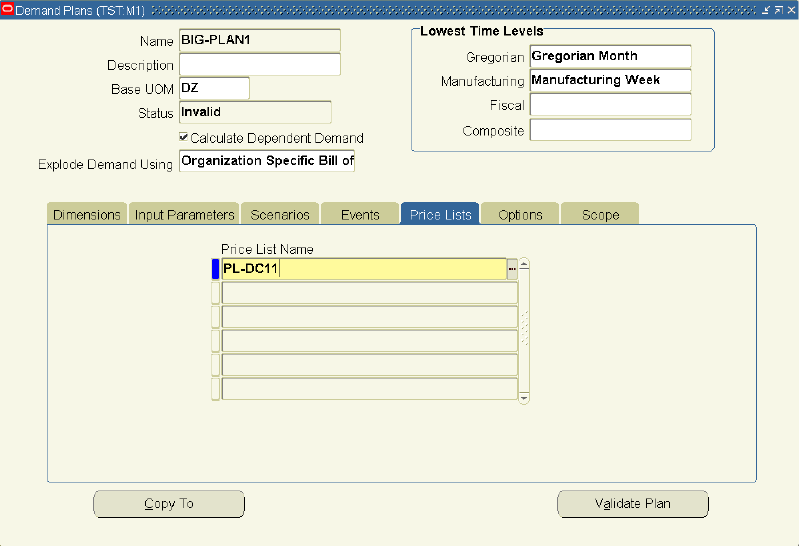

Price lists are defined in the source instance and are brought over to the Demand Planning Server using the collection programs that are provided in Oracle Demand Planning. These price lists can be associated to a demand plan in two ways:
In the Price List field from the Scenarios tab by selecting from a list of the available price lists. The price list so associated is applied to the forecast of the corresponding scenario.
From the Price Lists tab on the Demand Plan Window. The price lists so associated to a demand plan are not applicable for a specific forecast scenario but appear as independent entities in Demand Planning Engine. The Demand Planning Administrator on the Demand Planning Engine side may later apply any one of these price lists to any forecast.
In the Demand Plans window, choose the Price Lists tab to open the Price lists window.
Note: It is mandatory to specify the Price List Name while defining a demand plan. You can use wildcard characters to find the Price List Name.
Select any number of price lists.
Both quantity and amount forecast data can be uploaded from Oracle Demand Planning to the planning server for use by other Oracle applications. Oracle Demand Planning provides a threshold rounding value that can be defined in the demand plan definition form Options tab. The Demand Planning Engine does not writeback any forecast values that fall below the threshold rounding value.
You also specify the number of decimal places that you want the data to be rounded off to during the upload process.
Your specifications serve as the default display formatting settings in the Demand Planning Engine. By default, the system sets the threshold value to be 0.5 and the decimal round off factor to be 6 decimal places.
Oracle Demand Planing also provides the ability to accurately round fractional quantities to whole units. The fractional quantities, which are non-integer forecast numbers, are rounded by cumulating the fractional part of the demand across time buckets to one.
This helps in preventing under-forecasting and over-forecasting for: critical but slow moving service parts, low volume high cost products, and products with large units of measure.
After carefully considering the impact on the overall demand, you can use the rounding rule to cumulate fractions within a level in the product dimension, such as item, product family, and all products:
Item level: fractions for an item are not carried over to other items. Thus, the forecast for an item may theoretically increase by 1 and if there are 5000 SKUs, the overall demand may theoretically increase by 5000.
Product family level: fractions are adjusted across the member items of a product family and thus some demand (less than 1) may be stolen from one family member item to another. However, the forecast at the product family level will not increase by more than 1. If there are 50 product families for 5000 family members, the overall demand may theoretically increase by 50. Units of measure are not considered for rounding across items and it is assumed that all the family member items have the same unit of measure.
All products level: fractions are adjusted across all the items and thus some demand (less than 1) may be stolen from one item to another regardless of their units of measure. Though the overall forecast will not change, this may lead to moving the demand of 0.5 tons as 0.5 kilograms.
For details, see:Editing Measures about display formatting and Creating Formula Measures for how to specify rounding rules for measures.
In the Demand Plans window, select the Options tab to open the Options window.
Complete the following in the Output Precision section:
From Apply the threshold to drop-down, select Quantity or Amount.
In Do not publish numbers below the threshold field, enter the threshold value.
Enter the decimal places value in the Quantity and/or Amount fields of the Number of decimal places to round outputs to.
Complete the following in the Rounding Rule section:
In the Cumulate fractional quantities within a product dimension level field, select the product dimension level within which the fractional quantities will be cumulated for rounding rule for the demand plan. The drop-down list of values varies depending on the product hierarchies included in the demand plan.
The demand plan level rounding level is applied to all the forecast scenarios and to the selected input parameters.

You can specify the scope of a demand plan by restricting by the line of business. The demand plan is scoped by a level value in the ship from location dimension or product dimension. The levels and level values that available for selection are independent of the product or organization dimensions/hierarchies included in the demand plan.
You can also specify the scope of a demand plan by restricting to items based on the data stream. The demand plan is scoped by items in a data stream. The data streams that are available for selection are not limited to those which are included as demand plan input parameters.
For details about lines of business specific demand plans, see: Line of Business Specific Demand Plans.
In the Demand Plans window, select the Scope tab to open the Scope window.
For more information about limiting the scope of a demand plan, see Line of Business-Specific Demand Plans.
