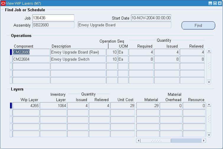

Work in Process (WIP) layer
Components issued to a WIP job are maintained in layers within the job itself. Each issue to WIP represents a separate layer within the job. In addition, each WIP layer consists of only one inventory layer initially consumed by the issue transaction. The costs of those inventory layers are held separately within the WIP layer.

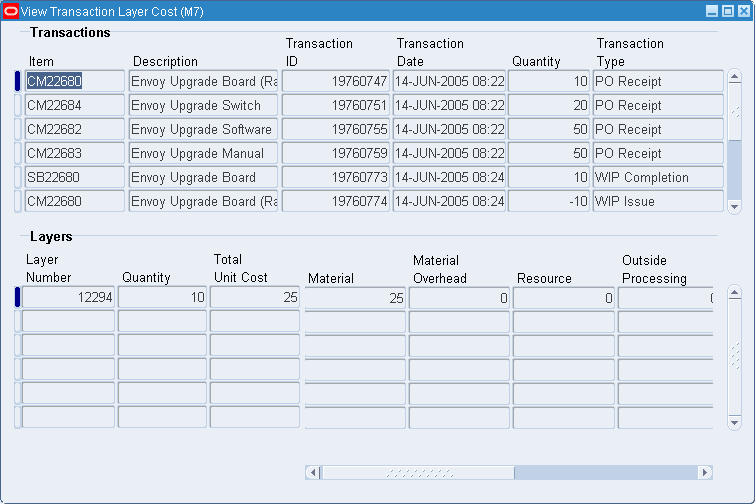

The first layer cost is cost of the first layer with a positive quantity. The layer item cost is the unit cost shared by the layer quantity. It is the average unit cost of a layer.
Layer Item Cost = layer’s acquisition cost / layer’s quantity
FIFO item cost is the weighted–average of all inventory layer costs divided by the sum of layer quantities.
For example:
| Layer 1 LQ1 = 20 ea. | LC1 = $2/each |
| Layer 2 LQ2 = 10 ea. | LC2 = $1.40/each |
FIFO Item cost = ($2*20 + $1.40*10) / (20+10) = $1.80

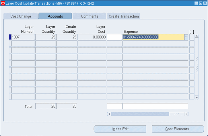

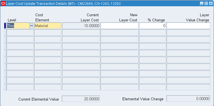

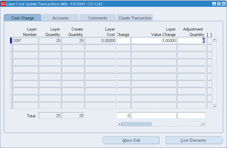

Layer cost can be updated by the user.
At any given time during an open period, you can perform a cost update to revalue your inventory. You will have the option to update the costs of an item layer by a specified amount, a percent of the selected layer’s costs, or user -entered layer costs by cost element and level.
The cost update process calculates the adjustment values for your inventory layer cost, and creates corresponding adjustment accounting entries.
Note: Just as in average costing, you must specify the items to be updated. You cannot update all items or a range of items. You can update only a single receipt layer for any given item. You can update only one layer at a time.
Both FIFO item costs and layer costs are maintained at elemental levels.
Both the FIFO item cost and the layer costs are maintained at elemental levels and by cost groups.
The FIFO item costs, which is the weighted average of layer item costs, is used for current inquiries and reports, such as inventory by sub-inventory, by category, and so on. Functionality (such as copy cost, mass edits, cost rollup) also uses FIFO item costs in its process.
The layer costs are used to value the unconsumed inventory layers and to cost transactions based on FIFO cost flow.

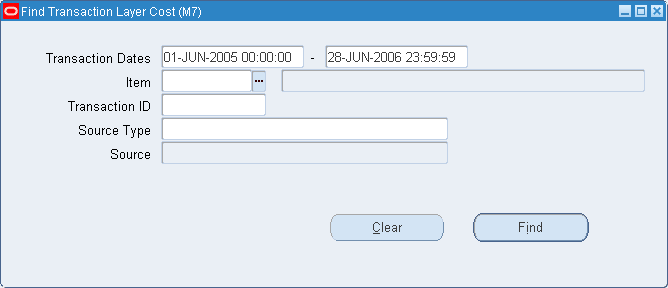

Reports by layers are available.
Most standard reports that are currently available for average costing are also available for FIFO costing. In addition, you have reports at the layer level.

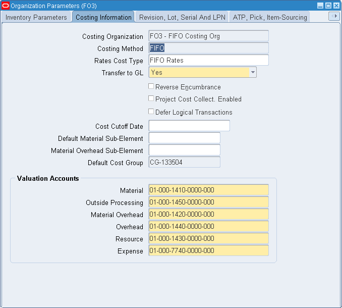

To select FIFO costing, a perpetual cost method in Organization Parameters
Navigate to the Organization Parameters window, and open the Costing Information tab.
Enter the Costing Organization.
Enter FIFO as the Costing Method from the List of Values and select OK.
Enter the Rates Cost Type, previously created.
Set Transfer Detail to GL appropriately.
Optionally, specify a Default Material Subelement account.

A WIP Component Issue transaction creates a WIP layer and a corresponding WIP layer ID. Because components are issued to WIP at specific operations, WIP layers are maintained at the job operation level.
Each WIP layer consists of one inventory layer. Depending upon the number of inventory layers consumed by the issue transaction, the WIP layers are identified by the combination of WIP layer ID and the inventory layer IDs.
Quantity and costs are maintained separately for each inventory layer within a WIP layer.
If there are no previous issues to the job and no backflush transactions, the relieved cost of a component is computed using the cost of the earliest inventory layer with positive quantity at the time of transaction.

Define subinventories and subinventory valuation accounts.
The five Valuation accounts and the default Expense account are defined at the organization level. The valuation accounts apply to each subinventory and intransit within the organization. They cannot be changed at the subinventory level under layer costing. The expense account defaults to each subinventory within the organization and can be overridden. You can choose a different valuation account for each cost element, or use the same account for several or all elements.
How you set up your accounts determines the level of elemental detail in the General Ledger and on Inventory valuation reports. See: Defining Subinventories, Oracle Inventory User's Guide.

To search for records for layer cost updates
Navigate to the Update Layer Cost window.
The Update Layer Cost search window displays for entering criteria.
In the Update Transaction Region, select a transaction date within any open period.
Select Layer Cost Update in the Type field.
Optionally, you can enter a Source type to describe the origins for transactions.
Select an expense account in the Adjustment Acct field.
In the Item region, select the item for the layer cost update.
The description, unit of measure, and cost group information defaults.
If the Project References Enabled and Project Cost Collection Enabled parameters are set in the Organization Parameters window in Oracle Inventory, you can select a cost group. See: Organization Parameters Window, Oracle Inventory User's Guide. If these parameters are not set, the organization’s default cost group is used.
Optionally, you can filter your search by selecting information in the Inventory Layer region. Select a value in the Create Transaction Type field for the transaction creating the inventory layer.
Select a value in the Transaction Source Type field for the type of transaction that created the inventory layer.
If you have a value in the Transaction Source Type field, then you can select a value in the Create Transaction Source field. This indicates the source of the transaction that created the inventory layer.
In the Create Transaction Date field, you can select a specific transaction date.
If you are searching for specific layers, then select a number or range of numbers in the Layer Number field.
The layer number comes from a layer belonging to the cost group and having positive layer quantity balance.
Choose Continue to display the results of your search on the Layer Cost Update Transactions window. Or choose Clear to remove the data entry to perform a new search.
The Layer Cost Update Transactions window has four tabbed regions for viewing and updating information:
Cost Change
Accounts
Comments
Create Transaction
To update a specific layer cost
Select the Cost Change tabbed region.
Information for your search results display in the Layer Number, Layer Quantity, Create Quantity, and Layer Cost fields.
Enter a value in one of the cost fields for that record.
New Layer Cost: Enter the new cost. The cost element and level, and the new total unit cost are automatically calculated when you save your work. Onhand inventory in all subinventories in the cost group is revalued.
Note: If you are updating the cost of an item in common inventory, then the cost of that item intransit owned by the current organization is updated.
% Change: Enter a percentage change in this field as a whole value. The item cost is updated by this percentage value. The cost element and level, and the new total unit cost are automatically calculated when you save your work. Onhand inventory in all subinventories in the cost group is revalued.
Layer Value Change: Enter the amount to increase or decrease the current on–hand inventory value. To decrease the value, enter a negative amount.
Layer inventory is revalued by this amount, and the item’s layer cost is recalculated by dividing the on–hand quantity into the new layer inventory value.
To protect each element/level from becoming negative, the cost update reduces the value to zero and distributes the remainder to the cost variance account.
Specify the adjustment quantity (Adjustment Qty) for value change.
If the layer quantity at the time of cost processing is greater than the user entered Adjustment Quantity, then the entire value change due to landed cost adjustment is applied to the layer’s inventory valuation.
If the layer quantity is less than the user entered Adjustment Quantity, then only the proportionate value change is applied to the layer’s inventory valuation. The left-off value goes to the Expense account specified by the user.
Note: Adjustment Quantity can be entered only for Layer Cost Update – Value Change transaction. Adjustment Quantity cannot be entered for Layer Cost Update – New Cost or percentage transaction.
See the Oracle Landed Cost Management Process Guide for complete details on setting up and using Landed Cost Management.
Update any changes in the other tabbed regions before saving your work. Save your work.
To update layer costs by element or level
Choose Cost Elements to display the Layer Cost Update Transactions Details window.
In the Level field, select either This Level, or Previous Level.
Select a value in the Cost Element field. Your choices are Material, Material Overhead, Resource, Outside Processing, or Overhead.
For each level or element, enter a value in one of the cost fields.
For any of the values changed, the cost element, level, and total unit cost are automatically calculated when you save your work. Onhand inventory in all subinventories in the cost group is revalued.
Layer inventory is revalued by this amount and the item’s layer cost is recalculated by dividing the on–hand quantity into the new layer inventory value. You cannot change the layer cost value by this method unless the item has quantity on–hand.

To view and enter account information
Select the Accounts tabbed region.
Enter values for the accounts you want to change.
You can update information for the following accounts: Material, Material Overhead, Resource, Outside Processing, and Overhead.
The offset to the inventory revaluation is applied to the layer cost adjustment account specified.
You can update individual account records. You can also change all records displaying by entering an account value in the Total field.
Enter an Expense account for adjustment quantity.
Save your work. For mass changes, choose Mass Edit to update all displayed records. You can use Mass Edit for adjustment quantity, and the application apportions the total adjustment quantity according to the layer quantity.
To view or add reason and reference information for transactions
Select the Comments tabbed region.
Select a reason code in the Reason field to classify or explain the transaction.
In the Reference field, you have the option to enter any descriptive text.

To view transaction layer costs
Navigate to the View Transaction Layer Cost window. The Find Transaction Layer Cost window appears.
Enter your search criteria. You can search for items by the following search criteria:
Date/date range
Item (item description is only a display field)
Transaction ID
Source type and source (the source field will be enabled only after you choose a source type)
Choose the Find button. The results display in the View Transaction Layer Cost window.
Select a transaction for an item displayed in the Transactions block of the View Transaction Layer Cost window.
For each transaction selected in the master block, you can view in the detail block all the layers created, consumed or replenished by the transaction. For each layer, you can view the elemental costs as well as the source type and the source of the transaction which creates the layer.
To view WIP layer costs
Navigate to the WIP Layers window.
Select your job by entering a valid job number or choosing from the List of Values.
Choose the Find button. The results display in the detail block of the WIP Layers window.
For a specified job number, you can view all the material operation requirements by item, by operation. When you select a component which has been issued to the job, you can view WIP layers related to the issues with the quantity issued and relieved in the detail block. Quantity relieved represents the total of components reliefs due to assembly completions and scrap transactions.
Since an issue to WIP transaction can consume multiple inventory layers, you can also view those inventory layers with their elemental costs. You can view the ID of the transaction creating the WIP layers.

You can view and update the layer cost of an item by cost element and level (this level and previous level). You can update layer costs using a percentage change, a new layer cost, or a value change. A change made to the total unit cost of an item is spread to all cost elements and levels in the same proportion as they existed before the update.
The offset to the inventory revaluation in all cases above will be booked to the Layer Cost Adjustment account(s) you specified at the time you perform the update.
Note: The layer cost update feature is intended to be used sparingly to correct a transaction costing error affecting items in subinventory. If the cost error is in WIP, the impacted quantities will need to be returned to a subinventory, corrected there, then reissued to WIP after the update has been completed.
If the adjustment increases inventory, then here are the accounting entries:
Note: The following accounts are the default accounts when layer costing is used. If Subledger Accounting (SLA) is enabled and SLA rules are customized, then the default accounts are not used.
| Account | Debit | Credit |
| Inventory Valuation accounts | XX | - |
| Adjustment account | - | XX |
If the adjustment decreases inventory, then here are the accounting entries:
| Adjustment account | XX | - |
| Inventory Valuation accounts | - | XX |

Issue component items to jobs from an inventory layer
Return components from jobs back to inventory, creating a layer
Issue or return directly by performing a WIP material transaction or by using the Inventory Transaction Interface
Backflush components using the Move Transactions and Completion Transactions windows in WIP, the Receipts window in Purchasing (for outside processing), or by using the WIP Open Move Transaction Interface
Issue transactions increase the WIP valuation and decrease the inventory valuation. Components issued to or returned from jobs are valued at the inventory layer cost in effect at the time of the transaction. Components issued to a job or returned from a job in several different transactions may have different unit costs for each transaction. If a component's unit cost is composed of more than one cost element, this elemental detail continues to be visible after it is charged to a job.
