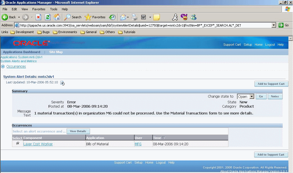

The Period Close Pending Transactions Report displays the details of the transactions preventing period close. See: Period Close Pending Transactions Report.
System alerts are posted to Oracle Applications Manager (OAM) console and are sent to subscribed administrators through workflow notifications. System alerts also gather a variety of context information about the user, the logging process, the operating system, and so on. Oracle Applications Manager tracks multiple occurrences of the same alert message to prevent duplicate notifications to be sent. System alerts require setting up the profile option FND:Debug Log Enabled to a value of ‘Y’.
For Period Close Diagnostics, system alerts are raised when costing of transactions fails in the cost manager. One alert is raised for each cost worker where transaction(s) failed costing - not for each failed transaction. Based on the subscriptions created in the application, the application notifies users through workflow notifications. You can view details by selecting an Alert Occurrence and choosing View Details. The User Interface (UI) provides drill-down capabilities for viewing transactions and transaction details.
