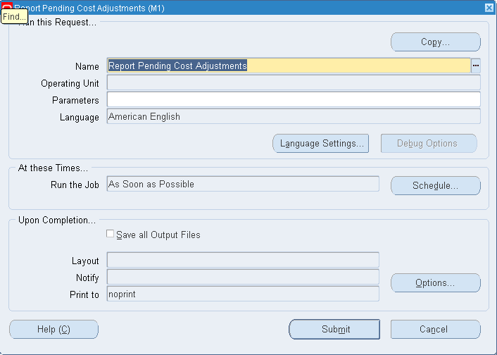

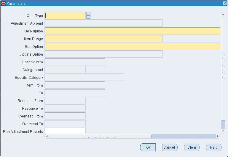

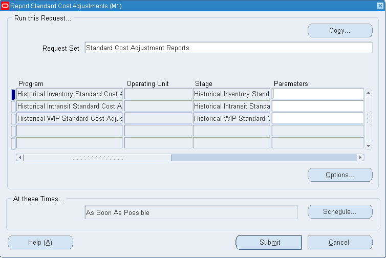

Report pending adjustments to simulate a change in standard costs. This launches two processes, one to simulate a cost update from the cost type that you specify to the Frozen cost type, and one to launch the Inventory, Intransit, and WIP Standard Cost Adjustment reports. These reports enable you to preview the changes that the standard cost update would perform for current inventory balances. These same three reports are run as part of a cost update. In this case, the reports show adjustments made to the inventory valuation by the cost update process.
To report pending adjustments
Navigate to the Report Pending Cost Adjustments window.

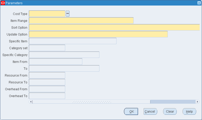

In the Parameters window, select a Cost Type.
Select an item range to perform a simulated standard cost update and generate preliminary adjustment reports for:
All items: This is the default.
Based on rollup items: Items that have Based on Rollup turned on in the Frozen cost type. This is only available if you use Inventory with Bills of Material.
Category: All items in a category you specify.
Not based on rollup items: Items that have Based on Rollup turned off in the Frozen cost type. This is only available if you use Inventory with Bills of Material.
Range of items: Range of items you specify.
Specific item: Specific item you specify.
Zero cost items: Items with zero cost in the Frozen cost type.
Select a sort option for the adjustment reports: by category, by item, or by subinventory (default).
Item costs only: This is the default.
Resource, overhead, and item costs: This is only available if you use Inventory with Bills of Material. If you use WIP, choose this option to reflect resource and overhead cost changes for actual charges to standard and non-standard asset jobs.
Do one of the following:
If you selected Specific item in the Item Range field, enter the specific item to include in the simulated cost update.
If you selected Category in the Item Range field, enter a specific category.
If you selected Range of items in the Item Range field, enter values for Item From and Item To. A simulated standard cost update is performed for all items in this range, inclusive.

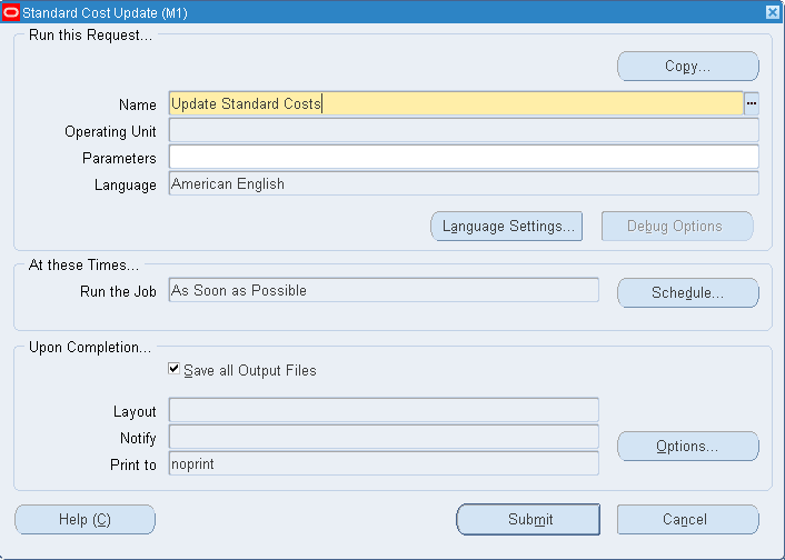

Updating pending costs to Frozen standard costs does the following:
Updates the existing standard costs with the costs created in the new cost type and creates the resulting adjustment accounting entries.
If you use Work in Process, the cost update revalues discrete job balances, creates accounting adjustments, and prints the adjustments along with the new job values in its report.

To update pending costs to Frozen standard costs
Navigate to the Update Standard Cost window.
Cost information (a set of costs for items, activities, resources, outside processing, and overhead) is copied from this cost type into the Frozen cost type.
This account is used to collect the changes in value to each item, and to automatically generate transactions that adjust your inventory accounts. Your inventory is adjusted by subinventory and elemental cost account. Your discrete WIP is adjusted by job and cost element account. The WIP accounting class defines the adjustment account for your discrete jobs.
Optionally, enter a Description.
Select an Item Range option. The options are as follows:
Category: All items in a selected category.
Select a Sort Option for the adjustment report. The options are as follows:
Item: By item
Category, Item: By category, then by item within the category
Subinventory, Item: By subinventory, then by item within the subinventory (Default)
If you selected All Items for Item Range, select an update option: either Overhead, resource, activity, and item costs, or Resource, overhead, and item costs.
Overhead, resource, activity, and item costs:
Activity and item Costs:
If you selected Specific item for the Item Range, select the Specific Item to be updated.
If you selected Category for the Item Range, do one of the following:
Select a Category Set. The default is the category set defined for the costing functional area.
Select a specific category.
If you selected Range of items in the Item Range field, select beginning and ending Item From and To values. Standard costs are updated for all items in this range, inclusive.
Indicate whether to save details. Selecting Yes saves a snapshot of the inventory and WIP on-hand quantities cost update details. If you select Yes, then you can rerun the adjustment reports as long as you choose to maintain the details.
You can purge standard cost history to delete these details.

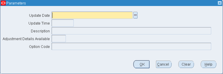

For previous standard cost updates where you chose to save the details, you can print Historical Inventory and Intransit Standard Cost Adjustment reports. If you use WIP, you can also print the Historical WIP Standard Cost Update Report. These reports show the adjustments made to inventory and WIP valuation due to the cost update.
To report cost update adjustments
Navigate to the Report Standard Cost Adjustments window.
This submits the Historical Intransit Standard Cost, Historical WIP Standard Cost Adjustment, and Historical Inventory Standard Cost reports.
In the Parameters window, enter the date and a time of a previous cost update.
Select a report Sort Option. The options are as follows:
Item: By item
Select a Cost Type.
To restrict the report to a range of items, select a beginning and ending Item.

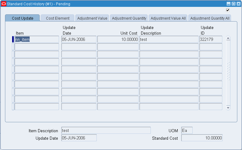

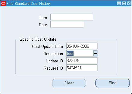

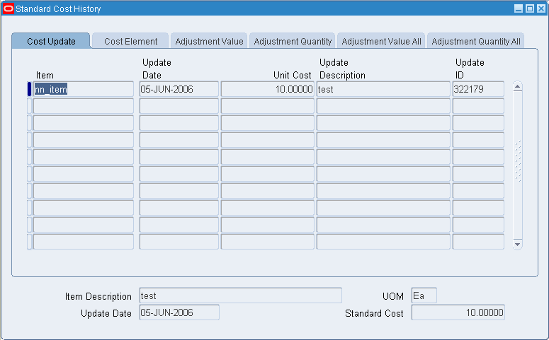

To view standard cost history
Navigate to the View Cost History window. The Find Standard Cost History window appears.
Enter your search criteria.
Choose Find to initiate the search, and choose History to view the Standard Cost History window.
The Standard Cost History window lists item cost updates. There are four tabbed regions: Cost Update, Cost Elements, Adjustment Values, and Adjustment Quantity. The Adjustment Values and Adjustment Quantity tabbed regions are available for the current organization. They are available for all organizations if you are in the costing master organization and there are child organizations that point to the master for cost information.
The Cost Update tabbed region displays the update date, the unit cost, the update description, and the update ID.
The Cost Elements tabbed region displays cost element information.
The Adjustment Values tabbed region displays the update date, the inventory and intransit adjustment values, and, if you use WIP, the WIP adjustment value.
The Adjustment Quantity tabbed region displays the update date, the inventory and intransit adjustment quantities, and, if you use WIP, the WIP adjustment quantity.

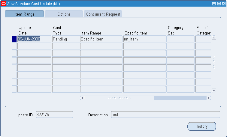

To view a standard cost updates
Navigate to the View Standard Cost Update window.
Enter information by which to find a previous standard cost update to view.
Choose the History button to view previous standard cost update requests.

The standard cost update process revalues standard and non-standard asset discrete jobs and updates pending costs to frozen standard costs. Repetitive schedules and non-standard expense jobs do not get revalued by the cost update.
The cost update creates accounting transactions by job and cost element valuation account. Each standard and non-standard asset discrete job is updated using the following formula:
| Standard cost update adjustment = [new costs in (material, resource, outside processing, and overhead charges) - new costs out (scrap and assembly completion charges)] - [old costs in (material, resource, outside processing, and overhead charges) - old costs out (scrap and assembly completion charges)] |
If the result of the cost update is an increase in the standard cost of the job, here are the accounting entries for a cost update transaction:
| Account | Debit | Credit |
| WIP accounting class valuation accounts | XX | - |
| WIP Standard cost adjustment account | - | XX |
If the result of the cost update is a decrease in the standard cost of the job, here are the accounting entries for a cost update transaction:
| WIP Standard cost adjustment account | XX | - |
| WIP accounting class valuation accounts | - | XX |
When the cost update occurs for open jobs, standards and WIP balances are revalued according to the new standard, thus retaining relief variances incurred up to the date of the update.
