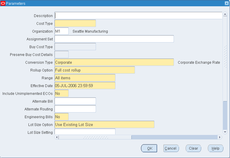

To submit a supply chain rollup request
Navigate to the Supply Chain Cost Rollup Request window.
In the Name field, select a request type option to display the Parameters window. Your choices are:
Supply Chain Cost Rollup - No Report: Rolls up costs and commits them to the database; does not print a report.
Supply Chain Cost Rollup - Print Report: Rolls up and updates costs, creates a report.
Temporary Supply Chain Cost Rollup - Print Report: Rolls up costs but does not update them, creates a report.
In the Parameters window, optionally enter a Description. This can be any descriptive text referencing this request.
Select a value in the Cost Type field.
Cost type determines how the rollup is performed. If an item does not already have cost information in this cost type, costs from the organization default cost type are used. If costs do not exist in the default cost type, then costs from the current organization's valuation cost type are used.
Note: Every time the Supply Chain Cost Rollup program is generated, costs are overwritten from previous rollups for the cost type specified.
See: Defining Cost Types.
Use the Organization and Range fields to specify the list of the top level assemblies to roll up.
Your choices are to use the current organization, or leave this field blank:
If you select the current organization, then the top level assemblies are rolled up from this organization.
If the field is blank, then the top level assemblies are from all organizations are rolled up.
For example, if the Range field is specified as All items, and the Organization field is specified as the current organization, then the rollup is performed with all items, from the current organization, as the top level assemblies.
Optionally select a value in the Assignment Set field.
Once you have defined your sourcing rules and bills of distribution, you assign them to particular items and/or organizations. These groupings are called assignment sets. This is where sourcing strategies are defined for a particular supply chain network. See: Setting up the Supply Chain, Oracle Advanced Planning User's Guide..
If you selected an Assignment Set, select a Buy Cost Type.
If you specified a sourcing rule, all the costs defined in Buy Cost Type are summed in the material cost. For example:
If both the destination and buy cost types are set up as Pending, the process searches for pending costs.
If there are no pending costs, the process then searches for default cost type.
If there are no default costs in the current organization, the process then searches for the current organization's valuation cost type. See: Defining Costing Information, Oracle Inventory User's Guide.
For configure to order items, select the value for the CTO Cost Type defined in the profile option, BOM:Buy Cost Type for Configurations. See: Configuration Item Cost Rollup, Oracle Configure to Order Implementation Manual.
In the Preserve Buy Cost Details field, indicate if you want the details of the item costs saved. You choices are Yes or No.
If an assignment set is specified in the rollup, then all costs defined in the Buy Cost Type are summed into this level of material cost. This parameter enables you to preserve the buy cost details for elemental and subelemental visibility.
Select a Conversion Type from the list of values. This is the currency conversion type used if currency values need to be converted across organizations.
Select a Rollup Option. Your choices are:
Full cost rollup: Performs a bill of material explosion for assemblies, and then builds the cost of assemblies starting with the lowest level, and works up the structure to top level assemblies.
Single-level cost rollup: Assigns new standard costs to the top assembly, but not to the lower-level assemblies.
Select the Range of items to roll up.
Your choices are: All items, Category, Range of items, Specific item, or Zero cost items.
If you select Zero cost items, the rollup includes zero cost items in the current and the default cost types that have the attribute, Based on Rollup, enabled.
Note: Inactive items are not rolled up unless you select a Specific Item that is inactive.
If you selected a request type that prints a report, then select a report type. Your choices are:
Consolidated: Prints the Supply Chain Consolidated Bill of Material Cost report, which lists total quantities of each component used in the parent assembly regardless of level.
Detail Indented: Prints the Indented Supply Chain Bill of Material Cost report, which lists detailed cost structure by level.
See: Supply Chain Consolidated Bills of Material Cost Report, and Supply Chain Indented Bills of Material Cost Report
If you selected a request type that prints a report - in the Material Detail, Material Overhead Detail, and Routing Detail fields, then indicate if you want these fields to display on the report. Your choices are Yes or No.
If you select Yes, then Material, Material Overhead, and Routing detail subelements display on the report.
Note: If you select No, then you limit the amount of subelement detail and reduce the size of the report.
If you selected a request type that prints a report, then enter the maximum report number of levels to display on the report.
For example, if your assembly had 20 levels and you enter 5 in this field, then the costs for levels 1 through 5 are detailed. The costs for levels 6 to 20 are summarized as previous level costs. The default is the maximum bill of material levels value. See: Defining Bills of Material Parameters, Oracle Bills of Material User's Guide.
Enter the Effective Date and time to determine the structure of the bill of material to use in the cost rollup. You can use this to roll up historical and future bill structures using current rates and component costs.
Indicate whether to Include Unimplemented Engineering Change Orders ECOs in the rollup. See: Changing the ECO Status, Oracle Engineering User's Guide.
Optionally, enter an Alternate Bill name for the assembly to roll up, if applicable, for the Range you selected.
For example, if an alternate bill is specified, all items in the range are still rolled up:
The items having an associated bill with that name are rolled up using that bill.
The items that do not have an associated bill with that name will continue to be rolled up using the primary bill.
See: Primary and Alternate Bills of Material, Oracle Bills of Material User's Guide.
Optionally, enter an Alternate Routing name for the assembly to roll up, if applicable, for the Range you selected.
For example, if an alternate routing is specified, all items specified in the range are still rolled up:
The items that do have an associated routing with that name are rolled up using that routing.
The items that do not have an associated routing with that name will continue to be rolled up using the primary routing.
See: Primary and Alternate Routings, Oracle Bills of Material User's Guide.
Indicate whether to include Engineering Bills in the cost rollup. If you select Yes, assemblies with engineering bills are rolled up in addition to the regular assemblies.
You can select lot size parameters in the Lot Size Option field. Select a lot size multiplier in your cost computations. Your choices are:
Use Existing Lot Size
Specify Lot Size
Use Factor of Standard Lot Size
If the Lot Size Option field has the value of Specify Lot Size, or Use Factor of Standard Lot Size - you can enter a numeric value in the Lot Size Setting field.
Note: When using either the Specify Lot Size or Use Factor of Standard Lot Size, if Lot Size Setting is not specified, or the Standard Lot Size is not specified, then the application uses the existing lot size.
Specify items to roll up:
If you selected Specific Item in the Range field, select an item.
If you selected Category in the Range field, select either a category set or a specific category.
If you select a category set, item costs are rolled up for items associated with this category set. The default is the category set defined for your costing functional area.
If you selected Range of items, enter From and To values to specify the range of items for which to roll up costs.
Choose OK to display the Request window.
Choose Submit to process the rollup.

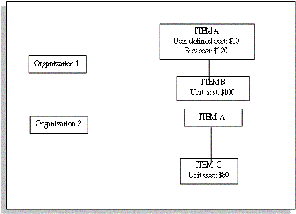

Example of Process Flow for Supply Chain Cost Rollup
A bill of material structure is defined at Organization 1 and Organization 2. Before the Supply Chain Cost Rollup program is submitted:
Item A (at Organization 1) has a user defined cost of $10, and a buy cost defined as $120.
The unit cost for Item B is $100.
The Unit cost for Item C (at Organization 2) is $80.
The Transfer Charge Type percentage is defined as 10 percent when transferring from Organization 2, to Organization 1. The sourcing rule is defined for Item a in organization 1 as the following:
| Source | Rank | Percentage |
| Make at Organization 1 | 1 | 50 |
| Transfer from Organization 2 | 1 | 25 |
| Buy | 1 | 25 |

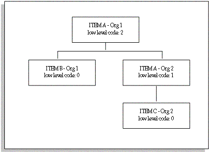

When a full cost rollup is submitted for item A, the following process flow occurs:
A supply chain bill of material explosion is performed and the low level codes are assigned, The program starts with Item B in Organization 1, and Item C in Organization 2 - and then rolls up the cost for Item A in Organization 2. Then it completes by rolling up and merging costs for Item A in Organization 1.
The costs of Item A at Organization 1 are calculated with a total unit cost of $112. The following information is used::

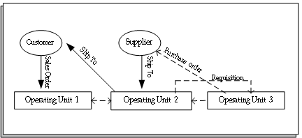

The following flow of activities demonstrates this scenario for complex intercompany invoicing:
Operating Unit 1 (OU1) receives a sales order from a customer.
Order price is $25.
The material is shipped to the customer from Operating Unit 2 (OU2) warehouse.
OU2 does not stock the material. Global Agreement Rules dictate that the item is procured by Operating Unit 3 (OU3).
OU2 creates a requisition to OU3 to purchase the material.
OU3 creates purchase order to the Supplier.
Purchase order price is $10.
The Supplier ships the material OU2:
OU2 has the physical receipt of the material.
OU3 creates PO Receipt transaction because it purchased the material.
OU3 also creates a shipping transaction to OU2.
The transfer price is $15
OU1 created the sales order, and performs the shipping transaction to the customer.
The material is physically shipped from OU2
A transfer transaction is created from OU2 to OU1,at a Transfer price of $20.
A receipt transaction is created in OU1.
The accounting for this example for intercompany transactions follows this flow:
Operating Unit 3
Receipt Transaction
| Receiving Processor | Debit | Credit |
| OU1 Clearing | 10 | - |
| Accrual | - | 10 |
| Cost Processor | Debit | Credit |
| OU2 Inventory | 10 | - |
| OU1 Clearing | - | 10 |
| Invoicing | Debit | Credit |
| Intercompany Receivable | 15 | - |
| Intercompany Revenue | - | 15 |
| Intercompany Cost of Goods (COGS) | 10 | - |
| OU2 Inventory | - | 10 |
Operating Unit 2
Receipt Transaction
| OU1 Clearing | 15 | - |
| Intercompany Accrual | - | 15 |
| Intercompany Invoicing | Debit | Credit |
| Intercompany Accrual | 15 | - |
| Intercompany Payable | - | 15 |
Deliver Transaction
| OU1 Inventory | 15 | - |
| OU1 Receipt | - | 15 |
Shipping Transaction
| Intercompany Receivable | 20 | - |
| OU1 Intercompany Revenue | - | 20 |
| Intercompany COGS | 15 | - |
| OU1 Inventory | - | 15 |
Operating Unit 1
| OU3 Inventory | 20 | - |
| OU1 Inventory | - | 20 |
| Intercompany Accrual | 20 | - |
| Intercompany Payable | - | 20 |
| OU3 COGS | 20 | - |
| OU3 Inventory | - | 20 |
| Accounts Receivable Invoicing | Debit | Credit |
| OU3 Receivable | 25 | - |
| OU3 Revenue | - | 25 |
