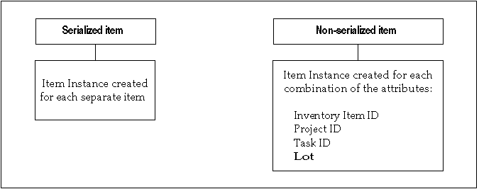

The flow of purchase order receipts starts with the creation of a purchase order. Items against the purchase order are then received into the project. The Oracle Asset Tracking purchase order receipt package validates the receipt data against the Oracle Install Base repository and creates or updates the repository instance depending upon the physical attributes of the instance.
For non-serialized items, physical attributes are combinations of values for Inventory Item, Project ID, Task ID, and Instance Status. If any values of these attributes are different, then the application creates a new instance in Oracle Install Base. If these attributes match, then the application adds the new receipt to the same instance.
For serialized items, Oracle Install Base always creates a new instance.
The following figure shows the factors that determine how an item instance is created or updated during the Oracle Projects transactions which affect Oracle Asset Tracking.
Item Instance Processing in Oracle Projects Transactions
