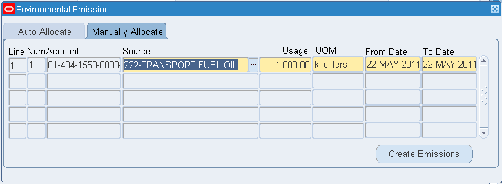

To Enter environmental data during post-processing of invoices
You can enter environmental data for validated invoices that contain GHG accounts or environmental items for which environmental data entry was skipped during validation. You can query for a specific invoice using the Invoice Overview window and enter the environmental data using the Environmental Emissions window. You can use the option of source usage data entry when the tasks of invoice data entry and environmental data entry are clearly separated and assigned to different individuals for business reasons. For example, an organization can have a Payables Clerk who validates an invoice and a Sustainability Officer who enters environmental data later in the business process.
Navigate to the Invoice Overview window using the Process Unaccounted Invoices menu option. Use the Find Invoices window to search for an invoice. This brings up the invoices that are in the status "Validated" with at least one distribution account mapped to an Environmental Organization and do not have any Emissions recorded. Refer to the Oracle Payables User’s Guide for detailed information on finding and viewing invoice details.
Select Create Environmental Transactions from the Tools menu. The Environmental Emissions window appears. The Autoallocate tab displays by default.
If you want the application to automatically prorate the emission source usage across relevant distributions based on their financial distributions, then perform the following steps:
View the Emission Source. This field defaults to the source involved in the transaction. The UOM field defaults to the UOM defined for the source. You can edit the UOM field. Refer to the “Defining Sources” topic of the Setting Up chapter for more detailed information on setting up sources. Required.
Enter the Usage quantity as the quantity of the emission source used. The UOM field defaults to the base unit of measure for the emission source. You can also select an alternate unit of measure from units within the same Unit of Measure Classification. Required.
View the From Date field that defaults to an invoice or a receipt date depending on the Parameters that you set up for the operating unit. You can edit this field. You cannot change this date after the emission usage is saved. Refer to Setting Up Parameters for more information.
View the To Date field that defaults to an invoice or a receipt date depending on the Parameters that you set up for the operating unit. You can edit this field. You cannot change this date after the emission usage is saved.
Click Create Emissions. The application autoallocates the usage on a pro-rate basis over the total of the invoice general ledger distributions.
If you want to allocate the emission source usage manually to distribute the emission source usage across specific organizations mapped to specific invoice distribution accounts, then perform the following steps:
Click the Manually Allocate tab.
Enter the Line, Number, and Account details of the specific general ledger lines that you want to allocate the source usage to.
The Emission Source displays but can be edited. The LOV displays a list of emission sources that you define as per the setup. Refer to Defining Sources for more detailed information on setting up sources. Required.
View the From Date field that defaults to an invoice or a receipt date depending on the Parameters. You can edit this field. You cannot change this date after the emission usage is saved.
View the To Date field that defaults to an invoice or a receipt date depending on the Parameters. You can edit this field. You cannot change this date after the emission usage is saved.
Click Create Emissions. The application allocates the usage over the specified general ledger lines.

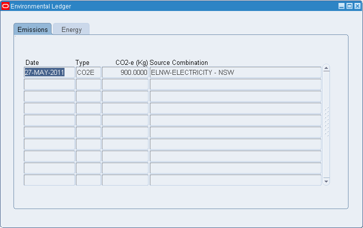

You can view the emission details for a transaction by day and by emission type and the emission factors used in the emission calculations using the Environmental Ledger window.
To view the emissions Ledger
Navigate to the Environmental Emissions window.
Select the transaction for which you want to view the emissions details. Click View Ledger. The Environmental Ledger window appears
The following fields display:
In the Emissions tab, the Emission Date is the effective date for the emission transaction.
Gas is the name of the gas emitted.
CO2-e is the carbon equivalent for the amount of gas emitted and is expressed in Kgs.
Emission Factor is the factor used in the emission calculations.
In the Energy tab, Emission Date is the effective date for the emission transaction.
Type is energy source type.
Energy (GJ) is the energy associated with the source consumed in the transaction and is expressed in gigajoules.
Close the window.

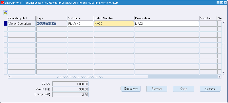

To enter environmental transaction batches
Navigate to the Environmental Transaction Batches using the Enter Transactions Batches menu option. The Environmental Transaction Batches window appears. The Operating Unit that owns the facility or organization where the source is used displays.
Select a batch type in the Type field. Examples are:
Adjustment: This batch type is used to identify transactions as adjustments. An adjustment is required when companies want to make a change to the emissions footprint, but record the event from an audit point of view.
Estimate: This batch type is used to categorize transactions as estimates. This is useful when legislations allow organizations to estimate the emissions for small facilities in their operations. This is also useful for companies to put advanced estimates to potentially build a view of the potentials emissions. These estimates can be reversed at a later stage as actual emissions become available.
External Invoice: This batch type enables the Supplier and Supplier site fields. This allows the entry of information for external invoices not being processed through the internal Accounts Payables. This can be used for sub-contractor invoices.
Item: This batch type allows the entry of batches that perform inventory issues without assets or issues to a specific asset. If you select the Item batch type, then the Item and Asset fields are enabled. You must enter an Item in the Item field, and optionally select an asset.
Misc for miscellaneous emissions: This batch type can be used for general transaction batches that require the minimum amount of information to generate the emissions records.
Optionally select a Sub Type for the batch. Valid options are:
Flaring for emissions due to flaring.
Fugitive for fugitive emissions.
Misc for miscellaneous emissions.
Venting for emissions due to venting of gases.
Enter an alpha-numeric number as a Batch number. Required.
Optionally, enter a brief Description for the batch.
Optionally, select a default Supplier from the LOV who supplied the goods or service. This supplier is the default supplier which initially appears on all batch usage lines
Supplier Num defaults to the number of the default Supplier selected.
Status field defaults to Unapproved when you create a batch. The status changes to Approved when you approve the batch.
Created By defaults to the name of the person who creates the batch initially.
Creation Date defaults to the date the batch is created.
Click Save.
To enter emissions for a batch, click Emissions. The Environmental Emissions window appears. Refer to Viewing Greenhouse Gas Emissions for a Transaction for a detailed description on the Environmental Emissions window.
To reverse a batch, click Reverse.
To copy a batch, click Copy.
To approve a batch, click Approve. This option is enabled only after you enter emissions for a batch. If you do not want to add further transactions to the batch, then approve the batch.
Note: You cannot edit a batch, after you approve it.
The following fields display after you enter the usage information for a batch in the Environmental Emissions window:
Usage Quantity is the source usage quantity for the selected batch.
CO2-e (kg) is the carbon equivalent of the emissions for the selected batch.
Energy (GJ) is the energy associated with the source usage for the selected batch.
To view emission details for a transaction by day and by gas and the emission factors used in the emission calculations for each transaction, select a transaction and click View Ledger. Refer to Viewing the Environmental Ledger for more information.
