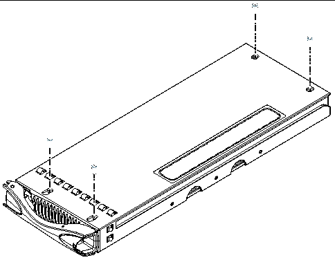

1. Remove the blade cover screws (FIGURE 1).
