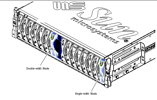

The system chassis contains 16 slots. It can hold a combination of single-width blades, double-width blades and filler panels. Double-width blades occupy two adjacent slots in the system chassis.
The existing blade or filler panel must be removed immediately prior to installing the new blade. Do not leave the blade slot empty for an extended period of time.
FIGURE 12-1 shows a system chassis containing single-width blades and a
double-width blade.

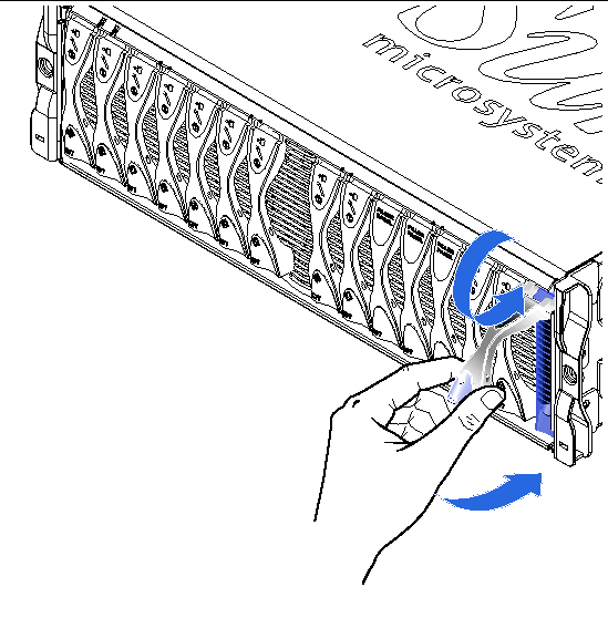

The steps in this section refer to removal of a single-width blade. The same steps apply when installing a double-width blade or filler panel.
1. If you are removing a blade, check that the blue "Ready to Remove" LED is lit.
2. Insert your finger in the pull recess located at the bottom front of the blade lever and pull gently to disengage the locking mechanism (FIGURE 12-2).
3. Pull the lever in a forward and upward motion, causing the blade lever to unlatch and eject the blade partially from the system chassis (FIGURE 12-3).
4. Pull the lever to remove the filler panel from the system chassis (FIGURE 12-4).
Support the bottom of the filler panel with your free hand while lifting the filler panel clear of the system chassis.

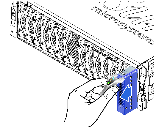

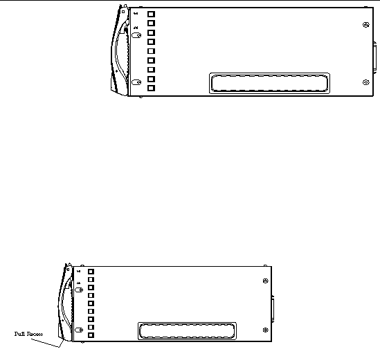

The steps below refer to installation of a single-width blade. The same steps apply when installing a filler panel or double-width blade.
1. If required, open the blade lever by inserting a finger in the pull recess located in lower portion of the blade lever and pull the lever in a forward and upward motion, causing the lever to unlatch (FIGURE 12-5).
2. Align the blade with the empty slot.
Ensure that the blade connector is facing towards the system chassis, with the hinge point of the lever mechanism at the top. Support the bottom of the blade with your free hand while lifting the blade up to the system chassis (FIGURE 12-6).
3. Insert the blade into the selected system chassis slot (FIGURE 12-6).
Caution - Ensure that the blade engages with the system chassis guidance system. Failure to align the blade correctly can result in damage to the chassis midplane or the blade connection. |
4. Gently push the blade into the slot until the blade latch ears, on top of the lever, are positioned in the chassis.
5. Close the blade lever fully by pushing it down until you feel the latch click in place.
This engages the blade with the connectors in the chassis slot (FIGURE 12-7). When you do this, the LEDs on the blade flash several times.

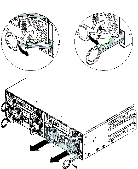

1. Check that either the blue `OK to Remove`, or amber `service required` LED is lit.
Note - Do not remove the SSC until one of these LED states is displayed. |
2. Disconnect all network and management cables from the SSC and disengage the cables from the cable management system, if necessary.

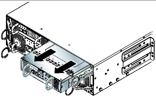

3. Squeeze the green SSC ejector lever to unlatch it, and then pull the lever towards you to disconnect the SSC from the system chassis (FIGURE 12-9).
4. Check that the ejector lever is open fully and clear of the SSC module (FIGURE 12-9).
5. Remove the SSC from the system chassis by pulling on the vertical handles attached to the back of the SSC (FIGURE 12-10).
Support the bottom of the SSC while removing the module from the system chassis.

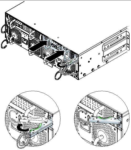

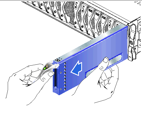

1. Align the SSC with the system chassis.
SSC connectors must face towards the system chassis and be located on the lower half of the SSC.
2. Ensure that the chassis ejector lever is opened fully and does not obstruct the chassis opening (FIGURE 12-11).
3. Slide the SSC into the empty chassis slot.
Push the SSC into the slot until the ejector lever engages (FIGURE 12-12).
4. Complete insertion by closing the ejector lever.
Check that the latch engages onto the SSC pull handle. This engages the SSC into the system chassis (FIGURE 12-13).
5. Reconnect all network and management cables to the SSC and, if necessary, place the cables in the cable management system.

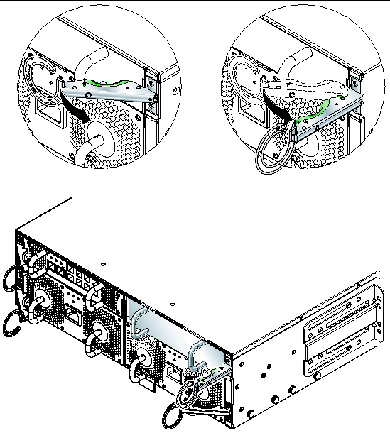

This section provides the steps required to replace a Power Supply Unit in the
Sun Fire B1600 system chassis.
Caution - Do not connect an IEC power cord to the Power Supply Unit until the PSU is installed. |
1. To disable the PSU prior to removal, at the sc> prompt, type:
where n is either 0 or 1 depending on whether you are removing PSU 0 or PSU 1.

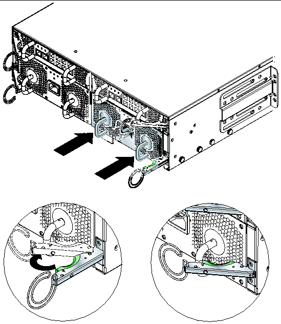

1. Check that either the blue `OK to Remove`, or amber Fault LED is lit.
Note - Do not remove the PSU until one of these LED states is displayed. |
2. Disconnect the power cable from the PSU and disengage the cable from the cable management system, if necessary.
3. Squeeze the green PSU ejector lever to unlatch it and pull the lever towards you to disconnect the PSU from the system chassis (FIGURE 12-14).
4. Check that the ejector lever is open fully and clear of the PSU module.

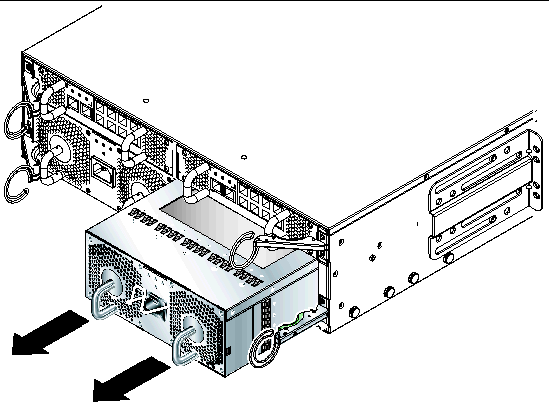

5. Remove the PSU from the system chassis by pulling on the vertical handles attached to the rear of the PSU (FIGURE 12-15).
Support the bottom of the PSU while removing the module from the system chassis.
Caution - To ensure that it remains within an acceptable range of operating temperatures the Sun Fire B1600 system chassis requires two PSUs. |
Caution - Do not install a PSU with the IEC power cord already attached. Only connect the power cord when the PSU is installed. |

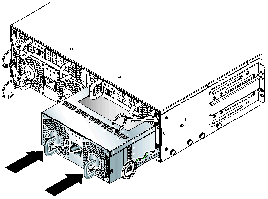

1. Correctly align the PSU with the empty PSU slot in the system chassis.
PSU connectors must face towards the system chassis and be located on the lower half of the PSU.
2. Check that the chassis ejector lever is opened fully and does not obstruct the opening to the PSU slot in the chassis.
3. Slide the PSU into the empty PSU slot in the chassis.
Push the PSU into the slot until the ejector lever engages (FIGURE 12-16). You must push the PSU firmly to raise the system flap within the system chassis.
4. Complete the installation by closing the ejector lever fully.
Check that the ejector lever engages onto the PSU pull handle. This engages the PSU into the system chassis (FIGURE 12-17).
5. Connect the power cable to the PSU.
6. Check that the green `Activity` LED is lit.

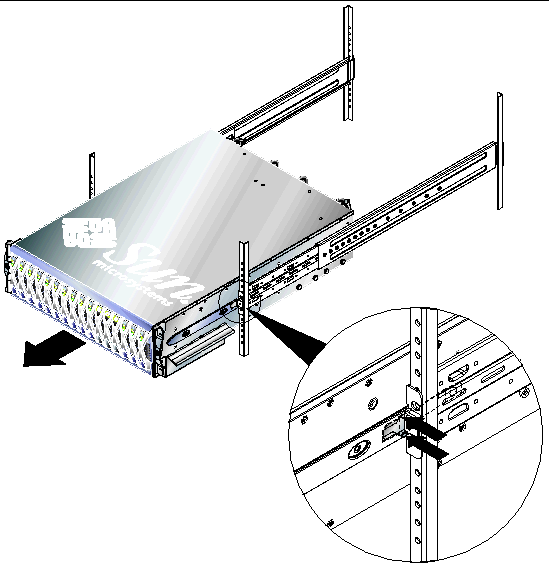

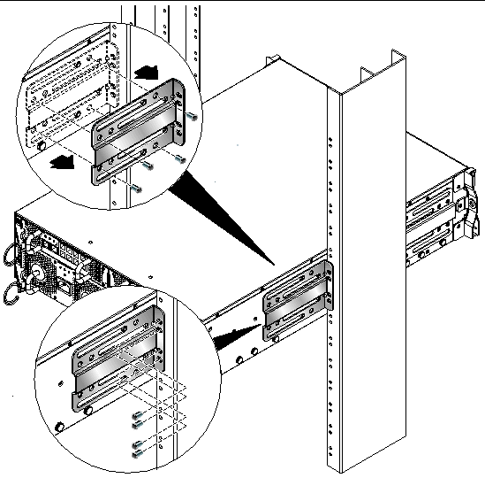

1. Unscrew the system chassis captive retaining screws.
2. Slide the system chassis out of the rack (FIGURE 12-18).
The system chassis will stop when the retaining catches positioned on the chassis runners meet the rack. You must depress the retaining catches before you can remove the system fully from the rack.

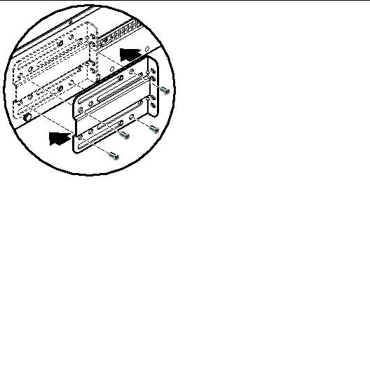

1. Remove the rear brackets from the system chassis and rack (FIGURE 12-19).
2. Detach the front brackets from the rack (FIGURE 12-20).
3. Remove the front rack bracket from the system chassis (FIGURE 12-21).
For information about installing the chassis into a rack, refer to the Sun Fire B1600 Blade System Chassis Hardware Installation Guide (Part No. 816-7614). This tells you how to install into the following racks:
