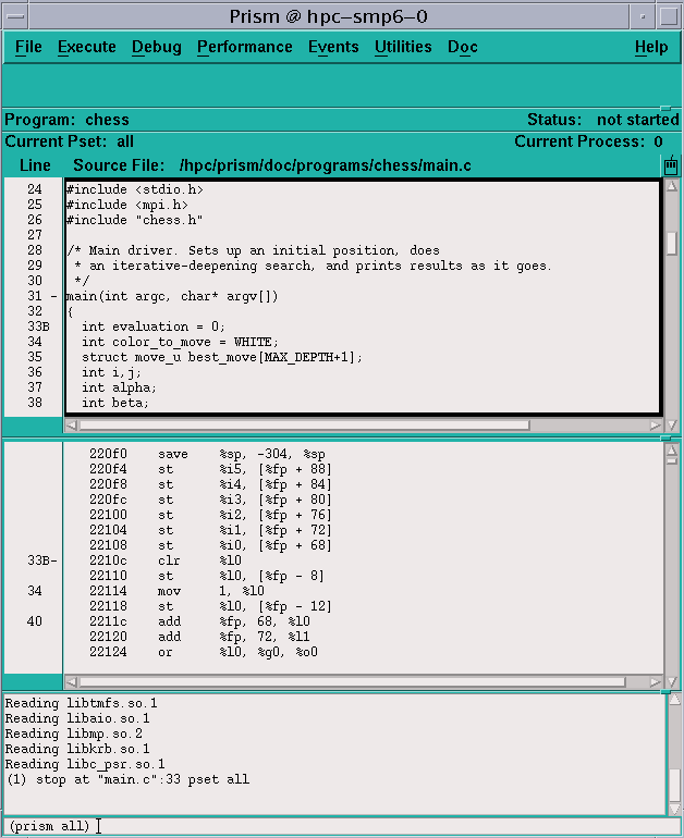

The source window displays the source code for the executable program loaded into Prism. (Chapter 3, Loading and Executing a Program describes how to load a program into Prism, and how to display the different source files that make up the program.) When you execute the program, and execution then stops for any reason, the source window updates to show the code being executed at the stopping place. The Source File: field at the top of the source window lists the file name of the file displayed in the window.
The source window is a separate pane within the main Prism window. You can resize it by dragging the small resize box at the lower right of the window. If you change its size, the new size is saved when you leave Prism.
You cannot edit the source code displayed in the source window. To edit source code within Prism, you must call up an editor; see Chapter 8, Editing and Compiling Programs.
As mentioned above, you can move through a source file displayed in the source window by using the scroll bar on the right side of the window. You can also use the up and down arrow keys to scroll a line at a time, or press the Control key along with the arrow key to move half a page at a time. To return to the current execution point, type Control-x in the source window.
To search for a text string in the current source file, issue the /string or ?string command in the command window. The /string command searches forward in the file for the string that you specify and repositions the file at the first occurrence it finds. The ?string command searches backward in the file for the string that you specify.
You can display different files by choosing the File or Func selection from the File menu; see " Choosing the Current File and Function". You can also move between files. Prism keeps a list of the files you have displayed. With the mouse pointer in the source window, do this to move through the list:
To display the previous file in the list, click the middle mouse button while pressing the left button. You are returned to the location at which you left the file.
To display the next file in the list, click the right mouse button while pressing the left button.
You can select text in the source window by dragging over it with the mouse; the text is then highlighted. Or double-click with the mouse pointer pointing to a word to select just that word. Left-click anywhere in the source window to "deselect" selected text.
Right-click in the source window to display a menu that includes actions to perform on the selected text, see Figure 2-1. For example, select Print to display a visualizer containing the value(s) of the selected variable or expression at the current point of execution. (See Chapter 5, Visualizing Data, for a discussion of visualizers and printing.) To close the pop-up menu, right-click anywhere else in the main Prism window.
You can display the definition of a function by pressing the Shift key while selecting the name of the function in the source window. This is equivalent to choosing the Func selection from the File menu and selecting the name of the function from the list; see Chapter 3, Loading and Executing a Program. Do not include the arguments to the function, just the function name.
You can split the source window to simultaneously display the source code and assembly code of the loaded program. Follow these steps to split the source window:
To split the source window:
Load a program.
Right-click in the source window to display the pop-up menu.
Click on the "Show source pane" selection in the pop-up menu.
This displays another menu.
Choose the "Show .s source" selection from the menu.
This causes the assembly code for your program to be displayed in the bottom pane of the window, as shown in Figure 2-2.
To return to a single source window, right-click in the pane you want to get rid of, and choose "Hide this source pane" from the popup menu.

The > symbol in the line-number region in Figure 2-2 is the execution pointer. When the program is being executed, the execution pointer points to the next line to be executed, for the most-active function call; or to the call site for functions higher on the stack. If you move elsewhere in the source code, typing Control-x returns to the current execution point.
A B appears in the line-number region next to every line at which execution is to stop. You can set simple breakpoints directly in the line-number region; all methods for setting breakpoints are described in " Setting Breakpoints".
A T appears in the line-number region next to a line for which Prism is tracing execution. See " Tracing Program Execution" to learn how to trace program execution.
Shift-click on B or T in the line-number region to display the event associated with the breakpoint or tracepoint. See " Overview of Events" for a discussion of events.
The display of breakpoints and tracepoints in the line-number region is slightly more complicated in MP Prism; see " Using the Line-Number Region in MP Prism".
The - symbol is the scope pointer; it indicates the current source position (that is, the scope). Prism uses the current source position to interpret names of variables. When you scroll through source code, the scope pointer moves to the middle line of the code that is displayed. Various Prism commands also change the position of the scope pointer.
The * symbol is used when the current source position is the same as the current execution point; this happens whenever execution stops.
If you right-click in the line-number window, you display the source-window pop-up menu discussed in the previous section. Right-click anywhere in the main Prism window to close this menu.
The command window is the area at the bottom of the main Prism window in which you type commands and receive Prism output.
The command window consists of two boxes: the command line, at the bottom, and the history region, above it. Figure 2-4 shows a command window, with a command on the command line and messages in the history region.
The command window is a separate pane within the main Prism window. You can resize this window (using the resize box at the top right of the window) and scroll through it. If you don't intend to issue commands in the command window, you may want to make this window smaller, so that you can display more code in the source window. If you use the command window frequently, you may want to make it bigger. If you change the size of the window, the new size is saved when you leave Prism.
Use the set $history command, as described below, to specify the maximum number of lines that Prism is to retain in the history region; the default is 10,000. For example,
set $history = 2000
reduces the number of lines to 2000.
Prism uses up memory in maintaining a large history region. A smaller history region, therefore, may improve performance and prevent Prism from running out of memory.
You type commands on the command line at the bottom of the command window. You can type in this box whenever it is highlighted and an I-shaped cursor, called an I-beam, appears in it. See Table 2-2 for a list of keystrokes you can use in editing the command line. Press Return to issue the command. Type Control-c to interrupt execution of a command (or choose the Interrupt selection from the Execute menu).
You can issue multiple commands on the Prism command line; separate them with a semicolon (;). One exception: If a command takes a file name as an argument, you cannot follow it with a semicolon, because Prism can't tell if the semicolon is part of the file name.
Prism keeps the commands that you issue in a buffer. Type Control-p to display the previous command in this buffer. Type Control-n to display the next command in the buffer. You can then edit the command and issue it in the usual way.
During long-running commands (for example, when you have issued the run command to start a program executing), you may still be able to execute other commands. If you issue a command that requires that the current command complete execution, you receive a warning message and Prism waits for the command to complete.
Commands that you issue on the command line are echoed in the history region, above the command line. Prism's response appears beneath the echoed command. Prism also displays other messages in this area, as well as command output that you specify to go to the command window. Use the scroll bar at the right of this box to move through the display.

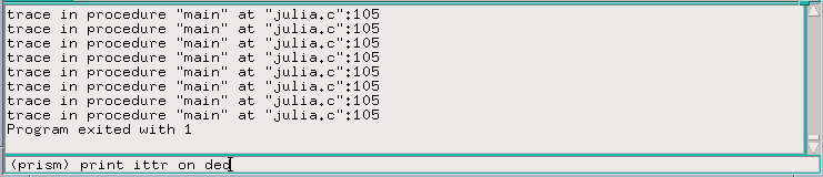

You can also redirect output of a command to a window by using the syntax on window, where window can be:
command (abbreviated com) - This sends output to the command window; this is the default.
dedicated (abbreviated ded) - This sends output to a window dedicated to output for this command. If you subsequently issue the same command (no matter what its arguments are) and specify that output is to be sent to the dedicated window, this window will be updated. For example,
list on ded
displays the output of the list command in a dedicated window. (Some commands that have equivalent menu selections display their output in the standard window for the menu selection.)
snapshot (abbreviated sna) - This creates a window that provides a snapshot of the output. If you subsequently issue the same command and specify that output is to be sent to the snapshot window, Prism creates a separate window for the new output. The time each window was created is shown in its title. Snapshot windows let you save and compare outputs.
You can also make up your own name for the window; the name appears in the title of the window. This is useful if you want a particular label for a window. For example, if you were doing a stack trace at line 22, you could issue this command:
where on line22
to label the window with the location of the stack trace.

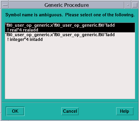

You can use Fortran 90 generic procedures in any Prism command or dialog box that asks for a procedure. If you do so, Prism will prompt you for the name(s) of the specific procedure(s) you want to use.
For example, you use the syntax stop in procedure to set a breakpoint in a procedure. If you use this syntax for a generic procedure, in graphical Prism a dialog box like the one shown in Figure 2-5 would be displayed.
Commands-only Prism would prompt you as in this example:
(prism) stop in fadd More than one identifier 'fadd'. Select one of the following names: 0) Cancel 1) `f90_user_op_generic.x`f90_user_op_generic.f90 `fadd ! real*4 realadd 2) `f90_user_op_generic.x`f90_user_op_generic.f90 `fadd ! integer*4 intadd > >
If you press the Return key, you would see a menu like this:
Select one of the following names: 0) Cancel 1) `f90_user_op_generic.x`f90_user_op_generic.f90`fadd ! real*4 realadd 2) `f90_user_op_generic.x`f90_user_op_generic.f90`fadd ! integer*4 intadd >
If you choose 0 or press Return, the command is cancelled. If you choose other numbers, Prism sets the breakpoint(s) in the specified procedure(s). For example,
Select one of the following names: 0) Cancel 1) `f90_user_op_generic.x`f90_user_op_generic.f90`fadd ! real*4 realadd 2) `f90_user_op_generic.x`f90_user_op_generic.f90`fadd ! integer*4 intadd > 1 (1) stop in fadd (prism)

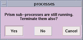

If you have created subprocesses while in Prism (for example, a Solaris shell), Prism displays this message before exiting:
Choose Yes (the default) to leave Prism and terminate the subprocesses. Choose No to leave Prism without terminating the subprocesses. Choose Cancel to stay in Prism.
