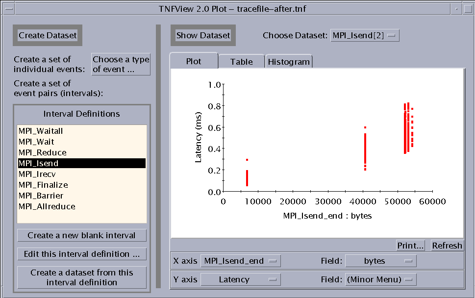

Another notable figure is the scatter plot for MPI_Isend times, shown in Figure 7-7. In this case, for the X axis, we have chosen the Field: to be bytes and then used the Refresh button to refresh the plot. The figure indicates that MPI_Isend performance grows roughly linearly with the message size at a rate of about 100 Mbyte/second, a reasonable rate for on-node data transfer.
Figure 7-7 Scatter Plot of MPI_Isend Times, Plotted Against Message Size.
Graphic
