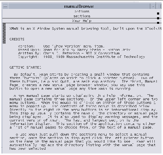

Choose the Man Pages selection from the Doc menu.
This brings up xman, a standard X program for viewing manual pages; xman operates independently of the Prism environment.
Help for xman appears in the xman window, as shown in FIGURE 7-1. You can use xman to view any Solaris manual pages available on your Sun system.
Note - If xman is not available on your system, you will not be able to use this feature. |
