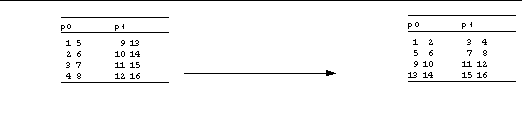

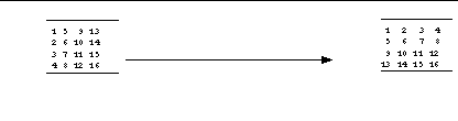

Matrix transposition refers to the exchange of the axes of a rectangular array, flipping the array about the main diagonal. For example, in , after a transposition the array shown on the left side becomes the array shown on the right:
There are many ways of distributing elements of a matrix over the address spaces of multiple MPI processes. Perhaps the simplest is to distribute one axis in a block fashion. For example, our example transposition might appear distributed over two MPI processes (process 0 (p 0), and process 1 (p 1)) such as in :
The ordering of multidimensional arrays within a linear address space varies from one programming language to another. A Fortran programmer, though, might think of the preceding matrix transposition as looking like :
In the final matrix, as shown in , elements that have stayed on the same process show up in bold font, while elements that have moved between processes are underlined.
