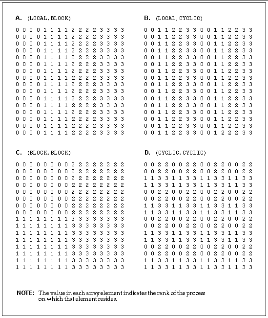

One of the most significant performance-related factors in Sun S3L programming is the distribution of Sun S3L arrays among MPI processes. Sun S3L arrays are distributed, axis by axis, using mapping schemes that are familiar to users of ScaLAPACK or High Performance Fortran. That is, elements along an axis might have any one of the following mappings:
FIGURE 6-1 illustrates these mappings with examples of a one-dimensional array distributed over four processes.
For multidimensional arrays, mapping is specified separately for each axis, as shown in FIGURE 6-2. This diagram illustrates a two-dimensional array's row and column axes being distributed among four processes. Four examples are shown, using a different combination of the three mapping schemes in each. The value represented in each array element is the rank of the process on which that element resides.
In certain respects, local distribution is simply a special case of block distribution, which is just a special case of cyclic distribution. Although related, the three distribution methods can have very different effects on both interprocess communication and load balancing among processes. TABLE 6-1 summarizes the relative effects of the three distribution schemes on these performance components.

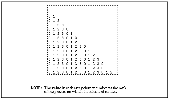

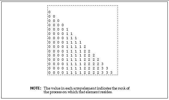

This section demonstrates the load balancing benefits of cyclic distribution for an algorithm that sums the lower triangle of an array.
It begins by showing how block distribution results in a load imbalance for this algorithm (see FIGURE 6-3). In this example, the array's column axis is block-distributed across processes 0-3. Because process 0 must operate on many more elements than the other processes, total computational time will be bounded by the time it takes process 0 complete. The other processes, particularly process 3, will be idle for much of that time.
FIGURE 6-4 shows how cyclic distribution of the column axis delivers better load balancing. In this case, the axis is distributed cyclically, using a block size of 1. Although process 0 still has more elements to operate on than the other processes, cyclical distribution significantly reduces its share of the array elements.
The improvement in load balancing is summarized in TABLE 6-2. In particular, note the decrease in the number of elements allocated to process 0, from 54 to 36. Because process 0 still determines the overall computational time, this drop in element count can be seen as a computational speed-up of 150 percent.

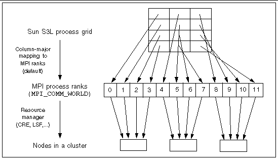

The runtime mapping of a process grid to nodes in a cluster can also influence the performance of Sun S3L routines. Communication within a multidimensional process grid generally occurs along a column axis or along a row axis. Thus, you should map all the processes in a process grid column (or row) onto the same node so that the majority of the communication takes place within the node.
Runtime mapping of process grids is effected in two parts:
The two mapping stages are illustrated in FIGURE 6-6.
Neither stage of the mapping, by itself, controls performance. Rather, it is the combination of the two that determines the extent to which communication within the process grid will stay on a node or will be carried out over a network connection, which is an inherently slower path.
Although the ability to control process grid layout and the mapping of process grids to nodes give the programmer considerable flexibility, it is generally sufficient for good performance to:
For example, assume that 12 MPI processes are organized as a 4x3, column-major process grid. To ensure that communication between processes in the same column remain on node, the first four processes must be mapped to one node, the next four processes to one node (possibly the same node as the first four processes), and so forth.

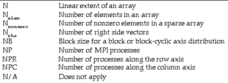

This section contains performance-related information about individual Sun S3L routines. TABLE 6-4 summarizes some recommendations.
Symbols used in TABLE 6-4 are defined in FIGURE 6-7:
The operation count expressions shown in TABLE 6-4 provide a yardstick by which a given routine's performance can be evaluated. They can also be used to predict how runtimes are likely to scale with problem size.
