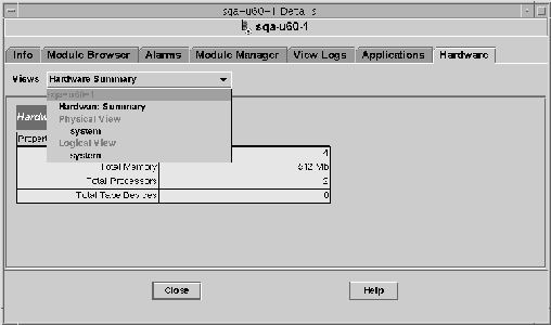

The Hardware Details window, which is shown in Figure 6–3, provides three choices for system information:
Note –
For additional information on the Hardware tab for your specific hardware object, see your platform supplement.
Figure 6–3 Hardware Details Window
Details window with Hardware tab selected shows menu for hardware views.
The Views menu provides access to the available hardware information.

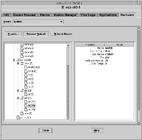

The software displays a logical view configuration of a host, if the host is monitored by a Sun Management Center agent, as illustrated in the following figure. Logical views are not available for ping hosts.
Figure 6–5 Hardware Configuration Logical View
Details window with Hardware tab selected shows logical view for a disk.
Search Button
Click the Search button to display the Search window. Use the Search window to search for components in the Logical View topology on the left side of the viewing window. The located component is highlighted in the topology view. The name of the component displays in the Component field in the bottom right section of the screen.
The Search function is case-sensitive. If the search does not locate the component in your system, the following error message appears at the bottom of the Details window.
Node not found
The Search function stops at the first instance found. For example, if you enter the word board, Search always stops at board(0). To find the next hit, click the Next button. To find a specific instance of a name, type a more complete name. For example, board(2).
