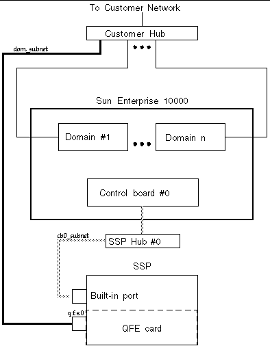

TABLE A-1 and FIGURE A-1 describe the two-subnet network configuration.
Note - In a two-subnet configuration (one SSP, one hub, and one control board), automatic SSP and control board failover are disabled. In a three-subnet configuration (one SSP, two hubs, and two control boards), control board failover is enabled, but SSP failover is disabled. In a spare SSP configuration (two SSPs, two hubs, and two control boards), both SSP and control board failover is enabled. For details on supported failover configurations, see Chapter 2. |
In FIGURE A-1 , the built-in port is le0 for a SPARCstation 5 and hme0 for a Sun Ultra 5 and a Sun Enterprise 250 system.

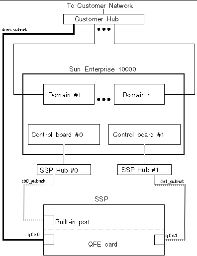

TABLE A-2 and FIGURE A-2 describe the three-subnet network configuration.
In FIGURE A-2 , the built-in port is le0 for a SPARCstation 5 and hme0 for a Sun Ultra 5 and a Sun Enterprise 250 system.

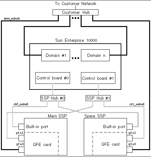

TABLE A-3 and FIGURE A-3 describe the spare SSP network configuration.
In FIGURE A-3 , the built-in port on the main SSP and the spare SSP is le0 for a SPARCstation 5 and hme0 for a Sun Ultra 5 and a Sun Enterprise 250 system.
