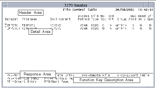

All data entry screens have four areas.
The following function keys perform the specified operations on Sun MTP screens.
