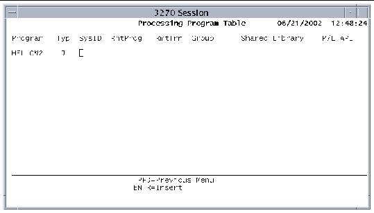

You must define a JCICS program to Sun MTP in the PPT in the same way as any other program, such as one written in COBOL or C.
1. Start the region and make a client connection.
2. Enter the CTBL transaction to open the Table Manager.
3. Press PF4 to display the Standard Tables menu.
5. Press PF4 to insert a new entry.
6. On the PPT insert screen, make the following entries:
a. In the Program field, type the name of the program; for example HELLOW2.
b. In the Typ field, type J (indicating a Java program).
See FIGURE 8-1.

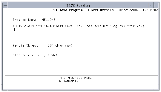

9. On the main PPT screen, select the HELLOW2 program and press PF9 to open the Java Class Details screen.
10. On the Java Class Details screen, type the Java class name in the Fully qualified JAVA Class Name field. Do not include the class suffix or an error occurs at runtime.
The name in the Program field is the program you selected on the PPT main screen.
The Remote Object and IIOP Connectivity fields are not used in this release.
11. Press Enter to add this information.
