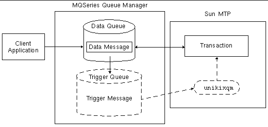

The following figure shows the interaction between a Sun MTP region and MQSeries.
FIGURE 12-1 MQSeries Process Flow
[ D ]
The elements shown in FIGURE 12-1 are:
Client Application: Creates messages on the input data queue. The client application is independent of Sun MTP.
Data Queue: If configured, it places trigger messages on the trigger queue that define Sun MTP transactions.
Trigger Queue: Receives automated messages through procedures configured in the queue manager. Trigger messages contain information used by the region to start transactions, and used by the transaction processors to find the original data messages that spawned the trigger event.
unikixqm: Monitors the trigger queue and starts the transaction based on the application ID in the trigger message. The application ID must be equal to the value of a transaction ID configured in the Program Control Table (PCT).
Transaction: Can put or receive messages to the data queue.
