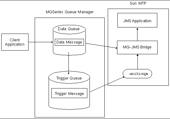

The MQ-JMS Bridge is built upon the existing MQSeries trigger framework. In this framework, the unikixqm daemon is notified whenever an MQSeries trigger message is placed on the monitored queue. unikixqm then initiates a specified Sun MTP transaction to process the associated application queue. This framework is enhanced by defining the MQ-JMS Bridge as the initial application, rather than a user application, thereby providing a level of indirection to the processing flow.
The MQ-JMS Bridge is responsible for processing the MQSeries trigger message and using the supplied information to access the application queue and obtain an instance of the user application program. The MQ-JMS Bridge then processes the application queue, reading each message and passing it on to the user JMS application through its MessageListener.onMessage method. The following figure shows the basic concept.
[ D ]
The elements shown in FIGURE 13-1 are:
Client Application: Creates messages on the input data queue. The client application is independent of Sun MTP.
Data Queue: Places trigger messages on the trigger queue that define Sun MTP transactions.
Trigger Queue: Receives automated messages through procedures configured in the queue manager. Trigger messages contain information used by Sun MTP to start transactions, and used by the transaction processors to find the original data messages that spawned the trigger event.
unikixqm: Monitors the trigger queue and starts the transaction based on the Application ID in the trigger message. In the case of JMS application transactions, the transaction started by unikixqm is always the MQ-JMS Bridge.
MQ-JMS Bridge: Responsible for retrieving messages from the data queue and starting the appropriate JMS application, supplying the data message upon invocation.
JMS Application: Implements the MessageListener interface and, therefore, must supply an onMessage method with one parameter of type Message. The JMS application received the original data message from the data queue through the MQ-JMS Bridge. Any further interaction with MQSeries is the responsibility of the JMS application. It can create connects to the queue manager using the same configuration information used by the MQ-JMS Bridge. See the GetAliasJMSListenerEXMQJMS sample program in the $UNIKIX/test/mq/jms directory for an example of queue manager interaction from a JMS application.

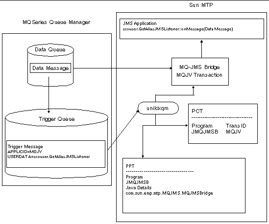

The MQ-JMS Bridge extends the MQSeries trigger configuration shown in CODE EXAMPLE 12-1 to define the target user application that will be scheduled when a new trigger message is generated.
To define the user application, use either of these methods:
The configuration shown in this example causes the unikixqm daemon to initiate the MQJV transaction. The message that starts the transaction contains the trigger properties information, which includes the USERDATA attribute specifying the target application name scouser.GetAliasJMSListenerExMQJMS.

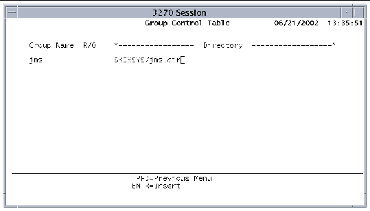

The program associated with the MQ-JMS Bridge product is assigned to the jms group. To enable your region to access this program, you must define the jms group in the GCT.
1. In the Table Manager, open the GCT and press PF4 to insert an entry.
2. On the insert screen, type jms as the group name and $KIXSYS/jms.dir as the directory.
See FIGURE 13-2.
3. Press Enter to insert the entry and return to the GCT main screen.
4. Press PF2 to write the changes to disk.
6. Shut down and restart the region so your changes take effect.

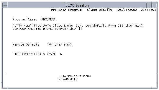

1. Open the PPT and put your cursor on the JMQJMSB program entry.
2. Press PF9 to open the Java Class Details screen.
The fully qualified class path for the MQ-JMS Bridge application is displayed on this screen. The program JMQJMSB is associated with the Java class file named com.sun.emp.mtp.MQJMS.MQJMSBridge.
FIGURE 13-3 shows the Java Class Details screen for the JMQJMSB program.

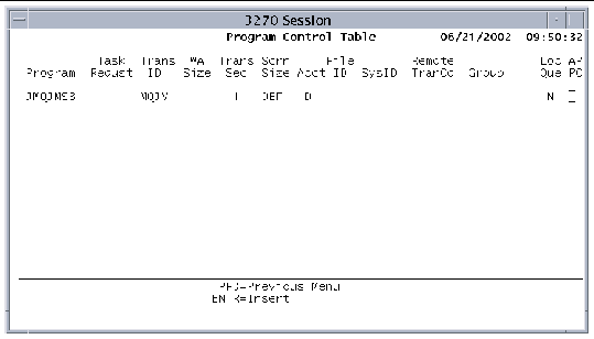

1. Open the PCT and press PF4 to insert an entry.
2. Type JMQJMSB in the Program field.
3. Type a transaction identifier in the Trans ID field.
FIGURE 13-4 shows the JMQJMSB program is assigned to the MQJV transaction. JMQJMSB must be the first program executed when the transaction ID is issued.
This transaction ID must match the Application ID in the MQSeries trigger configuration. For example, the transaction ID shown in the following figure (MQJV) matches the value set in APPLICID shown in CODE EXAMPLE 13-1.
4. Press Enter to insert the entry.
5. Press PF2 to save the table to disk.
6. Shut down and restart the region.
Now there is a relationship between the MQSeries trigger queue and the MQ-JMS Bridge application.

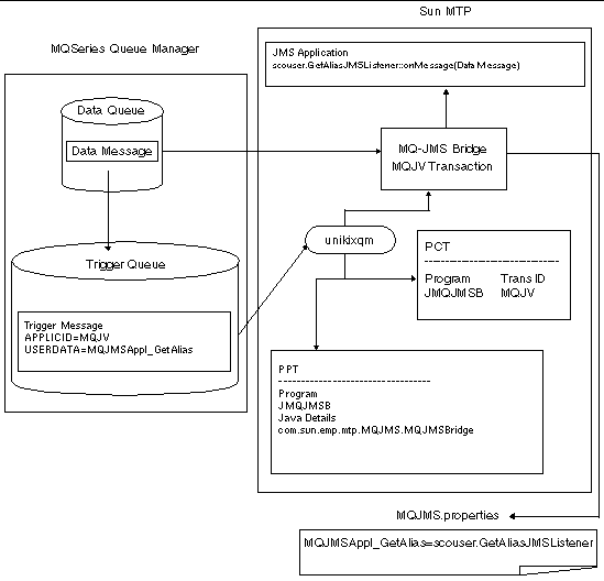

Application mapping is the technique of mapping one application target to some other target. For example, it enables an application identified as MQJMSAppl_GetAlias to be replaced by one identified as scouser.GetAliasJMSListener.
When using mapping, the target user JMS application is defined in the MQJMS.properties file rather than explicitly in the MQSeries PROCESS definition by the USERDATA attribute. This enables you to change the back-end application by simply changing the single MQJMS.properties file instead of the many MQSeries PROCESS definitions that might exist.
To implement application mapping, specify a token or alias, rather than the fully qualified class name of the user application, in the USERDATA attribute of the MQSeries PROCESS definition. This token is defined in the MQJMS.properties file as a key with the target application defined as the corresponding value.
CODE EXAMPLE 13-2 shows how the MQJMSAppl_GetAlias logical token is mapped to the JMS application scouser.GetAliasJMSListener.
Note - The USERDATA attribute could contain a real application target, such as scouser.GetAliasJMSListener. See CODE EXAMPLE 13-1. |
See Processing Flow for more information about how application mapping works.
