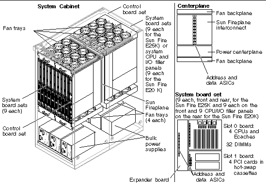

The Sun Fire E25K/E20K systems can consist of two or more air-cooled cabinets: a system cabinet and one or more customer-selected I/O expansion racks (FIGURE 5-2). The system cabinet includes the CPU/Memory and system control peripherals.
The system cabinet is configured with a full complement of eight fan trays, six bulk power supplies, and two System Control board sets, which perform RAS services. (See Section 5.3.2, Controller Board Set.)
In the Sun Fire E25K system, up to 18 system board sets can be configured to determine the number of CPUs and the amount of memory per system. In the Sun Fire E20K system, up to 9 system board sets can be configured to determine the number of CPUs and the amount of memory per system. (See Section 5.3.1, System Board Set.)
A fully loaded Sun Fire E25K system cabinet weighs 2,467.8 lbs (1,121.7 kg). A fully loaded Sun Fire E20K system cabinet weighs 2141.0 lbs (987.0 kg).

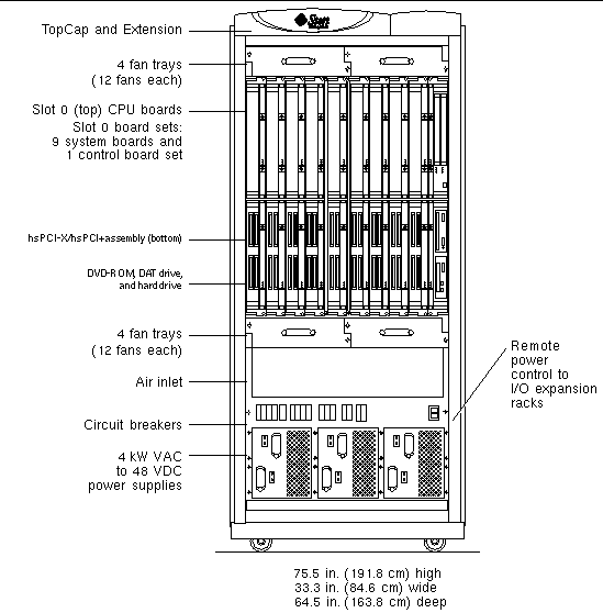

The Sun Fire E25K systems run 200-240 VAC, single-phase power with a frequency of 47 to 63 Hz. The system cabinets require twelve 30A circuits, which are usually connected to two separate power sources. In North America and Japan, the site power receptacles are NEMA L6-30P; otherwise, they are IEC 309. The power cables that go between the system and the facility power receptacles are supplied with the system.
The system cabinets use six dual-input 4-kW dual AC-DC bulk power supplies. Two power cables go to each supply. These supplies convert the input power to 48 VDC. These systems can run with a failed bulk power supply, and the bulk power supplies can be replaced while the system is in operation.
Power is distributed to the individual boards through separate DC circuit breakers. Each board has its own on-board voltage converters, which transform 48 VDC to the levels required by the on-board logic components. Failure of a DC-to-DC converter affects only that particular system board.

For single Sun Fire E25K system or single Sun Fire E20K system heat dissipation, each system needs perforated tiles under the unit. Each tile must be capable of delivering 600 cubic feet per minute of cooling air. Rows of fully loaded system cabinets can be located adjacent to each other. Refer to the Sun Fire E25K/E20K Systems Site Planning Guide for further details.
The air goes in through air inlets in the bottom, front, and back of the system cabinet and out through the top. Four fan trays are located above the system boards, and four are located below. The fans have three speeds and normally run at high speed. If any of the components get too hot, the fans are switched to high speed. The system is capable of running with a failed fan, and the fan trays can be hot-swapped while the system is running.

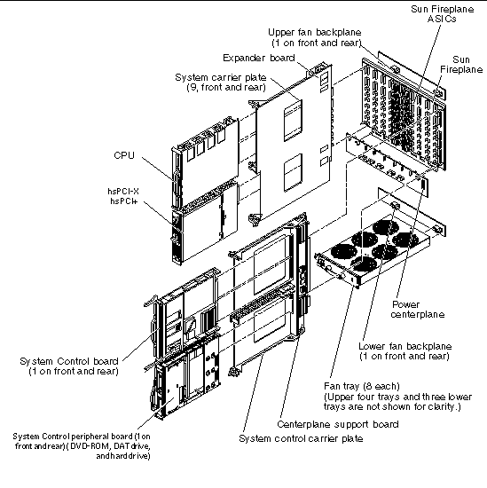

FIGURE 5-3 shows how the boards and fan trays on one side of a Sun Fire E25K/E20K systems connect into the fan backplane, the power centerplane, and the Sun Fireplane interconnect.
A slot 0 board and a slot 1 board connect into a system carrier plate with an expander board, which in turn connects into the Sun Fireplane interconnect. This unit is called a board set. (See Section 5.3, System Boards.)
Nine system board sets connect into each side of the Sun Fireplane interconnect with a system carrier plate and the expander, slot 0 through 8 (front side) and slot 9 through 17 (rear side) of the Sun Fire E25K system. Nine system board sets connect into the front side of the Sun Fireplane interconnect with a system carrier plate and an expander, slot 0 through 8 and nine CPU and I/O filler panels slide into slot 9 through 17 (rear side) of the Sun Fire E20K system. Two system controller board sets (System Control board and System Control peripheral board) connect into each side of the Sun Fireplane interconnect with the system control carrier plate and the centerplane support board, slot SC0 (front side) and slot SC1 (rear side) on both systems. Power is distributed to all board sets through the power centerplane which is located beneath the Sun Fireplane interconnect.
The Sun Fireplane interconnect has two dedicated slots (both on the right side, front and rear) for the system controller board sets. These board sets contain power, clock, and JTAG support for the Sun Fireplane interconnect ASICs and hold the System Control boards and their associated peripherals (DVD-ROM, DAT drive, and hard drive ).
Two fan backplanes are mounted above the Sun Fireplane interconnect, and Two are mounted below the power centerplane, distributing power to the eight fan trays.

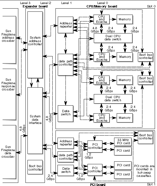

Two CPU/Memory pairs are connected to the rest of the system through the level-0 dual-CPU data switch. Each CPU/Memory can transfer data at a maximum rate of 2.4 Gybtes/sec. The pair of CPU/Memory units share a 4.8 Gybte/sec port to the data switch. The level-1 data switch connects the two pairs of CPUs to the off-board data port that goes to the expander board. (See FIGURE 5-4.)

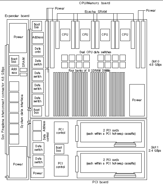

FIGURE 5-4 and FIGURE 5-5 show an example board set diagram and board set layout composed of an expander board, a CPU/Memory board, and a PCI board.
The I/O assembly is a slot 1 option board. Each hsPCI-X assembly has two PCI controllers and provides four PCI slots (one at 33 MHz and three at 33/66/90 MHz).The hsPCI+ assembly also has two PCI controllers and provides four PCI slots (one at 33 MHz and three at 33/66 MHz).

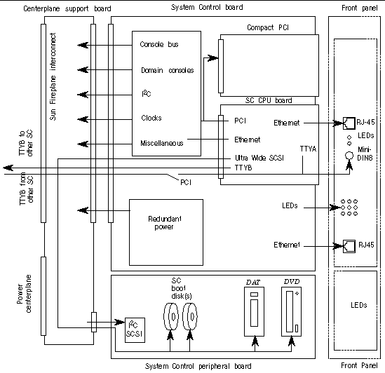

The controller board set provides critical services and resources required for operation and control of the Sun Fire E25K/E20K systems (FIGURE 5-6).
This board set consists of three boards:
The System Control board is a two-board combination:
The system controller board set provides the following critical services and resources required for operation and control of the Sun Fire E25K/E20K systems:
The SPARCengine cPCI+ card is mounted flat and on top of the SC in the same manner that the PCI cards are mounted onto the I/O assemblies.
