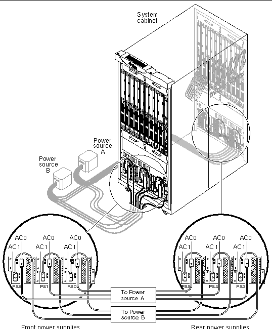

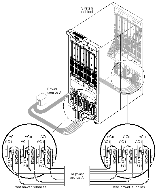

TABLE 3-1 lists the electrical specifications for the system cabinet. Use TABLE 3-2 to record the power cable requirements (see Appendix A for an expanded form to use and retain for your records). TABLE 3-3 provides a summary of features of the three power configurations. FIGURE 3-1, FIGURE 3-2, and FIGURE 3-3 illustrate the possible system power connections.
Sun Fire E25K/E20K systems can operate while one power supply is being serviced and with two independent power sources as in FIGURE 3-1 as long as the systems stay under 20,000W DC power consumption as measured by the SMS command

Sun Fire E25K/E20K systems configured as in FIGURE 3-3 cannot operate above 20,000W DC power consumption while one power supply is being serviced.
Redundant (FIGURE 3-1) |

Basic (FIGURE 3-3) |

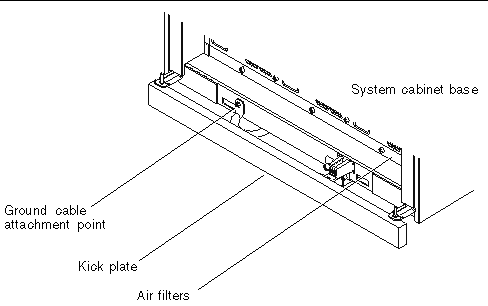

3. Attach the ground cable to the system, behind the kick plate, at the bottom of the frame base as shown in FIGURE 3-4.
4. The ground cable attaching area might be a painted surface. Ensure metal-to-metal solid contact is made for this installation.
