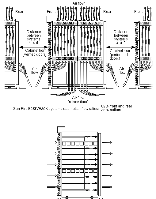

FIGURE 2-1 demonstrates the directions of the air flow within the system cabinet.

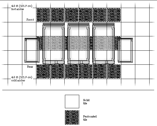

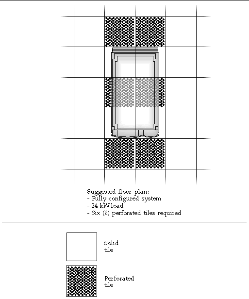

The fan tray redundancy in Sun Fire E25K/E20K systems provide enough air flow for adequate system performance on a flat floor. A raised floor is recommended for optimal system performance. Air enters the cabinet through the front and rear doors and through the air intake panels underneath the cabinet. Review the recommended floor plan layout sample for a fully configured system in FIGURE 2-2 for planning your solid and perforated tile floor configuration. This floor plan is based on floor tiles delivering 600 cubic feet per minute (cfm) cooling for each tile.
FIGURE 2-3 shows a floor plan layout for multiple Sun Fire E25K/E20K systems.
