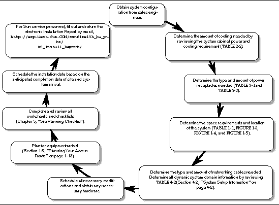

This chapter details the physical requirements for Sun Fire E25K/E20K systems. Review the site preparation process flow diagram shown in FIGURE 1-1 as you begin to evaluate the needed requirements before your system installation.

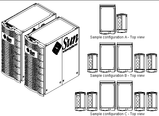

Multiple cabinet configurations (FIGURE 1-2) would include additional customer-selected I/O expansion racks with I/O cabling (customer-specified length). Customer-selected I/O expansion racks house additional I/O disk or tape subsystems. Additionally, each I/O expansion rack contains AC distribution subsystems for use with the I/O subsystems.
Multiple cabinets may be placed side-by-side as long as the environmental specifications in Chapter 2 are met.

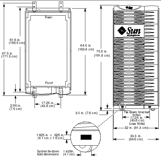

FIGURE 1-4 shows the dimensions of the Sun Fire E25K/E20K systems cabinet.
Note - There might be slight variances in some component weights depending on customer configurations. |
Note - The shipping pallet tie-down bracket holes in the front and rear of the lower chassis can also be used to hold-down or secure the system frame to the floor of your facility. |

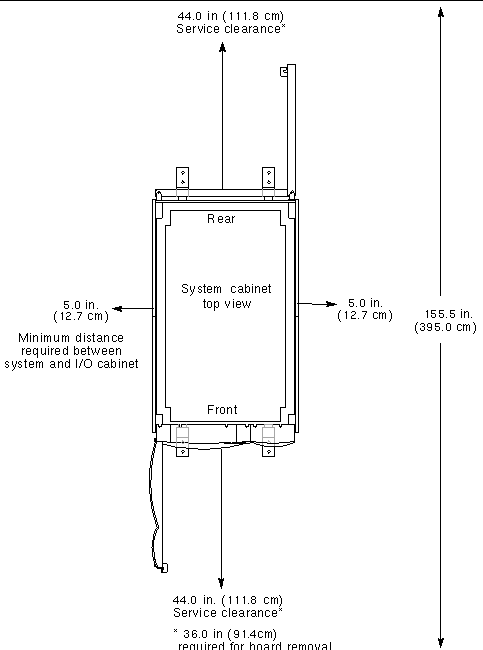

FIGURE 1-5 shows the clearance dimensions of the Sun Fire E25K/E20K systems cabinet. These dimensions apply to both 4-door and 2-door systems.

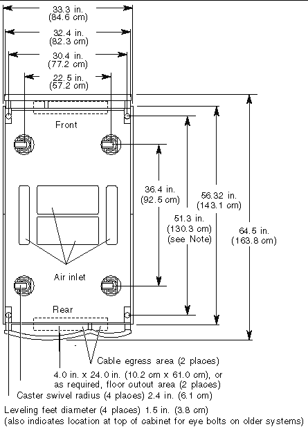

Place perforated floor panels or floor grilles near or directly under the base of the system. FIGURE 1-6 illustrates the floor cutouts for cables. Suggested locations for perforated floor panels or floor grilles are shown in FIGURE 2-2. Use the floor layout diagram of the proposed location for the system shown in FIGURE 1-6 to determine the exact area required for your system. Ensure cabinets are positioned so all casters and leveling feet are on solid raised-floor tiles.

Note - In addition to the standard 4.0 in. X 24.0 in. (10.2 cm x 61.0 cm) floor cutout area (see dotted lines), any unused cable opening should be filled with a suitable material to block airflow. |
