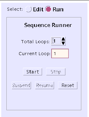

f. With the Sequence selected, press the Run button.
The right-hand panel displays the Sequence Runner panel (FIGURE 4-14), providing access for you to define the number of times (loops) for the sequence to run and to start running the sequence.
a. Increment or decrement the Total Loop value to the desired number of times you want the sequence to run.
6. Press the Start button to start the sequence.
While testing is underway you can:
monitor the test progress in the main SunVTS window. All test results are logged in the SunVTS log files.
close the Deterministic Scheduler dialog box by pressing the close button or by selecting CommandsQuit OptionsQuit UI only from the Deterministic Scheduler dialog box. Testing will continue, and results will be displayed in the SunVTS main window. You can reopen the Deterministic Scheduler dialog box from the SunVTS main window.
suspend and resume the sequence by pressing the suspend and resume buttons in the Deterministic Scheduler dialog box.
7. Use the Reset button to reset the SunVTS main window and the Deterministic Scheduler.
The SunVTS main window test statistics and the Deterministic Scheduler current loop count are reset.
