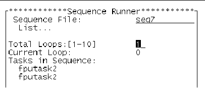

Start the Deterministic Scheduler.
Create one or more tasks, using the Task Manager menu. A task is a SunVTS test session configuration (one or more selected SunVTS tests, test options, and specific test mode).
Create the sequence, using the Sequence Manager menu. A sequence is a group of tasks specified to run in a certain order.
Define the number of times (loops) that sequence runs, using the Sequence Runner menu.
Start the sequence.
When the sequence is done, reset the Deterministic Scheduler if desired.

1. Invoke the Sequence Runner menu by selecting Seq Runner in the Start DS menu.
2. Select the sequence that you want to run by selecting List... , highlighting the sequence, and press return.
3. Change the Total Loop value to the number of times you want to repeat the sequence of tests.
Note - The default and minimum number of Total Loops value is 1. You can change the Total Loop value to the desired value, up to a maximum of 10 loops. |
4. Select the Start button at the bottom of the Sequence Runner menu start the sequence.
