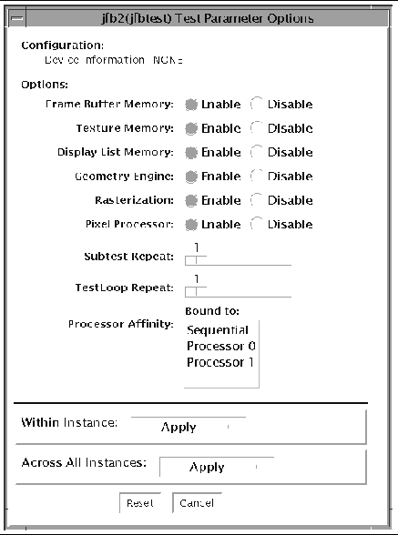

To reach the following dialog box, right-click on the test name in the System Map and select Test Parameter Options. If you do not see this test in the System Map, you might need to expand the collapsed groups, or your system might not include the device appropriate to this test. Refer to the SunVTS User's Guide for more details.
By default, all jfbtest options are enabled.
FIGURE 30-1 jfbtest Test Parameter Options Dialog Box
TABLE 30-1 jfbtest Options
jfbtest Options
Description
Frame Buffer Memory test
Thoroughly tests the Sun XVR-1200 video memory by using read and write requests. Tests for shorts or failed connections on the data bus by writing the following values to every address:
- 0xFFFFFFFF
- 0xFFFF0000
- 0x0000FFFF
- 0xFF00FF00
- 0x00FF00FF
- 0xF0F0F0F0
- 0x0F0F0F0F
- 0xCCCCCCCC
- 0x33333333
- 0xAAAAAAAA
- 0x55555555
Tests for shorts or failed connections on the address bus by writing the offset of each memory location to each location and reading them back. This may also catch speed-related problems due to the volume of read/writes.
Errors in the test are reported as an error in a particular address, not attributed to a specific chip. To help distinguish bit-related errors, the errors are summarized to list which bits had at least one error in the test.
This test shows on the screen as random pixels.
Texture Memory test
This test is identical in process to the Frame Buffer Memory test. Since this test produces no visible effect, rectangles are drawn in rows across the screen to show progress.
Display List Memory test
This test is identical in process to the Frame Buffer Memory and Texture Memory tests, and is applied to direct burst memory.
This test takes little time and no progress is displayed.
Geometry Engine test
Loads diagnostic microcode into the geometry engine and confirms that the processor operates correctly. This is a pass/fail test.
Rasterization test
Renders many primitives with minimal fragment processing, to test the rasterization of the primitives.
The primitives used are:
- Dots
- Anti-aliased dots
- Lines using all for line-drawing primitives
- Anti-aliased lines using all for line-drawing primitives
- Triangles, quads, and polygons in point, line, and fill modes
- Rectangles
This tests for the following rasterization attributes:
- Pixel coverage
- Constant value registers for color, Z, and stencil
- Interpolation of color, Z, and texture coordinates along lines and spans in polygons
- Texture map sampling
Resulting images are compared against stored images. Errors indicate which operation type and value was being tested, and the coordinate of the failed pixel.
Pixel Processor test
Tries the various pixel processing operators using a variety of fragment values. This tests the following fragment processing operations:
- Depth Buffering
- Blending
- Alpha Test
- Color Test
- Color Clamp
- Logic Operations
- Color Matrix and Bias
- Color Table
- Control Planes
- Fast Clear
- Stencil
- Scissor Clipping
- Desktop Clipping
- Mask Clipping
- Write Masks
- Window Origin
- Fog
- Pixel Texture
- Accumulation Buffer
- Pixel Buffers
Resulting images are compared against stored images. Errors indicate which operation type and value was being tested and the coordinate of the failed pixel.
