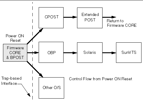

Control flow at board startup is shown in FIGURE 4-1. Execution begins in Firmware Common Operations and Reset Environment (CORE)--which includes Basic POST (BPOST). It passes to Comprehensive POST (CPOST) and Extended POST (EPOST), if these are present, before returning to firmware CORE and on to OpenBoot PROM. The test execution path is determined by environment variables.
Firmware CORE provides the following functionality:
processors are designed with a common software trap structure that is useful for this common programming interface, so that clients may not need to carry another copy of those drivers and may use those services provided by firmware CORE until their driver takes over.
BPOST is integrated into firmware CORE. BPOST tests are interleaved with the initialization activities of firmware CORE to present a foundation of validated and initialized hardware to run subsequent code such as that in CPOST or OpenBoot PROM. The tests listed in TABLE 4-1 are examples of CORE and BPOST flow of execution.

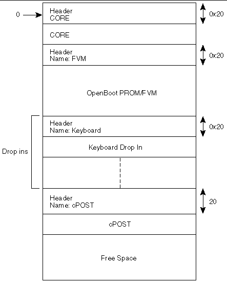

The node board boots from the 1 Mbyte system flash PROM device, which contains the firmware CORE, basic POST code, comprehensive POST, and OpenBoot PROM. The contents map of this PROM is shown in FIGURE 4-2.
User-developed code can also be programmed into the user flash memory space in the form of dropins. The system flash can be upgraded by running a program out of OpenBoot PROM--see Section 4.6, SMC Firmware. It is not otherwise accessible by the user.

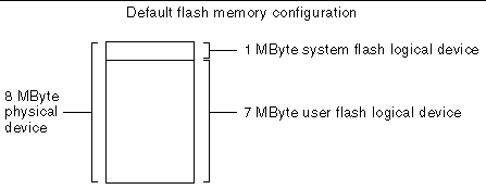

On the Netra CP2300 board, both the system (boot) flash and the user flash memory reside on the same physical device. By default the system flash uses 1 MByte of flash memory while the user flash uses 7 MBytes of flash memory (TABLE 4-4). For more information about system flash and user flash memory, see Section 5.3.4, Memory Components.
By default, the system flash is allocated 1 MByte of memory and user flash is allocated 7 MBytes of memory. If your application environment requires it, you can exchange these logical memory devices and make the system flash use 7 MBytes of memory and the user flash 1 MByte of memory.

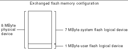

To exchange these memory allocations, you must first change the SW3 DIP switch setting and set the flash-device setting in the configuration block. (See Section 4.6.1, SMC Configuration Block for more information about the configuration block.)

SW3 DIP switch position 6 controls the flash memory selection. When position 6 is set to on (default), system flash will be assigned 1 MByte of memory and user flash will be assigned 7 MBytes of memory.
When SW3 DIP switch position 6 is set to off, and the flash-device setting of the configuration block is set to 4, user flash will be assigned 1 MByte of memory and system flash will be assigned 7 MBytes of memory.
5. To set the flash memory selection, set the SW3 DIP switch position 6 to off.

After setting the DIP switch and the flash-device setting, the system flash will be assigned 7 MBytes of memory and the user flash will be assigned 1 MByte of memory (see FIGURE 4-5).
