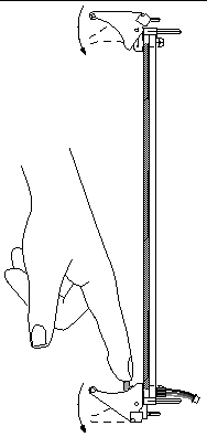

If the Solaris operating environment is up and running on a Netra CP2300 board, and you open the board's latches, you will see a message that the operating environment will shut down in one minute. When the operating environment drops to the OpenBoot PROM prompt level, you can safely remove the board.
The blue hot-swap LED, located on the front panel of the Netra CP2300 board (FIGURE 5-3), lights up when the hot-swap function is enabled by the system software. The hot-swap LED indicates that the board can be extracted from the chassis. When a board is inserted into a cPSB system, the LED is lit automatically until the hardware connection process is completed. The LED then remains off until the extraction is once again enabled by the system software.
FIGURE 3-1 shows how to release the Netra CP2300 handles.
