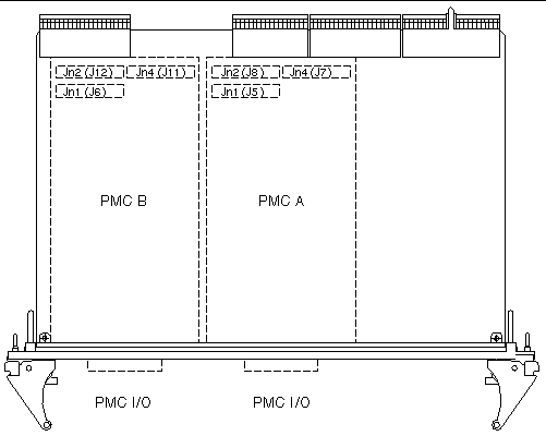

FIGURE B-1 shows the locations of PMC port connectors, and the tables below show contact allocations.
FIGURE B-1 Netra CP2300 Board PMC Port Connectors
Note - The P1386.1 standard reserves the Jn3 64-pin connector for PCI 64-bit extensions, so it is not fitted on the Netra CP2300 board.
TABLE B-1 lists how the PMC slot connectors are labelled on the board.
TABLE B-1 PMC Connector Labelling
PMC Slot
PMC Connector
Board Connector Label
PMC slot B
Jn1
J6
PMC slot B
Jn2
J12
PMC slot B
Jn4
J11
PMC slot A
Jn1
J5
PMC slot A
Jn2
J8
PMC slot A
Jn4
J7

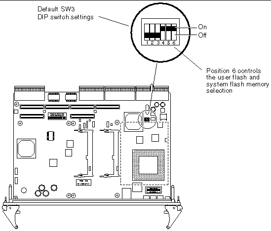

B.5 DIP Switch Settings
The Netra CP2300 board contains two banks of DIP switches. The SW3 DIP switch is located on the component side of the board and the SW501, SW502, and SW503 DIP switches are located on the solder-side of the board.
B.5.1 SW3 DIP Switch
The SW3 DIP switch is a six position switch located on the component side of the Netra CP2300 board. FIGURE B-4 shows the location and default settings of the SW3 DIP switch.
FIGURE B-4 SW3 DIP Switch Location and Default Settings
TABLE B-14 SW3 Position Settings
Position #
Default Setting
Description
1
OFF
Proprietary setting. Do not change setting.
2
OFF
3
OFF
4
ON
5
ON
6
ON
- ON = Boot the Netra CP2300 board from the standard OpenBoot PROM system flash.
- OFF = Use the SMC firmware programmable variable flash-device to set whether the system flash is selected as bootable in 1 MByte or 7 MBytes of flash memory space.
For more information about switching the memory selection between the system flash and the user flash, see Section 4.7.1, Exchanging the System and User Flash Memory Devices.
Caution - SW3 DIP switch positions 1 through 5 are not user-selectable and must never be changed. Changing these settings may critically damage the Netra CP2300 board.

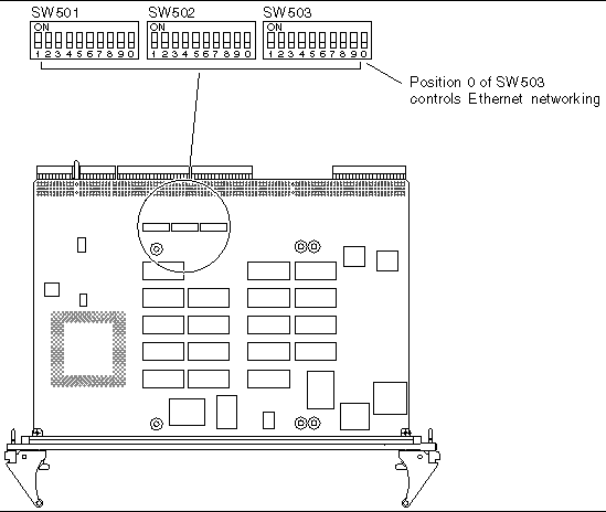

B.5.2 SW501, SW502, and SW503 DIP Switches
The SW501, SW502, and SW503 DIP switches are ten position switches located on the solder side of the Netra CP2300 board. FIGURE B-5 shows the location and default settings of the SW501, SW502, and SW503 DIP switches.
FIGURE B-5 Location and Default Settings of the SW501, SW502, and SW503 DIP Switches
Position 0 of SW503 controls the Ethernet networking on the Netra CP2300 board and transition card. By default, position 0 is set to OFF, which means that the board is set for cPSB network mode and the Netra CP2300 transition card's RJ45 Ethernet ports are disabled. If you will use the Netra CP2300 board in a non-cPSB enclosure, you should set Position 0 of SW503 to ON, so that you can use the RJ45 Ethernet connectors on the transition card.
The remaining DIP switch positions (SW501, 1 to 0; SW502, 1 to 0; SW503, 1 to 9) control the EIDE connector on the Netra CP2300 transition card. When these positions are set OFF, you will not be able to use the transition card's EIDE connector. In this setting, however, all of the pin signals (PIM_A_IO_1 to PIM_A_IO_64) on the PIM A Jn4 connector will be available. (The PIM A Jn4 connector is labelled J5 on the transition card.) See FIGURE B-6 for the location of the PIM A Jn4 (J5) and EIDE connectors. Refer to the Netra CP2300 cPSB Transition Card Installation and Technical Reference Manual (816-7188-xx) for the pin descriptions of these connectors.
When these DIP switch positions are set to ON, the EIDE connector on the transition card will be available. However, pins 1 through 29 on the PIM A Jn4 (J5) connector (PIM_A_IO_1 to PIM_A_IO_29) are disabled and must not have PIM A I/O connections.
TABLE B-15 SW501, SW502, SW503 DIP Switch Settings
DIP Switch, Position Numbers
Default Setting
Description
SW501, positions 1 to 0
SW502, positions 1 to 0
SW503, positions 1 to 9
OFF
Controls the EIDE and PIM A J5 connectors on the Netra CP2300 transition card.
- OFF = EIDE connector disabled and PIM A J5 connector enabled
- ON = EIDE connector enabled and PIM A Jn4 (J5) connector pins 1 through 29 disabled
SW503, position 0
OFF
Controls the RJ45 Ethernet connectors on the Netra CP2300 transition card.
- OFF = cPSB network mode; RJ45 Ethernet connectors disabled
- ON = RJ45 Ethernet connectors enabled
Note - Even if you are not using the PIM_A_IO connections for transition card PIM applications, the PMC A slot restricts the use of PMC cards with PIM capability. If the PMC card uses the PIM_A_IO_1 to PIM_A_IO_29 signals, refer to your PMC card documentation to determine compatibility.

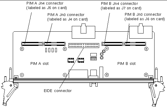

FIGURE B-6 Netra CP2300 cPSB Transition Card EIDE and PIM Connector Locations
