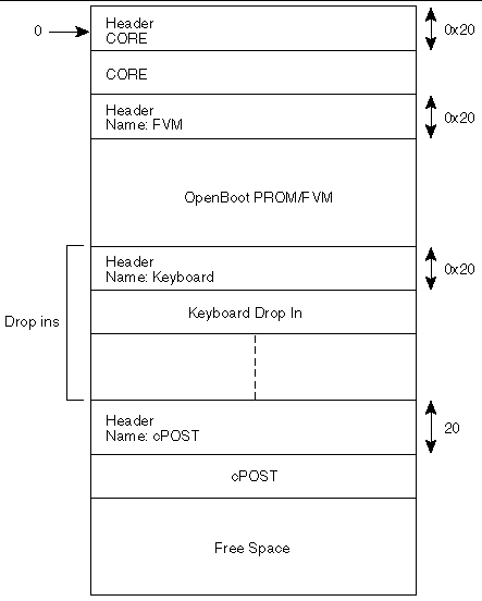

The node board boots from the 1 Mbyte system flash PROM device, which contains the firmware CORE, basic POST code, comprehensive POST, and OpenBoot PROM. The contents map of this PROM is shown in FIGURE 4-2.
User-developed code can also be programmed into the user flash memory space in the form of dropins. The system flash can be upgraded by running a program out of OpenBoot PROM--see Section 4.6, SMC Firmware. It is not otherwise accessible by the user.

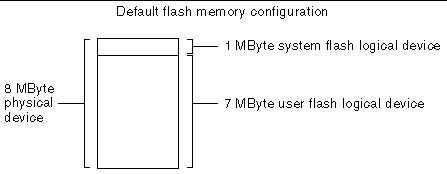

On the Netra CP2300 board, both the system (boot) flash and the user flash memory reside on the same physical device. By default the system flash uses 1 MByte of flash memory while the user flash uses 7 MBytes of flash memory (TABLE 4-4). For more information about system flash and user flash memory, see Section 5.3.4, Memory Components.
By default, the system flash is allocated 1 MByte of memory and user flash is allocated 7 MBytes of memory. If your application environment requires it, you can exchange these logical memory devices and make the system flash use 7 MBytes of memory and the user flash 1 MByte of memory.
To exchange these memory allocations, you must first change the SW3 DIP switch setting and set the flash-device setting in the configuration block. (See Section 4.6.1, SMC Configuration Block for more information about the configuration block.)

After setting the DIP switch and the flash-device setting, the system flash will be assigned 7 MBytes of memory and the user flash will be assigned 1 MByte of memory (see FIGURE 4-5).
If you are unsure if system flash is allocated the default 1 MByte of memory or 7 MBytes of memory, you can use the OpenBoot devalias command to see where user flash logical device begins.
Using the devalias command at the ok prompt, you can see where the user flash device path begins. By default, the system flash will use 1 MByte of space, so the user flash will begin at 100000 bytes (0 to fffff will be used by the system flash):
If the SW3 DIP switch position 6 is set to off, and the flash-device is set to 4, the system flash uses 7 MBytes of space and the user flash device path will begin at 700000 (0 to 6fffff will be used by the system flash):
In both situations, the system flash device path will start at 0, so you should not use it to determine the flash memory sizes:
