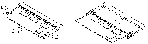

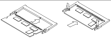

3. For the SO-DIMM you wish to remove, simultaneously pull both SO-DIMM spring retainer clips outward from the slot.
The SO-DIMM will release outward at an angle of about 20 degrees (see FIGURE 2-3).
4. Grasp the SO-DIMM by the edges, and carefully pull it out of its connector. Place it in an antistatic bag.
Ensure that you pull the SO-DIMM out at an angle of about 20 degrees, or you may damage the SO-DIMM.

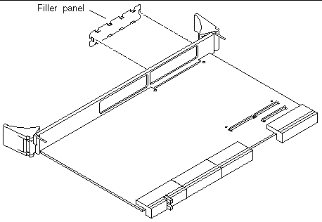

Note - If EMI compliance is required, do not remove the PMC filler panel unless you are going to install a PMC to the adapter. |
4. If the PMC has a connector for cabling, remove the Netra CP2300 board's filler panel (FIGURE 2-4).

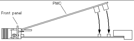

6. Insert the PMC at an angle into the appropriate PMC slot (FIGURE 2-5).
Make sure that the PMC's connector goes through the board's PMC slot.

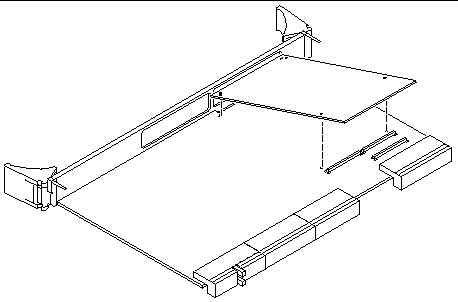

7. Align the PMC over the PMC connectors.
8. Carefully press the PMC into the board's PMC connectors (FIGURE 2-6).

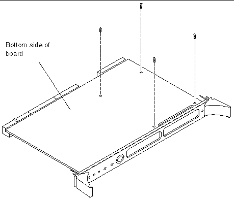

9. Turn the Netra CP2300 board over and use a screwdriver to secure the four screws that attach the PMC to the Netra CP2300 board (FIGURE 2-7).

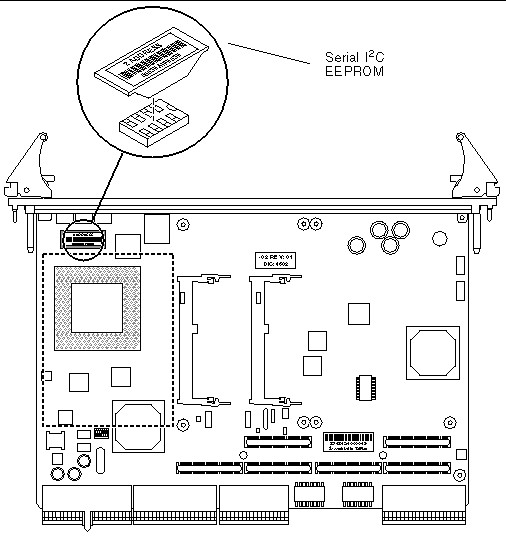

The serial I2C EEPROM stores the board MAC address and host ID information (see Section 5.3.4.4, Serial I2C EEPROM for more information). You do not need to replace the EEPROM unless you are installing a replacement board that does not have the host ID information.
If you need to replace the Netra CP2300 board, remove the serial I2C EEPROM from the original board and install it on the replacement Netra CP2300 board. FIGURE 2-8 shows the position of the serial I2C EEPROM on the Netra CP2300 board. The MAC address label is positioned on top of the serial I2C EEPROM.

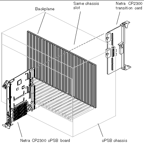

A compatible transition card must be used with the Netra CP2300 board for rear I/O access. The transition card enables access to the network, to a boot device and to a console terminal. You may use the Netra CP2300 transition card, or you may design your own transition card.
A cPSB chassis usually contains:
1. Ensure that power is disconnected from the chassis.
The Netra CP2300 board can be installed while the chassis is powered--however only start with a powered chassis if necessary. Check that the corresponding Netra CP2300 transition card is installed.
If you need a transition card for I/O for the Netra board, ensure that it is already present in the chassis. This step is essential if the chassis is powered during the installation.

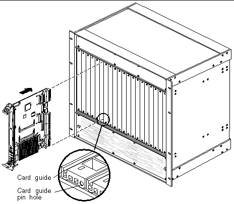

2. Slide the Netra CP2300 board into the appropriate slot on the corresponding top and bottom mounting rails and toward the backplane while gently pushing the board handles inward.
While sliding the board, ensure that the Netra CP2300 extraction levers are aligned perpendicular to the card flange in the unlocked position and that the board connectors are aligned with the transition card connectors (FIGURE 2-10).
3. Install two screws through the top and bottom of the front connector plate to secure the board.
Note - Follow the chassis manufacturer's instructions to make sure the Netra CP2300 board is properly installed into the chassis slot. |
