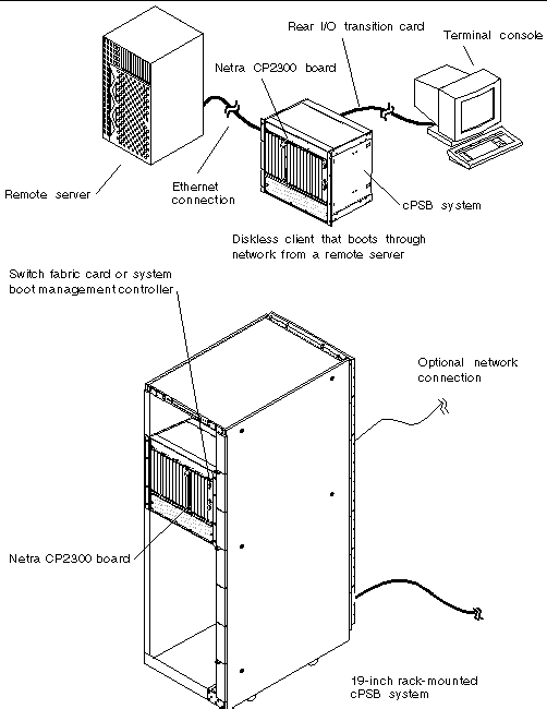

The Netra CP2300 boards can be mounted in various enclosures, such as shown in FIGURE 1-2. The boards can be deployed in various electrical configurations to suit each end-user requirement. For example, the board can be configured to boot from a network as a diskless client with either a cPSB or rear transition card network connection. Alternatively, industry-standard PMC and PIM hardware from independent hardware vendors (IHVs) can be installed to provide local disk I/O, which may optionally be used as a boot path. The installation procedure is independent of the type of enclosure, whether a floor-mounting rack or a bench-top cabinet is used. The Netra CP2300 board has fixed on-board memory and connectors for additional memory.

Possible boot and console configurations are described in TABLE 1-2. Sun Microsystems provides the Netra CP2300 board and a compatible Netra CP2300 transition card. This transition card provides two 10/100 Ethernet RJ45 ports from the host to the rear of the system, which can optionally be used to accomplish a network boot as a diskless client. The other configurations require IHV hardware.
