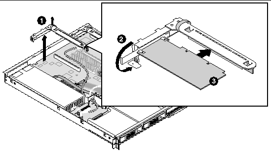

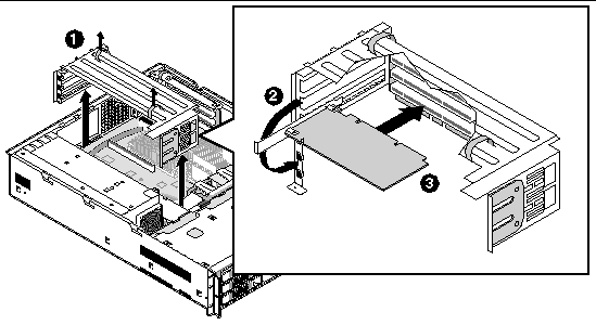

2. Install the zero-channel RAID controller board in the server.
b. Disconnect the server power cord(s).
c. Remove the server top cover.
d. Unplug and remove the full-height riser board from the server.
Note - The full-height riser board is the one on the left when the server is viewed form the front. |
e. Install the zero-channel RAID controller in the full-height riser board, in the slot closest to the surface of the main board of the server (see FIGURE A-2).
Note - FIGURE A-2 shows installation of the controller in a 1U server. FIGURE A-3 shows installation of the controller in a 2U server. Make sure to install the controller in the slot closest to the server main board. |
f. Replace the riser board, with the RAID controller board in it.
Note - The RAID controller uses the SCSI controller on the server board to communicate with the drives, so no SCSI cables need to be connected to the controller board. |

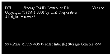

a. Power on the server and press <Ctrl> + <G> when the screen shown in FIGURE A-4 appears.
After you press <Ctrl>+<G>, the following two messages appear at the bottom of the screen:
Intel (R) Storage Console to start after POST
Please wait to start Intel (R) Storage Console

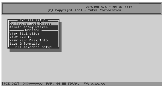

When the Storage Console software starts, it indicates that the RAID controller (SRCZCR) is installed in the server (see FIGURE A-5).
b. Press <Enter> to select the SRCZCR controller.
c. At the Express Setup window, select Configure Host Drives and press <Enter> (see FIGURE A-6).

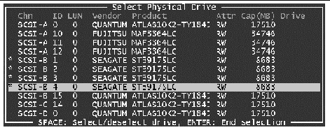

A list of available hard disk drives is displayed (see FIGURE A-8). These are drives that do not belong to a logical host drive and can be used for new RAID host drives.
e. Use the arrow keys and the space bar to select the hard drives you wish to include in the RAID system (the ones that are available are marked
with an "*").
To select or deselect a drive, move the highlight over the drive with the arrow keys and press the space bar.
f. Press <Enter> when you are satisfied with your selections.

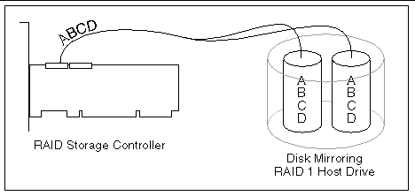

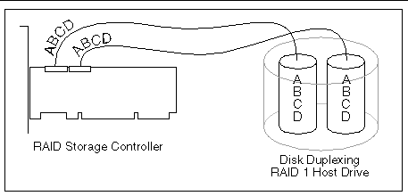

All data is stored twice on two identical hard disks. When one hard disk fails, all data is immediately available on the other without any impact on performance and data integrity.
With Disk Mirroring (), two hard disks are mirrored on one I/O channel. If each hard disk is connected to a separate I/O channel, it is called Disk Duplexing (FIGURE A-15).
RAID 1 represents an easy and highly efficient solution for data security and system availability. It is especially suitable for installations which are not too large (the available capacity is only half of the installed capacity).

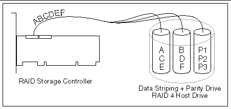

RAID 4 works in the same way as RAID 0. The data is striped across the hard disks and the controller calculates redundancy data (parity information) that is stored on a separate hard disk (P1, P2, ...), as shown in FIGURE A-16. Should one hard disk fail, all data remains fully available. Missing data is recalculated from existing data and parity information
Unlike RAID 1, only the capacity of one hard disk is needed for redundancy. For example, in a RAID 4 disk array with 5 hard disks, 80% of the installed hard disk capacity is available as user capacity, and only 20% is used for redundancy. In systems with many small data blocks, the parity hard disk becomes a throughput bottleneck. With large data blocks, RAID 4 shows significantly improved performance.

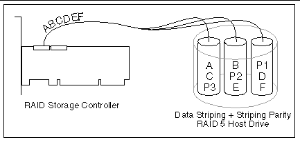

Unlike RAID 4, the parity data in a RAID 5 disk array is striped across all hard disks (FIGURE A-17).
The RAID 5 disk array delivers a balanced throughput. Even with small data blocks, which are very likely in a muti-tasking and muti-user environment, the response time is very good. RAID 5 offers the same level of security as RAID 4. When one hard disk fails, all data is still fully available. Missing data is recalculated from the existing data and parity information. RAID 4 and RAID 5 are particularly suitable for systems with medium to large capacity requirements, due to their efficient ratio of installed and available capacity.

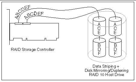

RAID 10 is a combination of RAID 0 (Performance) and RAID 1 (Data Security). See FIGURE A-18.
Unlike RAID 4 and RAID 5, there is no need to calculate parity information. RAID 10 disk arrays offer good performance and data security. As in RAID 0, optimum performance is achieved in highly sequential load situations. Identical to RAID 1, 50% of the installed capacity is lost through redundancy.
