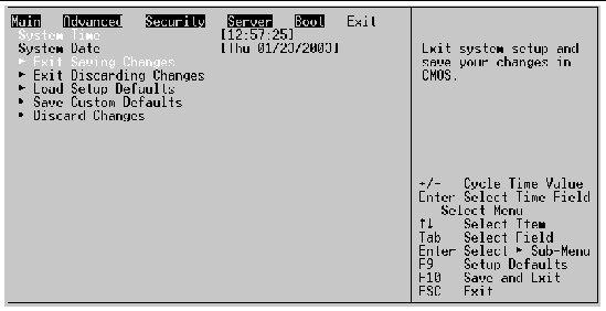

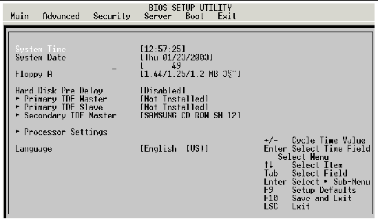

Press F2 to enter the BIOS Setup Utility. The main BIOS Setup Utility screen shown in FIGURE 4-7 appears.
Caution - Changing the BIOS settings may cause undesirable effects, and in some cases may disable the server. Be very careful before changing the BIOS configuration. |

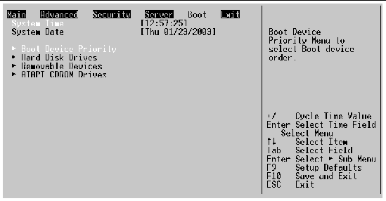

It is important to note the default boot sequence. The boot sequence is accessed by using the right arrow key to select the Boot menu item on the top of the BIOS screen, then pressing Enter. The boot sequence is then displayed. The default boot sequence is as shown in FIGURE 4-8.
You can always restore all of the default BIOS settings by scrolling to the Exit menu item along the top of the screen. The BIOS Setup screen then appears as shown in FIGURE 4-9.
To restore all of the default settings, scroll to "Load Setup Defaults" and press Enter, then select Yes at the prompt and press Enter again. Now press F10 to save the settings and exit.

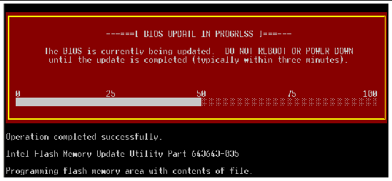

Note - To update the server BIOS, see Updating the Server Configuration. |

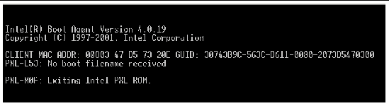

If you press F12 to boot from the network, the server software looks for a valid boot file name on the network. If it finds such a file name, it boots from the network. If it cannot find a valid file name, it gives up and continues to boot from the hard disk. FIGURE 4-10 is an example of how the screen appears when booting from the network fails.
Pre-boot Execution Environment (PXE) is a method by which the server can be booted from a remote server. This allows the system to boot without any knowledge of the Operating System on the server. The PXE environment uses DHCP to obtain network addresses. PXE is primarily used for loading operating systems, configuring the system, or burn-in type testing. PXE booting will only work if a properly configured PXE server is available.

Hyper-threading may be enabled or disabled in the system BIOS configuration menu by using the following instructions:
1. Press the F2 key during the power-on self test (POST) while the server is booting to enter the BIOS configuration menu.
2. Using the down arrow key, scroll to "Processor Settings" then press the enter key.
3. Toggle the feature "Hyper-threading using the enter and arrow keys.
4. Press the Esc key once to exit the "Processor Settings" menu.
5. Press the left arrow key to highlight the "Exit" menu.
6. Press the Enter key to select "Exit Saving Changes".
7. Press the Enter key again to confirm the new BIOS setting.

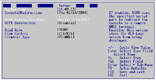

The RJ-45 serial COM2 port on the Sun Fire V60x and Sun Fire V65x servers rear panel (see FIGURE 4-12) can be used to direct boot messages to a serial console (for example, a laptop running HyperTerminal).
The server is initially configured to send all the initial BIOS and kernel bootup messages to both the serial console and the VGA port. Use the information in this section only if you need to restore or change the configuration.
The default communications settings for serial COM2 port on the rear panel of the server are:
You can connect to the serial COM2 port if you have an adapter cable that has an
RJ-45 connector at one end and a DB9 connector at the other, wired in accordance with See Back Serial COM2 Port Adapter Pinout. You can then connect the COM1 port of a PC or laptop to the serial COM2 port using the adapter cable and use HyperTerminal (or a similar application) to communicate with the server.
An ANSI 500 terminal emulator is needed to have the display appear properly during BIOS setup and when using the Sun Fire V60x and Sun Fire V65x servers Diagnostics CD or Service Partition tools.
To set up the server to direct messages to an external serial console:
1. On bootup, press F2 to select BIOS setup
2. Select the Security menu on the BIOS Setup Utility window
4. Select the options as shown in FIGURE 4-13.
5. Press Esc to go back to the main BIOS setup menu.
6. Exit the BIOS setup utility saving the changes you have made.
The boot messages are now directed to your external serial console. In this example, the BIOS setup allows the messages to be directed to COM1 of an external PC running HyperTerminal.

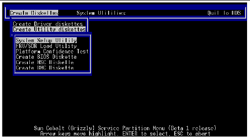

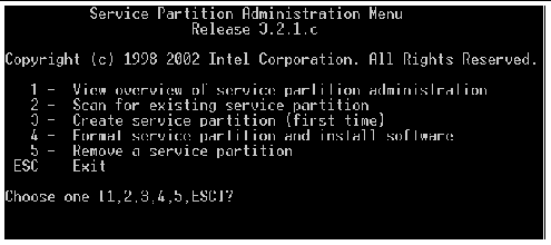

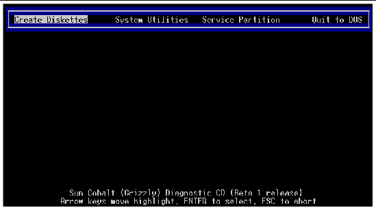

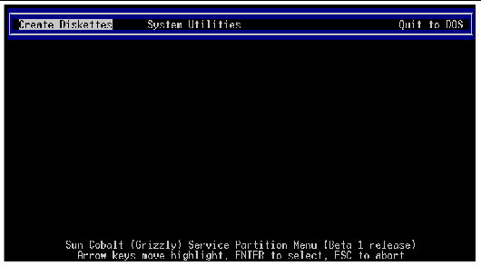

If the Service Partition is installed, when you press F4 at the initial bootup screen, the Service Partition Menu appears (see FIGURE 4-14).
There are three main menu items across the top of this screen:
Pressing Enter with the Create Diskettes menu item highlighted brings up a submenu that lists the various diskettes you can create (see FIGURE 4-15).
You can use this submenu to create various types of standalone diskettes that you can use to boot servers and run particular tests, utilities, or Flash the BIOS, independently of using the service partition System Utilities menu.
The following disks can be created:

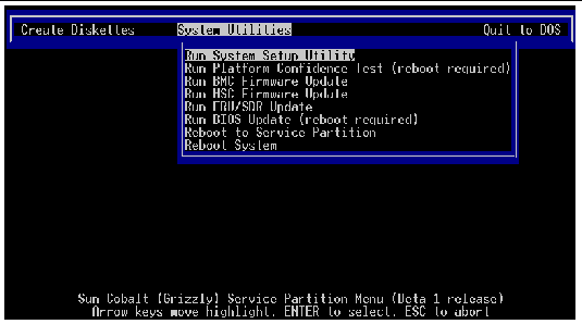

Pressing Enter with the System Utilities menu item highlighted brings up the submenu shown in FIGURE 4-16.
The following submenu items are available:

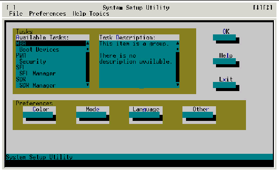

If installed, the Service Partition on the hard disk of the Sun Fire V60x and Sun Fire V65x servers allows you to perform server management, configuration and validation testing. To bring up the service partition, reboot and press the <F4> function key when the first BIOS screen appears.
Select Run System Setup Utility to run system setup. The System Setup Utility main window appears (see FIGURE 4-17).
The System Setup Utility (SSU) allows you to configure the following:
Because the server supports running the SSU over a serial console, all of the menus work in text mode only.

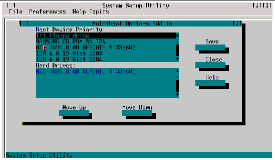

The Multiboot Add-in (MBA) feature of the SSU allows you to select the boot order for all bootable peripheral devices. To select the boot device priority, double-click the MBA Boot Devices menu item in the Available Tasks pane of the SSU main window. The Multiboot Options Add-in window appears (see FIGURE 4-18).
To change boot priorities, select a boot device and use the Move Down and Move Up buttons to move the device boot priority.
Note - This menu allows you to change the boot order without going into the BIOS setup. |

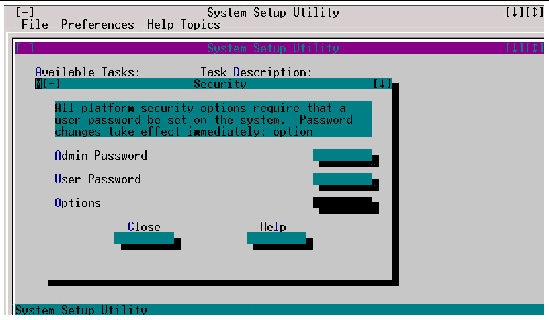

The Password Authorization feature of the SSU allow you to set BIOS passwords and other security options. To configure server security, double-click the PWA Security menu item in the Available Tasks pane of the SSU main window. The main Security window appears (see FIGURE 4-19).
Note - This menu allows you to change the security settings without going into the BIOS setup. |
Use the Admin Password, User Password, and Options buttons to configure the security options.
The System Setup Utility (SSU) allows you to manage the following:

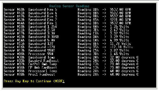

The Sensor Data Record (SDR) Manager allows you to view the current sensor data for the system, save the SDR data to a file, and view SDR information previously saved to a file. The SDR data is saved in standard SDR format. To manage the SDR data, double-click the SDR Manager menu item on the Available Tasks pane of the main SSU window. The SDR Manager main window appears, and you can use the menu bar at the top of the window to manage SDR data.

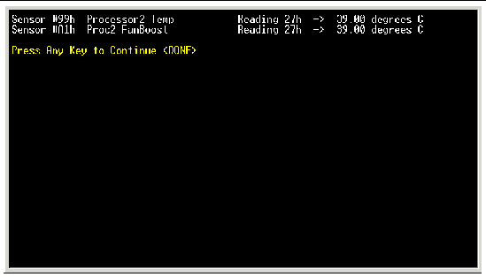

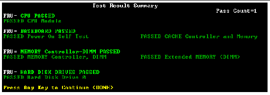

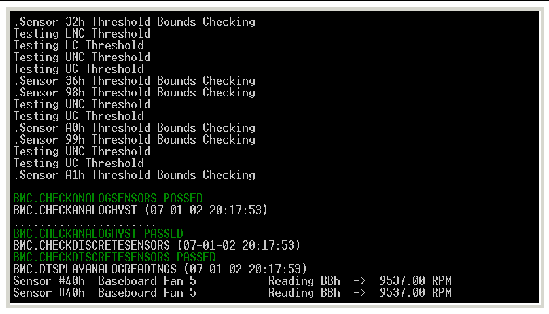

The PCT is used to test major subsystems and analog sensors of the system board. To run this test:
1. Select Run Platform Confidence Test (reboot required) on the System Utilities submenu.
The prompt shown in FIGURE 4-20 is displayed:

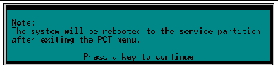

Note - After the PCT is finished, you can view the results of the tests. However, the system will be rebooted to the service partition after you finish PCT. |

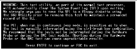

2. Press any key to bring up the warning screen shown in FIGURE 4-21.
Note that is it advisable to save the System Event Log to a floppy before running the PCT and that it is recommended that testing not be interrupted during the hardware probe or during the BMC test.
3. Press Enter to continue or Esc to exit.
If you press Enter, the screen shown in FIGURE 4-22 appears.

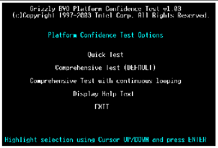

You can use this menu to perform the following tests:
All test results are saved in the RESULT.LOG file of the current directory, which is normally C:\PCT. This file is overwritten for each test.
This test performs a quick test of the CPU(s), DIMM memory, CPU cache memory, and hard disk drives. It is not a complete test of these units.
Quick Test takes from 2 to 5 minutes, depending on the amount of DIMM memory installed. The following test modules are run during Quick Test:
To run the Quick Test, follow this procedure:
1. Select Quick Test using the arrow keys and press Enter.

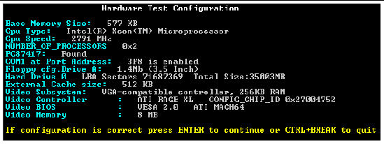

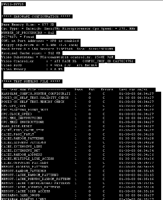

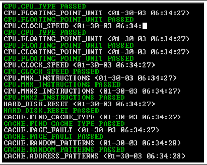

The initial testing produces a screen similar to the one shown in FIGURE 4-23. This phase of the testing determines your server configuration.
More screen entries appear as the test progresses. Eventually the screen shown in FIGURE 4-24 appears.
This screen indicates the hardware configuration that has been determined from the initial tests.
2. If the hardware configuration does not match the configuration of your server, press the Ctrl and Break keys simultaneously (Ctrl + Break).
You are prompted to check all the cables and your server configuration, then you are exited to the Platform Confidence Test main menu.
3. If the configuration is correct, press Enter to continue.
Several entries are displayed and scroll past on the screen, showing the test progress (see FIGURE 4-25).
When the testing is done, the results are summarized (see FIGURE 4-26).
4. Press any key to see the analog sensor readings (see FIGURE 4-27).
5. Press any key to see the remaining sensor readings (see FIGURE 4-28).
6. Press any key to return to the main Platform Confidence Test menu.

This test fully exercises and tests the server system. The test takes approximately 15 to 20 minutes to execute, depending on the amount of memory installed. The following test modules are run during the Comprehensive Test:
To run the Comprehensive Test, follow this procedure:
1. Select Comprehensive Test using the arrow keys and press Enter.
The initial testing determines your server configuration, and produces screens similar to those shown in FIGURE 4-30 and FIGURE 4-31.
2. When you are prompted about the configuration of the server, if the hardware configuration does not match the configuration of your server, press the Ctrl and Break keys simultaneously (Ctrl+Break).
The lines that are displayed and scroll past on the screen show the test progress (see FIGURE 4-30). The information is much more detailed than that displayed for the Quick Test.
When the testing is done, the results are summarized (see FIGURE 4-31).
4. Press any key to see the remaining test results.
5. After the remaining test results are displayed, press any key to see the analog sensor readings (similar to the screens shown in FIGURE 4-27 and FIGURE 4-28).
6. After the analog sensor readings are displayed, press any key to return to the main Platform Confidence Test menu.
7. You can view the RESULT.LOG file in a similar fashion to that previously explained.

Use this menu selection to update the Baseboard Management Controller (BMC) firmware. The BMC code resides both on the Sun Fire V60x and Sun Fire V65x servers Diagnostics CD and on the Service Partition in the C: /BMC directory. The BMC firmware can also be updated from a standalone, bootable floppy diskette
Use this menu selection to update the hard disk controller firmware. The hot-swap controller (HSC) code resides both on the Sun Fire V60x and Sun Fire V65x servers Diagnostics CD and on the Service Partition in the C: /HSC directory. The HSC firmware can also be updated from a standalone, bootable floppy diskette.
Use this menu item to re-inventory the FRUs and Sensor Data Records (SDR) on the Sun Fire V60x and Sun Fire V65x servers. The FRU/SDR code resides both on the Sun Fire V60x and Sun Fire V65x servers Diagnostics CD and on the Service Partition in the C: /FRUSDR directory.
Typically, the product and chassis serial numbers are changed only by field service personnel when hardware is changed. The asset tag number is intended for use by customers for their internal tracking system. For example, the asset tag might be updated after a firmware or software update.
Use this menu item to update the BIOS Boot block in the event that the boot block becomes corrupted. Use this menu item to also update the BIOS in the event that the BIOS becomes corrupted or if you want to set the BIOS settings back to their defaults. A reboot occurs automatically after the update is complete. The BIOS code resides both on the Sun Fire V60x and Sun Fire V65x servers Diagnostics CD and on the Service Partition in the C: /BIOS directory. The BIOS can also be updated from a standalone, bootable floppy diskette See Updating the Server Configuration for information on how to update the BIOS.
Selecting this menu item causes a reboot to the service partition.
Choosing this menu item causes a reboot, maintaining normal boot device ordering.
The Sun Fire V60x and Sun Fire V65x servers Diagnostics CD provides basic server configuration software through a text-based menu program that runs when the server boots from the CD. After bootup, the CD runs a menu program that allows the user to create driver diskettes, run utilities, update system components, and install and manage service partitions. The CD ships with all Sun Fire V60x and Sun Fire V65x servers and can used by Sun service personnel as well as end customers.
To begin using the diagnostics CD, follow these steps:
1. Reboot the Sun Fire V60x and Sun Fire V65x servers with the diagnostics CD inserted in the CD tray.
Note - You will need to make sure that the boot sequence is such that the diagnostics CD is selected as a boot device before the hard disk. This is normally the case by default. Refer to BIOS Setup Utility <F2> for more information on how to change the boot sequence. |
After bootup, verify that a DOS-like menu appears similar to that of the Service Partition menu (see Service Partition Menu), except that there is one more item at the top of the screen for managing the service partition, as shown in FIGURE 4-32. This menu works in both local and remote (console redirection) modes, and allows you to create driver and utilities diskettes, run system utilities, and create, format, or remove a service partition.
With the diagnostics CD menu, you can perform the operations listed in following sections.
For more information on creating diskettes, see Create Diskettes.
For more information on running system utilities, see System Utilities.

1. Boot from the diagnostics CD.
After the server has booted, the screen shown in FIGURE 4-33 appears.
2. Select Service Partition > Run Service Partition Administrator.
The Service Partition Administration Menu shown in FIGURE 4-34 appears.
3. Select option 4 to reformat the partition.
The partition will be reformatted and the diagnostic software will be loaded on the partition.

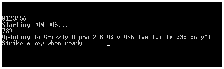

1. Insert the BIOS update diskette into the server and reboot.
The prompt shown in FIGURE 4-35 appears
A window appears (see FIGURE 4-36) indicating that the BIOS update is in progress. The floppy disk activity light is illuminated during the update as the BIOS image is copied to the server's flash memory.
Caution - Do not attempt to reboot or power down the server while the BIOS is being updated. You may get unpredictable results. |
When the first update pass is finished, the screen shown in FIGURE 4-37 appears.
The next screen appears as the BIOS update continues
After the update is complete, the CMOS is cleared and the server reboots.

6. Press "F2" to enter BIOS setup
7. When you reach the BIOS setup screen, press F10 to save and exit.
