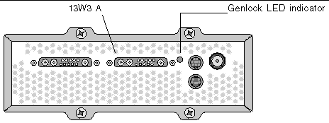

1. Locate the Sun XVR-4000 graphics accelerator I/O back panel on the rear of your Sun Fire V880z server and the 13W3 connector you will use as genlock master (FIGURE 8-1).
You may use either the 13W3A or 13W3B connector for genlocking slave graphics boards. Use one for the master display device (for example, projector or monitor) and the other for genlocking slave display devices.
 FIGURE 8-1 Sun XVR-4000 Graphics Accelerator 13W3 and Genlock Connectors
Figure showing the Sun XVR-4000 graphics accelerator back panel I/O ports and genlock LED location.[ D ]

Genlock LED Indicator
The genlock LED indicator is located between the 13W3A and stereo connectors. The LED illuminates when the genlock input is present and matches the expected horizontal rate.
 FIGURE 8-3 Sun XVR-4000 Graphics Accelerator Genlock LED
Figure showing Sun XVR-4000 graphics accelerator genlock LED indicator.
