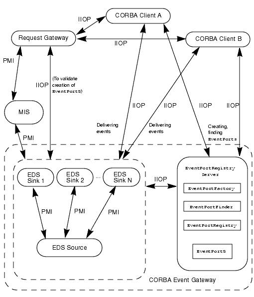

The SEM CORBA Event Gateway (EGW) is a conceptual entity comprising more than one UNIX process. The SEM CORBA Gateway consists of interfaces for registering a CORBA EventChannel, and an event distribution mechanism or CORBA-enabled Event Distribution Server (EDS) sink. The mechanism for subscribing to and unsubscribing from events is provided by the RGW.
The main component of the EGW subsystem is the CORBA-enabled EDS sink. This is similar to other EDS sinks except that the events distributed by the sink are CORBA events. It is possible for multiple instances of CORBA-enabled EDS sinks to be running on a single system, thereby allowing different CORBA clients to receive their events from different CORBA-enabled EDS sinks. However, CORBA clients are not aware of this multitude of CORBA-enabled EDS sinks nor do they need to know about it. Transparency is the outcome of this approach.
Note Henceforth, the term EGW and CORBA-enabled EDS sinks will be used interchangeably, unless there is a need to differentiate them.

EventPortFactory and EventPortFinder CORBA objects are singleton objects for the entire system (in this case, one instance of Solstice EM). CORBA client applications receive their event notifications through EventPort objects, one of which is typically created for each CORBA client application.
EventPort objects are dynamically created based on the AE_Title in the criteria. The Event Port Registry (EPR) sets up a connection with the CosEventChannelAdmin::SupplierAdmin object (a part of the Event Services that is supplied by the Object Request Broker (ORB) vendor, or any other vendor) associated with the EventPort object that has the appropriate title.
FIGURE 4-1 The CORBA Event Gateway and Its Interfaces4.1 Enabling Inter-Process Communication Between EDS Sinks and CORBA Clients
The EventPortFactory and EventPortFinder server objects are implemented in a separate stand-alone server. This server is a dæmon UNIX process and is called an EventPortRegistry object. This process also implements EventPortRegistry objects that provide inter-process communication between EDS sinks and CORBA clients.
On start up, the em_vb_corba_epr server process ((for VisiBroker) creates the EventPortRegistry CORBA object which is registered with the CORBA Naming Service. The server then proceeds to create an EventPortFinder, and finally, creates an EventPortFactory.
