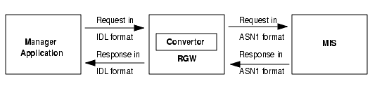

The following figure shows the encoding/decoding done by the CORBA Request Gateway (RGW).
FIGURE 5-1 Encoding/Decoding Done by RGW![]()
