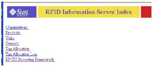

When the Information Server installation has been successfully completed you should be able to confirm it with presentation of the EPCIS Index page in your browser window.
procedure icon  To Verify Information Server Installation
1. Navigate to the RFID Information Server URL:
2. Login as the admin user at the login screen.
3. Click OK to be presented with the Administrative Console screen.
4. Click on Apply Changes and then Restart the configuration.
5. Navigate to the URL
http://hostname/epcis/index.html
Where hostname specifies your application server's location. You should now see a page showing the RFID Information Server Index page similar to the one shown here.
Screen capture of the Sun RFID Information Server Index page.[ D ]
