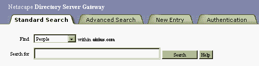

Default Gateway (dsgw.conf)
In addition to the standard search form, the default Gateway provides an advanced search form, a Directory Server authentication form, and a form for adding and modifying entries.
The configuration file for the default gateway is at <NSHOME>/dsgw/context/dsgw.conf.
During Netscape Directory Server 4.0 installation, the default gateway is configured to use as its HTTP server the Netscape Administration server installed with the directory. Following Directory Server installation, the default gateway can be accessed from http://adminhost:adminport/ or directly using this URL:
http://adminhost:adminport/dsgw/bin/search?context=dsgw
Figure 1.1 Default Gateway

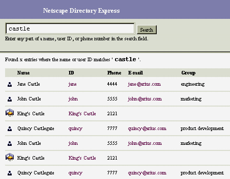

Directory Express (pb.conf)
Directory Express is designed for use out of the box as a corporate phonebook. The configuration file for Directory Express is <NSHOME>/dsgw/context/pb.conf.
During Netscape Directory Server 4.0 installation, Directory Express is configured to use as its HTTP server the Netscape Administration server installed with the directory.
Following Directory Server installation, Directory Express can be accessed from http://adminhost:adminport/ or directly using this URL:
http://adminhost:adminport/dsgw/bin/lang?context=pb
Figure 1.2 Directory Express Search Result
Figure 1.3 Directory Express Extended Search Results
