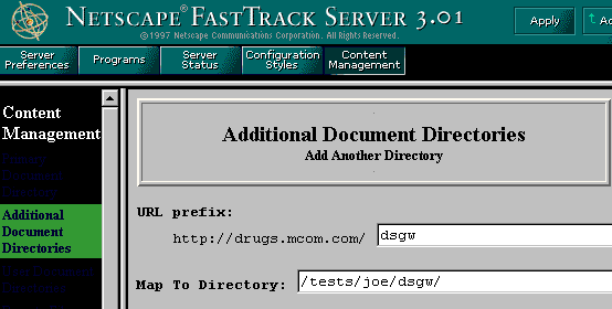

Figure 2.1 Configuring an Additional Document Directory

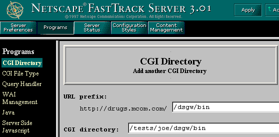

Figure 2.2 Configuring an Additional CGI Directory
Add an Additional Document Directory (4.0 Gateways)
Adding an additional document directory is necessary to establish access to the gateway files. From the server manager for the FastTrack or Enterprise Server:
  1. Go to Content Mgmt | Additional Document Directories.
  2. In the URL prefix field, enter
  3. dsgw
  4. In the Map to Directory field, enter
  5. <NSHOME>/dsgw/
    where <NSHOME> is the Directory Server's installation directory.
  6. Click OK, then Save and Apply.

Add an Additional CGI Directory (for 4.0 gateways)
Adding an additional CGI directory is necessary to make the gateway's CGI programs available. From the server manager for the HTTP server:
  1. Go to Programs | CGI Directory.
  3. /dsgw/bin
  4. In the CGI directory field, enter:
  5. <NSHOME>/dsgw/bin

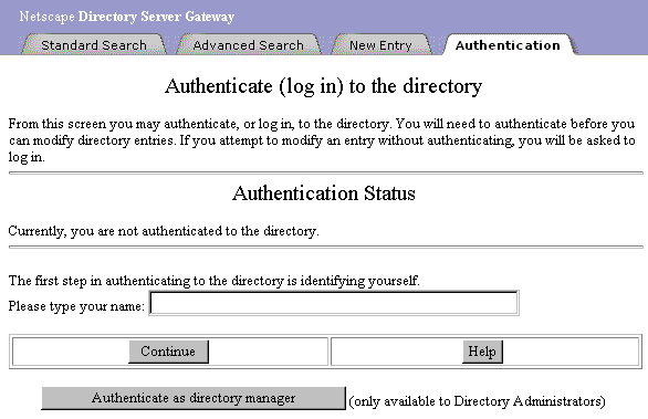

Authenticating as Directory Manager
Figure 2.3 shows the authentication login screen for the default gateway. Administrators can use it to authenticate as the Directory Manager. The Authenticate as Directory Manager button is displayed only when a Directory Manager has been configured for the gateway.
The authlifetime parameter, which defines the number of seconds that a user may remain authenticated, is described in "location" on page 85.
Figure 2.3 Authenticating as Directory Manager
