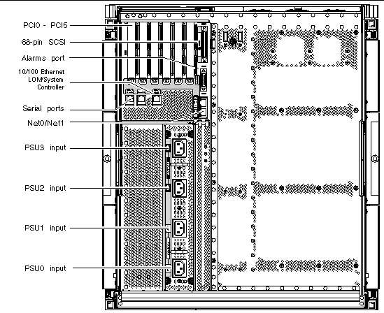

The following ports are on the rear of the system:
Their locations are shown in FIGURE 1-1.
The console serial port and 10/100 Ethernet port can be used to access the system controller.
Use the console serial port to connect directly to an ASCII terminal or an NTS (network terminal server). Connecting the System Controller board with a serial cable enables you to access the system controller command line interface with an ASCII terminal or an NTS.
Use the 10/100 Ethernet port to connect the SC to the network.

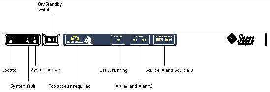

The system indicator board contains the On/Standby switch and indicator LEDs as shown in FIGURE 1-2.
The indicator LEDs function as shown in TABLE 1-2.
Locator[1] |
Lights when a fault occurs in a FRU, which can only be replaced from the top of the system |
